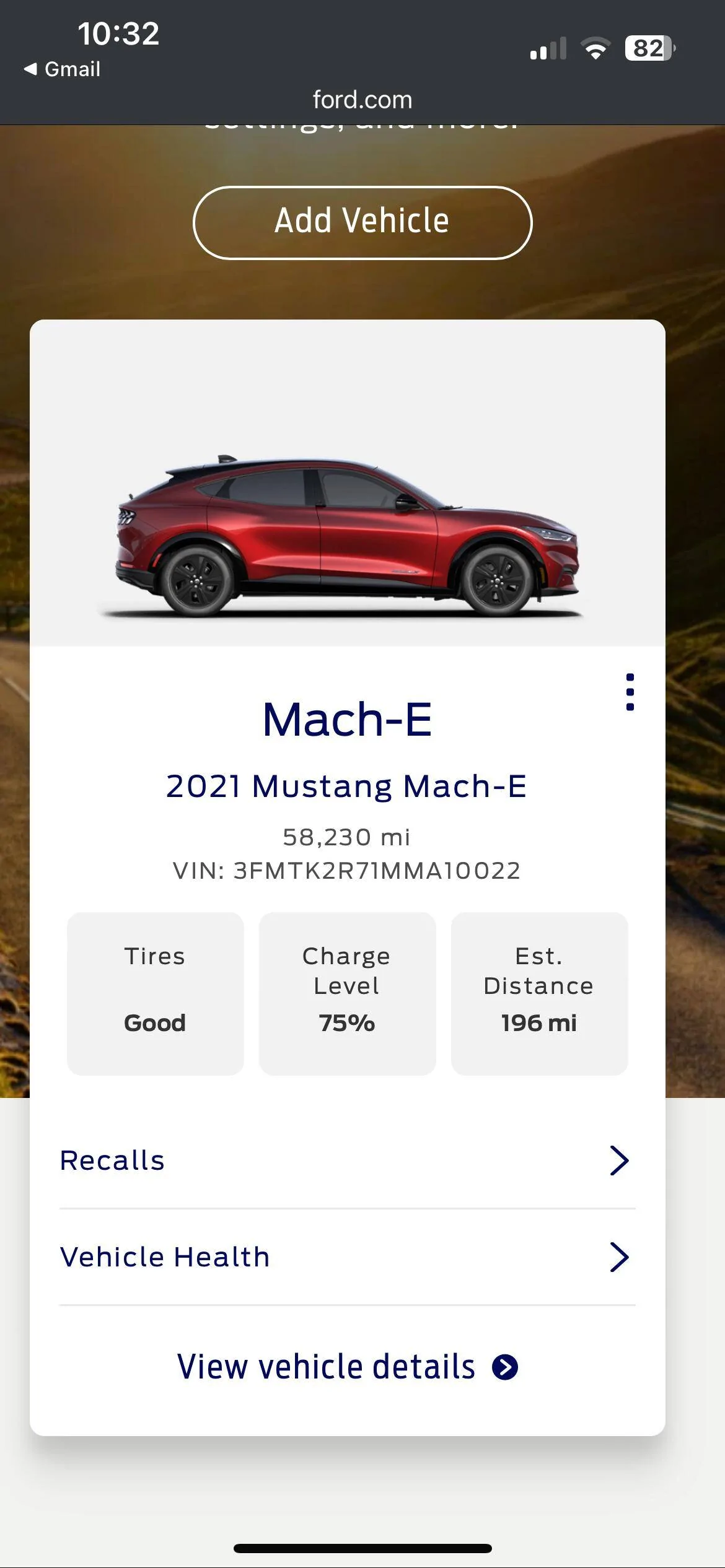

Where on the ford account page do you find the 12v battery level? Maybe I'm blind, but I can't find it.
My car is stuck trying to download 6.7, so I want to see if that's the culprit.

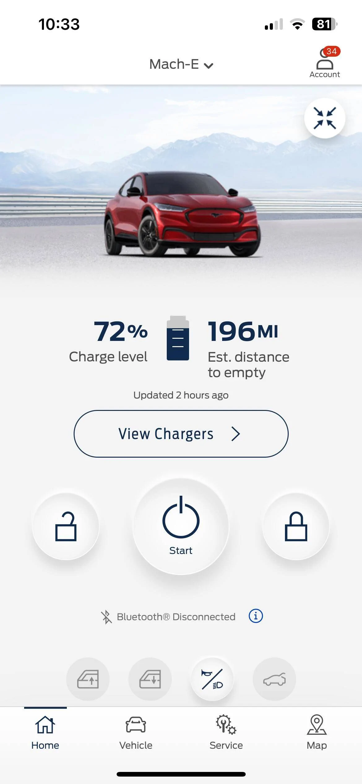

The Charge Level at https://www.ford.com/myaccount/account-dashboard is actually your 12v charge and not your high voltage charge. I *think* it’s a bug where some web dev pulled the wrong charge level for the UI but it seems to be the 12v charge. There are reports that this charge level isn’t there for some people.
My 12v battery is at 75% and my high voltage traction battery is at 72%
