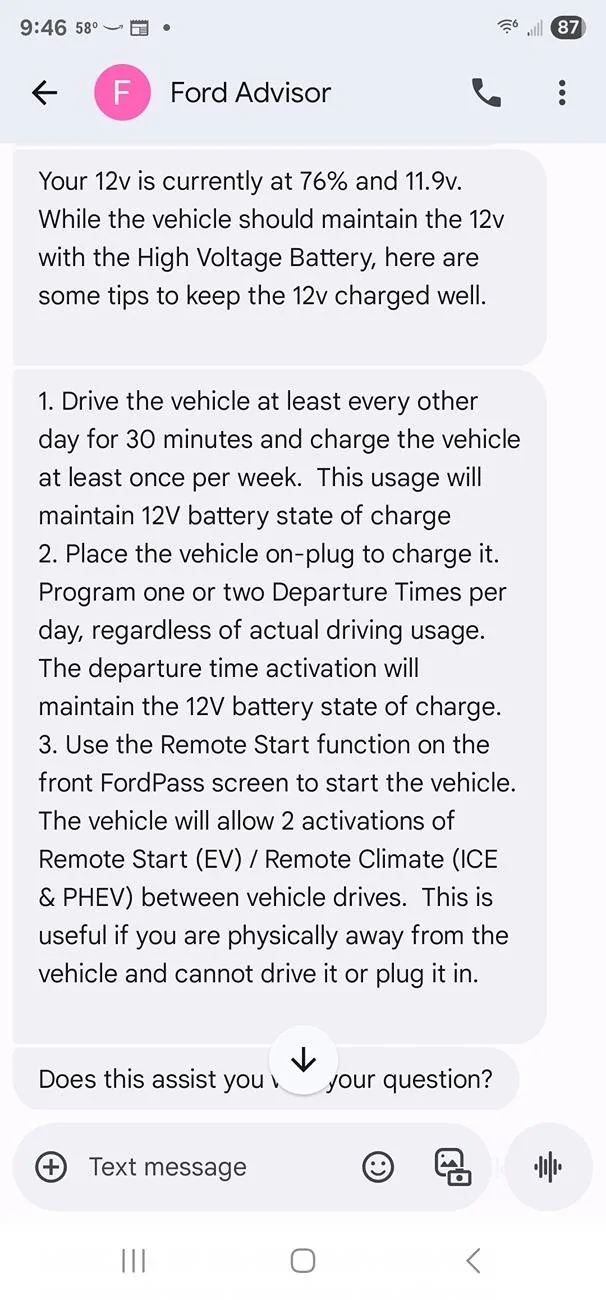

I wonder if you set a departure time and never depart, does the car eventually stop preconditioning for the scheduled departure? Maybe a dumb question.
Yes it does stop. The default setting is 15 minutes
