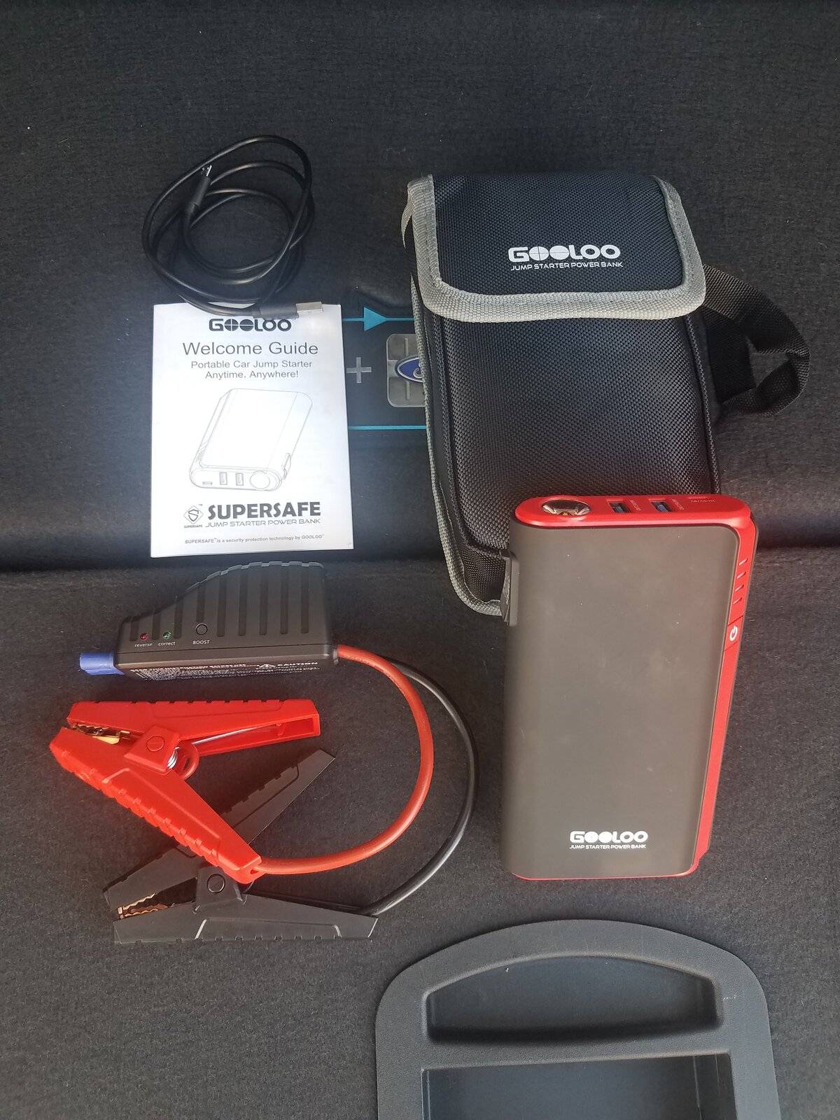

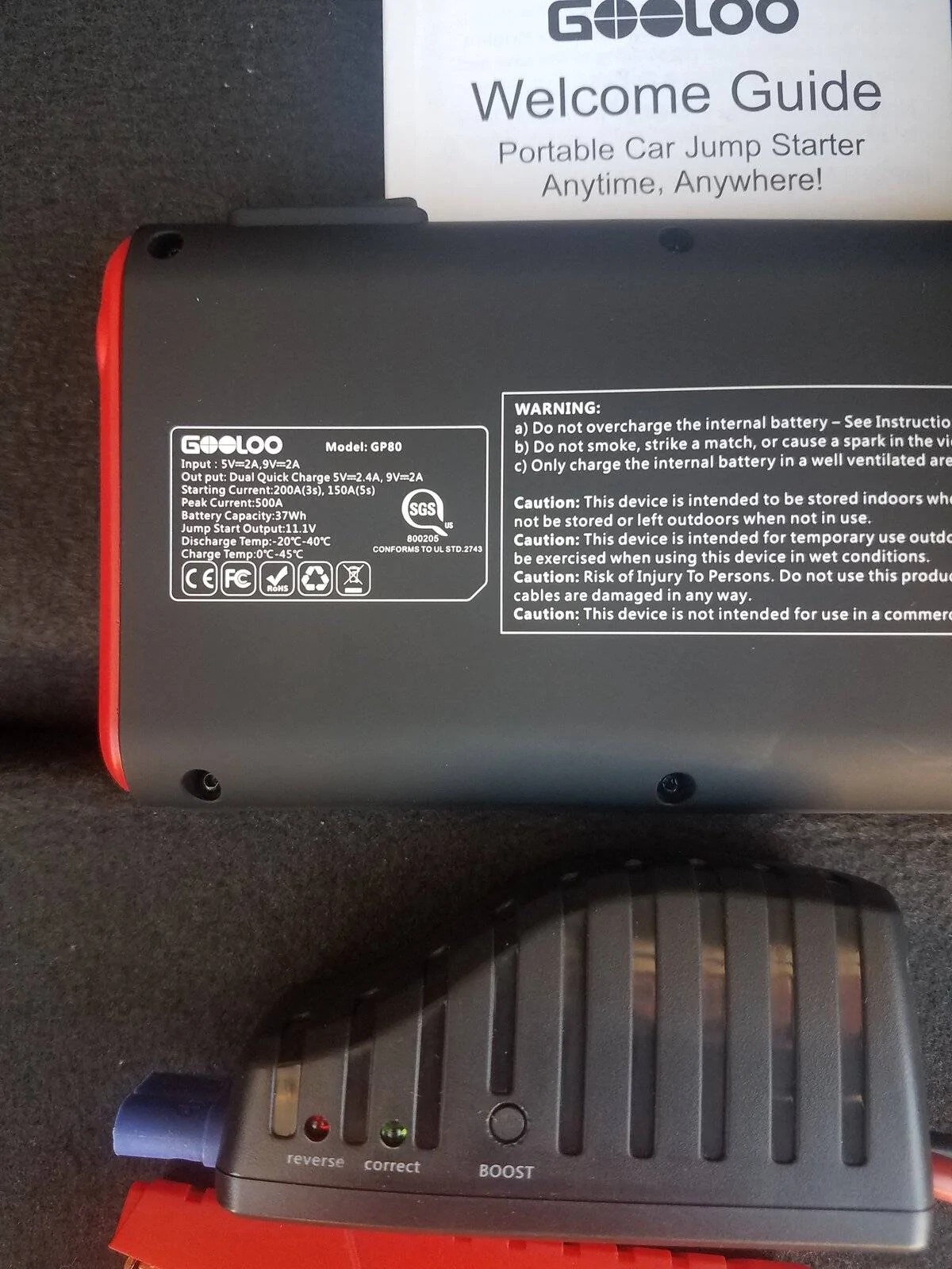

Old thread - reviving again - wondering if the forum members have any recommendations for a 12vbattery starter - preparing to buy one in case the MME 12v needs a charge.
I carry this one around with me. It started my brother's Focus Electric and my wife's C-Max Energi when their 12v batteries died.
Just have to make sure you press that little button on the side of the connector when jumping the dead battery.
