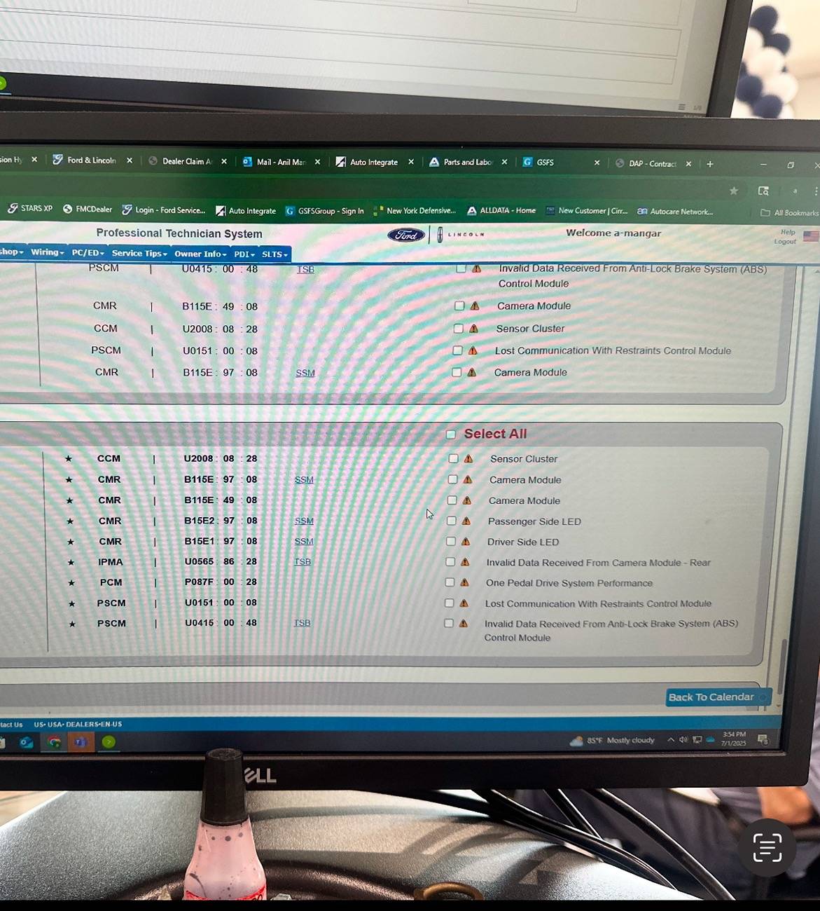

Yeah this is crazy! I am NOW being told that they want to charge me $440 plus tax because there are 2 modules that need to updated - which according to him was the reason why I got some of the error codes.
I asked him what the 2 modules are, and why all of a sudden this popped up when the car was FINE before swapping the 12volt. After the swapped, now we have these 2 problems? Like give me a break here. :mad:
- Update: He stated that these codes were there since 5/31/25 and because the system got reset with the new 12v, it now shows up.

sounds like it might be time to involve the ford BEV team. my understanding is that dealers don't have to do module updates free of charge and when the warranty is expired they can't charge anyone but you. not sure if the BEV team can help but this seems like a really bad customer service experience.
clearly there was nothing wrong with the car before they changed the battery, so this smells very scammy. seems unlikely that your problem is related to module software versions.
i'd ask them if they actually charged that battery up first and if they did the BMS reset in the first place.

Those are normal Mach-E codes that don’t need to be addressed. Just pay to have the 12V battery replaced and that’s it, no diagnostics or programming needed. You can reset the BMS yourself for free.
they apparently did replace the battery and then subsequently the car threw a bunch of codes/errors on the IPC. the supposition upthread is that they did not charge the 12V battery before putting it into the car; the battery had a label from 8/2024 IIRC.
so the question is is it OK to reset the BMS if the new 12V is not at 100% SOC? or should the battery be removed from the car, charged, and then replaced (and then reset the BMS?).

I would just charge the car for 3+ hours (which also charges the 12V) and reset the BMS. No need to remove the battery again. It should take care of itself after that.
Yes, the battery might have been low from sitting almost a year, and caused some codes initially after installation due to low voltage. They should have charged it up first. And the service manager is either an idiot or crook for trying to bill that much for a simple LB battery replacement.

It won’t initially try as hard if the SoC parameter is messed up (e.g. charging voltage may be lower), but it will eventually figure it out and get the battery to where it should be over the next several days of use. The most important thing is to ensure bare minimum the BMS is reset (at any SoC) when the battery is replaced, everything else will adapt.
