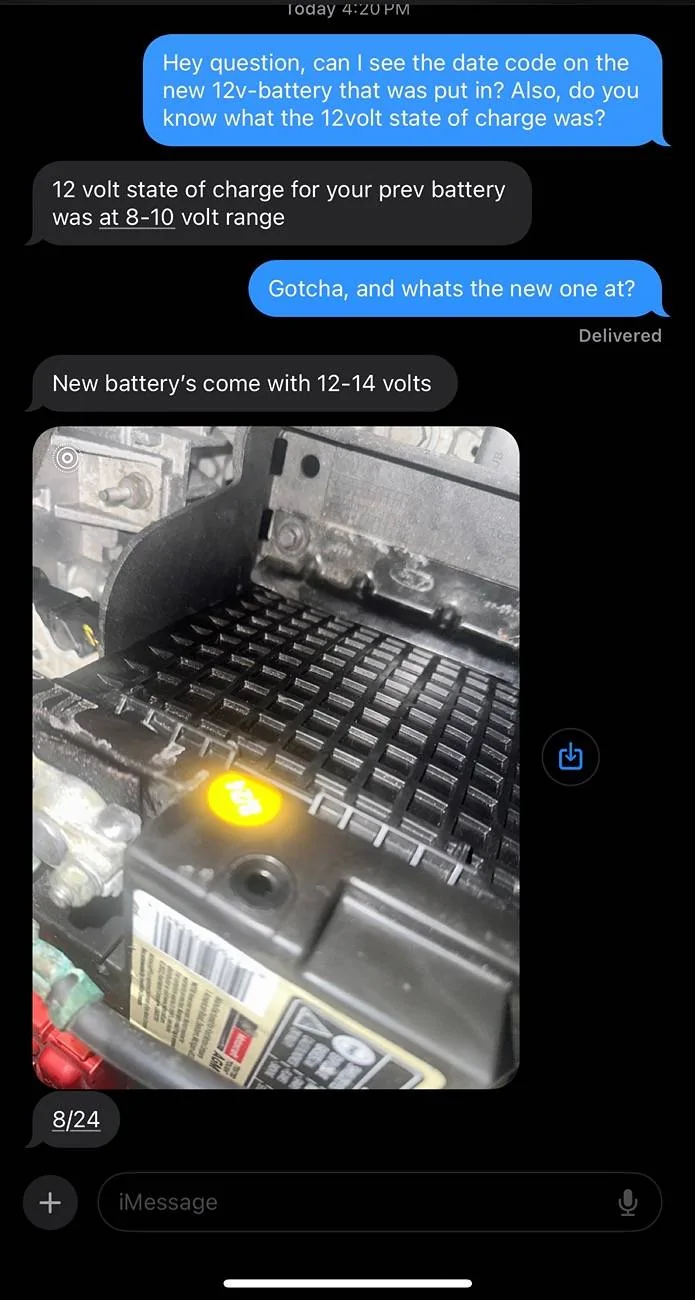

hmm the car will throw those kinds of errors when the 12v battery is low. It's conjecture but I'd wonder if they put in a "new" but discharged battery. Ask to see the date code on the battery they put in and ask to see what the car says the 12v battery state of charge is. Don't accept BS, they know how to answer those questions. The battery should be new within the last few months. the 12V State of Charge needs to be something higher than 50%... I'm betting it is low.
this is the response i got from him
Ford Mustang Mach-E 12V battery app notification - Questions IMG_5056

well.... the "new" battery is a ~year old and likely discharged... they need to put it on a charger to bring it up.

also make sure they did the BMS reset procedure after installing the new battery. i'm actually not sure what happens if you do the BMS reset on a new battery that hasn't been properly charged though. it's probably better if they make sure it's charged all the way up before doing the BMS reset.

They kept the car, so im hoping they do their job properly and know to do all these things before giving it to me again sometime this week. But who even knows anymore.
