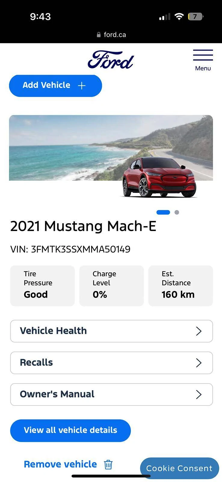

Dealer updated my IPMA/PSCM and I suppose didn’t use a power supply. Now my battery shows this.
Ford Mustang Mach-E 12V SOC % on Ford.com IMG_7381
11,365
25,026
They hooked up the power supply wrong during programming, park the vehicle for 8 hours undisturbed to allow the BMS to recalibrate the SoC.
Running, In Accessory mode, or Off?
