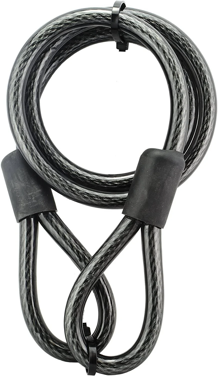

While I haven't needed to use it yet, I just got a few inexpensive long-neck locks and a heavy security cable to keep with my charger. The security cable can just be looped through a tire spoke (or around the tire footprint on the ground), then locked onto the charger cable.
I didn't really want to leave my frunk cracked open.

I also have cable and good padlock however I guess if someone is really determined they will nick what they want. I wouldn't tackle anyone having a go at my lock with an angle grinder! :)
