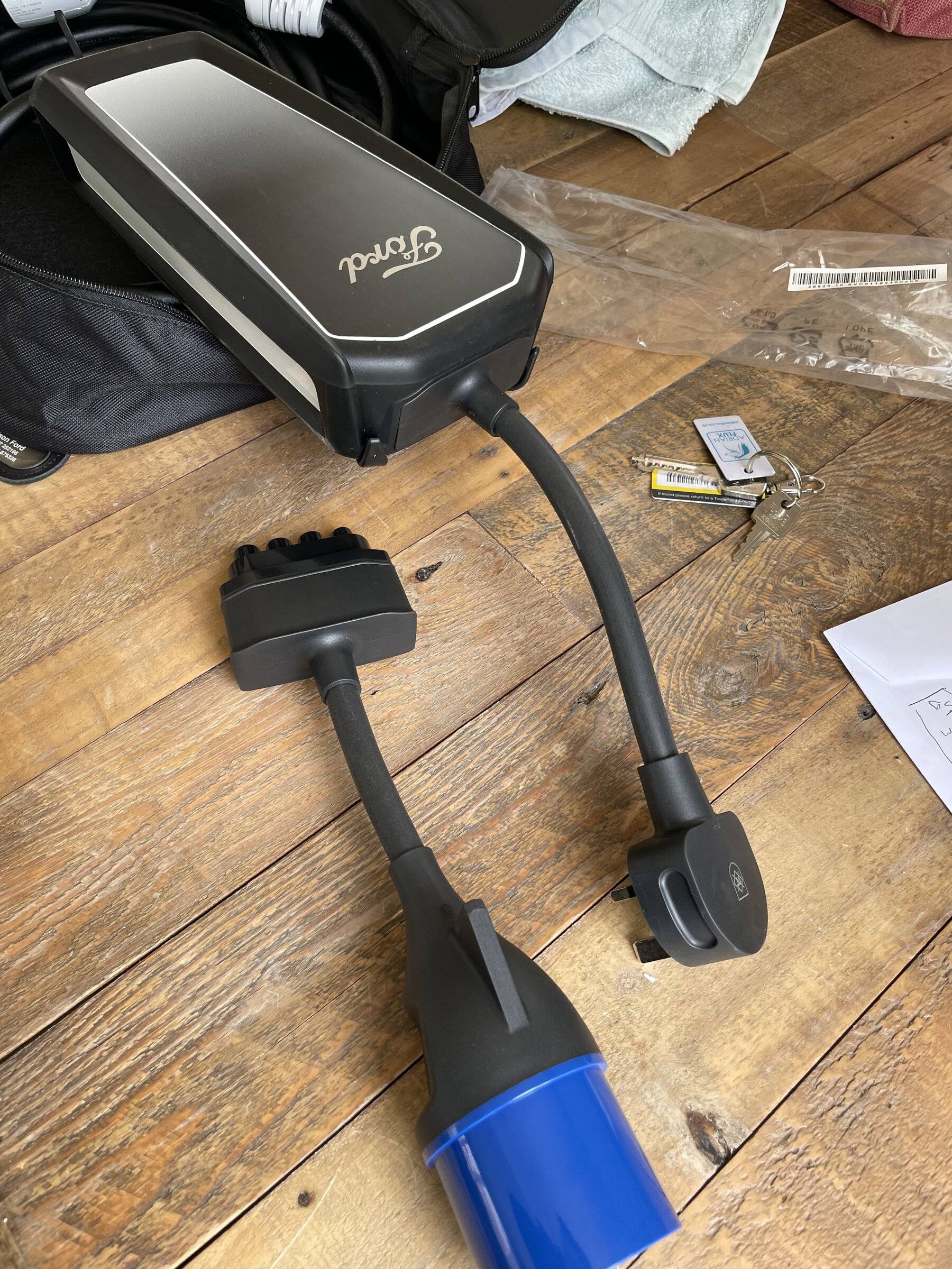

Hi timbop, a commando plug is the blue one in the pic. It’s a 32a plug which I’m guessing is the UK version of your NEMA 14-50. This is what is supplied by Ford in the UK

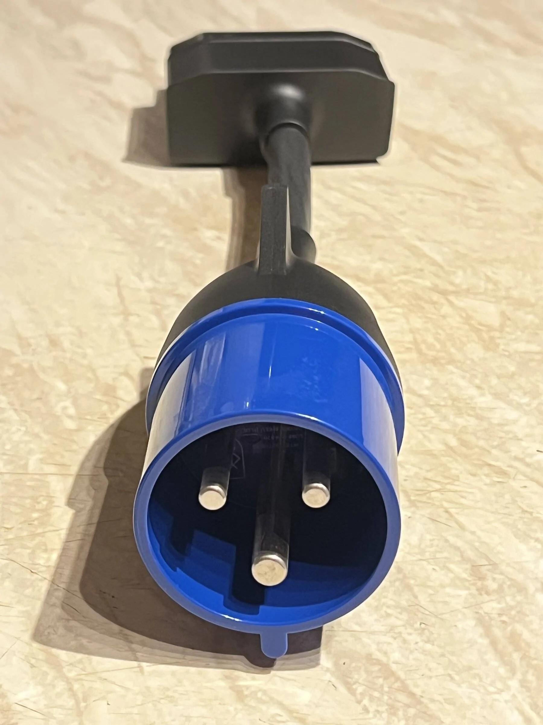

Hi all
So for the benefit of our American friends a UK 32amp Commando plug looks like this…
Ford Mustang Mach-E 32 amp socket UK B644DBA8-AC5D-4DCA-9EDC-ED911E5C21D3
It’s a pretty heavy duty piece of kit like most UK electrical plugs, and it’s mostly used for commercial and leisure applications such as electrical hookups for boats and motor homes. More recently it’s becoming more common due to home EV charging solutions.

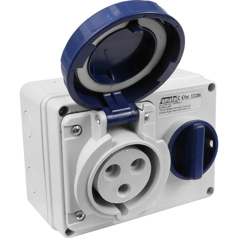

A typical commando socket looks like this…
Ford Mustang Mach-E 32 amp socket UK 5919348C-423B-4FC7-B45D-A5DBC659E9C0
…and can be wired from a domestic supply as long as it’s on its own circuit. The recommended size of the cabling, breakers, and RCD devices are dictated by a whole load of British Standards that all electricians have to adhere to. (Amendment 1 of BS 7671 - Jul 2020 being one of them)
The very quick answer to @Skier ‘s original question is a 40A MCB :) …but you should always consult with a qualified electrician who will determine if your existing consumer unit and household supply can cope with the additional load. You’ll want to check the rating of the grid supply fuse which is before your smart meter and see if it’s 60amp or 100amp, and ensure it’s not a shared/looped supply.
Hope that helps - and if you want a copy of the current UK regs give me a shout.
