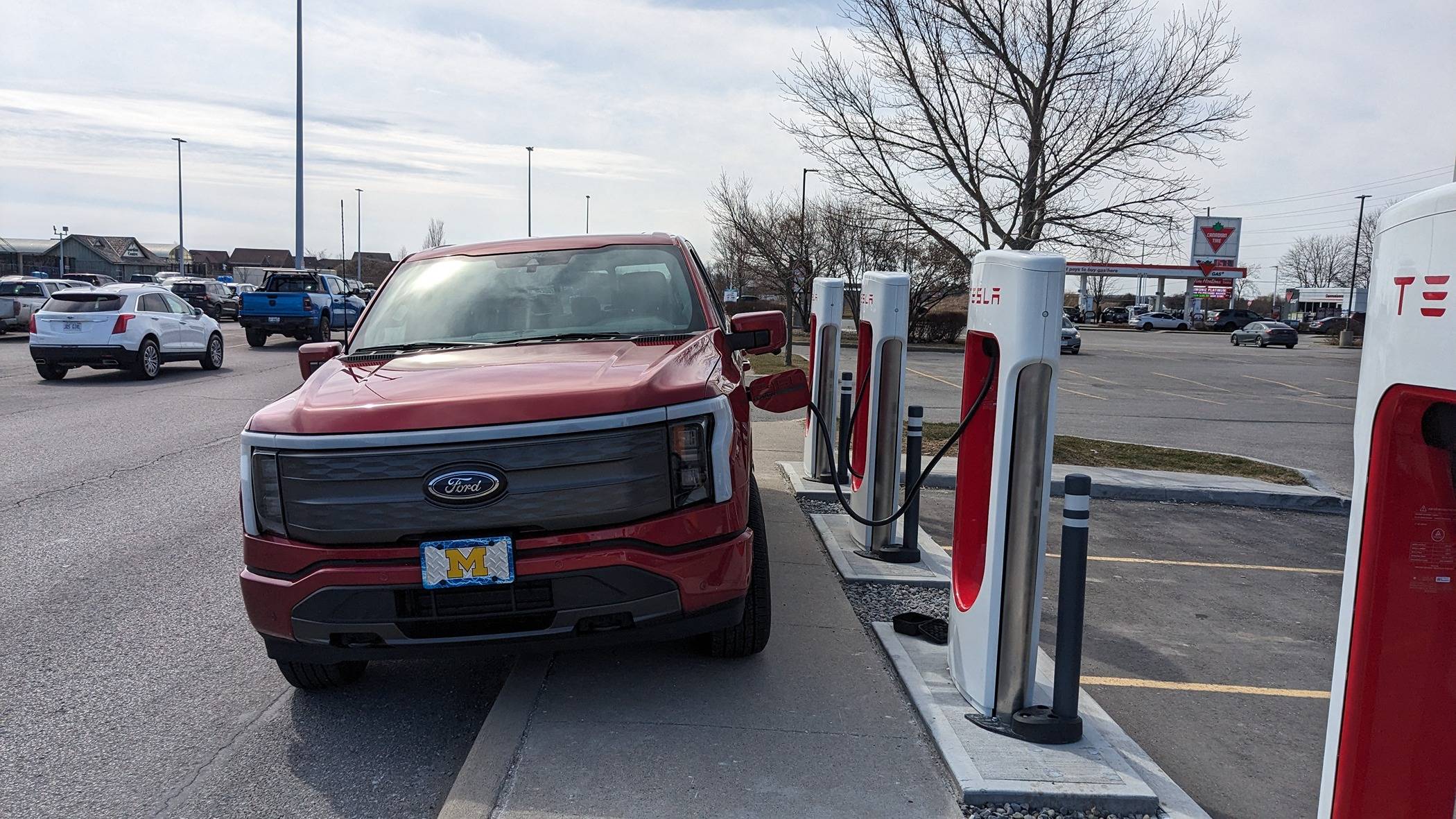

Speed of charging has to do with being at 65% SOC.
Way to be creative on the parking. I've done the same.
