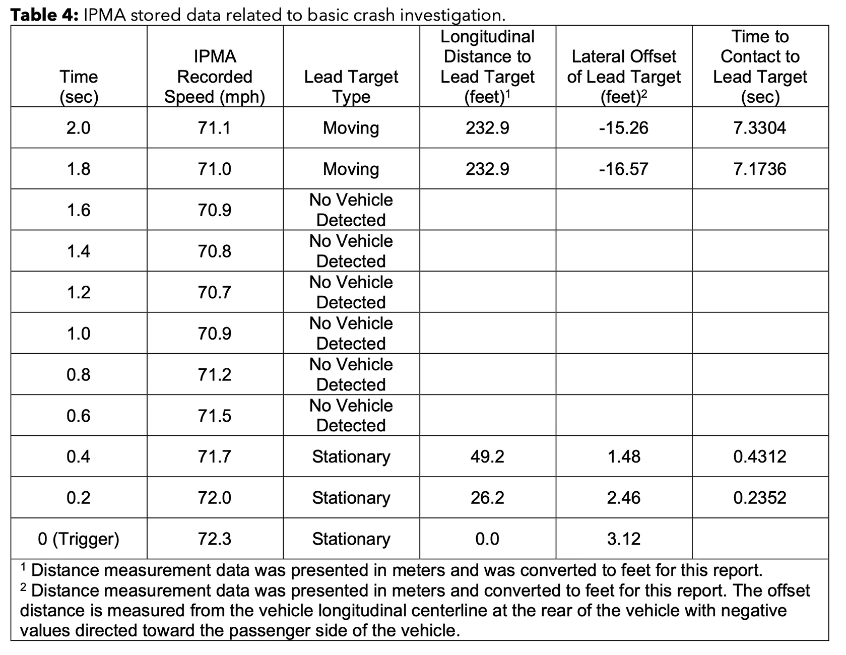

Reading the NTSB reports, there are some interesting tidbits.
Above 65 MPH, adaptive cruise control will not respond to stationary objects. This is to avoid phantom braking events.
In the Philadelphia crash, the Mach-E was following another lead vehicle at 71 MPH with hands-free BlueCruise engaged before encountering stopped vehicles. The lead vehicle (230' ahead) had to swerve to avoid the stopped cars (it lost control and crashed), this is reflected in the forward radar data retrieved from the Mach-E:
Ford Mustang Mach-E 2 Fatal MME BlueCruise Crashes / Distracted Drivers Screenshot 2026-03-13 at 7.10.16 AM
The Mach-E driver did not take over and hit the stopped vehicles. You can also see the radar detected the stopped car only about 50 feet or 0.4 seconds before collision. Not enough time to respond due to system limitations.

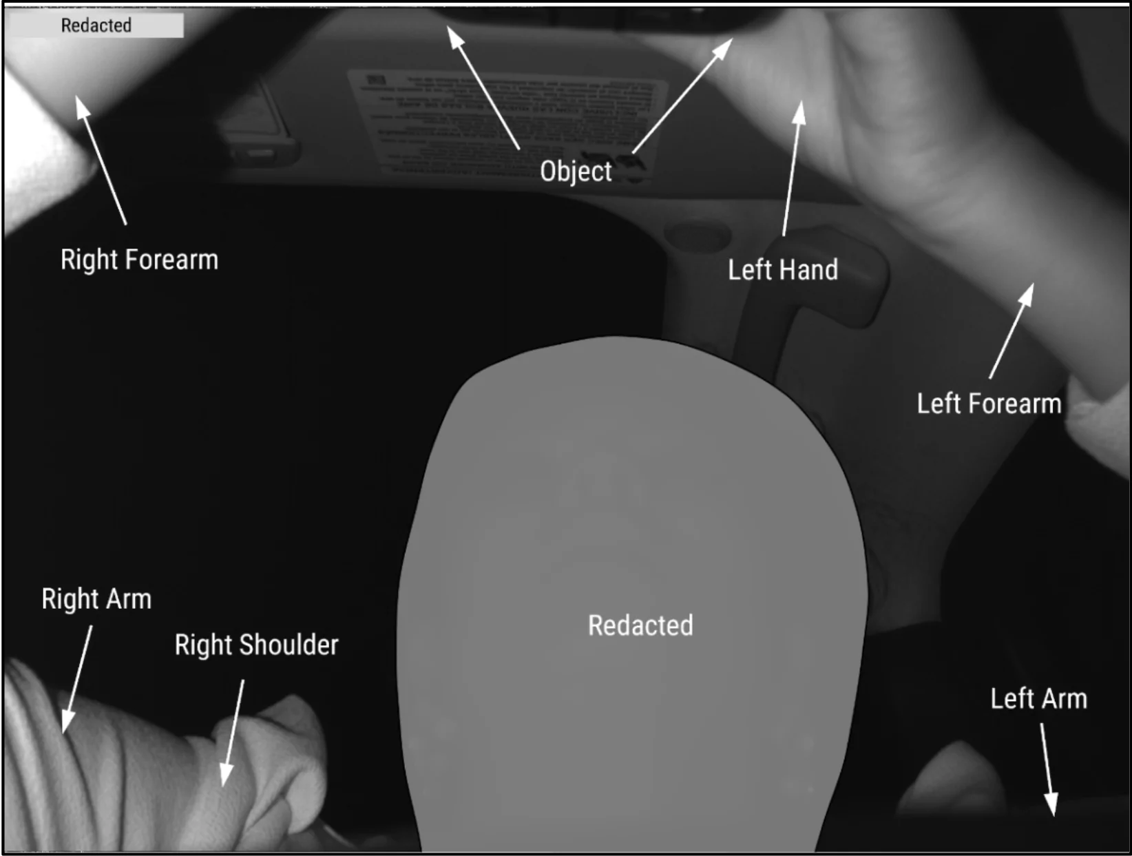

In the seconds before the crash, the driver monitoring camera recorded her eyes being on the road, but this image was retrieved showing she was holding and looking at her cell phone (object) right in front of the windshield to trick the system. Cell phone records also shows a call at the time, perhaps she was making a FaceTime call.
Ford Mustang Mach-E 2 Fatal MME BlueCruise Crashes / Distracted Drivers Screenshot 2026-03-13 at 7.11.23 AM
FYI these images had to be specially downloaded out of the monitoring camera by NTSB request (similar to reading a black box after an airplane crash), images do not leave the vehicle. I understand images are only saved in the device if there is a gaze warning or crash.

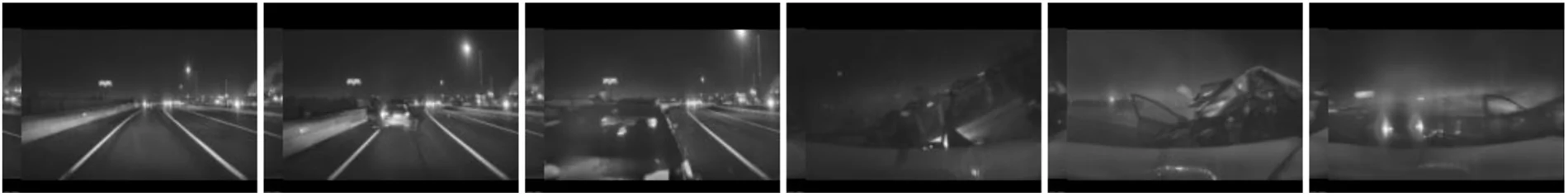

Low resolution forward camera images are also recored in the seconds leading up to the impact:
Ford Mustang Mach-E 2 Fatal MME BlueCruise Crashes / Distracted Drivers Screenshot 2026-03-13 at 7.21.50 AM
The 23-year-old driver in this case was impaired by alcohol and THC, and was charged with DUI.

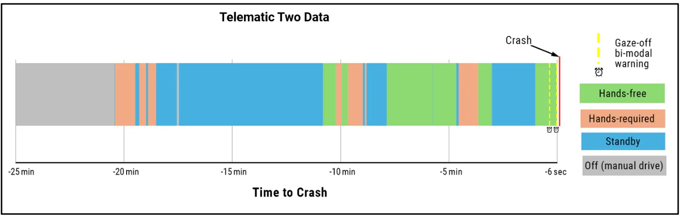

The second referenced San Antonio crash was similar, there was a car stopped in the middle of the road, hands-Free BlueCruise was engaged driving 75 MPH, but the driver didn't see the car in time to avoid a collision (and BlueCruise also did not brake).
The remote telematic data showed the vehicle was switching in and out of BlueCruise in the minutes before the crash. Perhaps due to curves and/or manual driving.
Ford Mustang Mach-E 2 Fatal MME BlueCruise Crashes / Distracted Drivers Screenshot 2026-03-13 at 7.44.34 AM
There were also several gaze warnings recorded before the crash, the recovered data showed the driver was looking back and forth between the infotainment screen and the road immediately before collision. This could be an action such as trying to select a charger or destination on the screen. Even though the driver was still glancing at the road, he did not detected the blacked out vehicle before impact (TBH, that sounds like a difficult scenario to see a car). The NTSB interviewed another driver in front of the Mach-E that did happen to see the stopped vehicle and changed lanes in time.
In summary, both of these cited crashes involved hitting a stopped vehicle in the middle of the freeway, at night going 70+ MPH while hands-free BlueCruise was engaged. There was an element of driver distraction in both cases. But BlueCruise has limitations and is not able to detect stationary vehicles at freeway speeds. That sort of detection will likely require LIDAR. A vehicle stopped in the middle of a freeway at night is a very dangerous situation, and my belief it was only a matter of time before someone will hit them. This is also an extremely difficult scenario for current generation ADAS to reliably mitigate.
