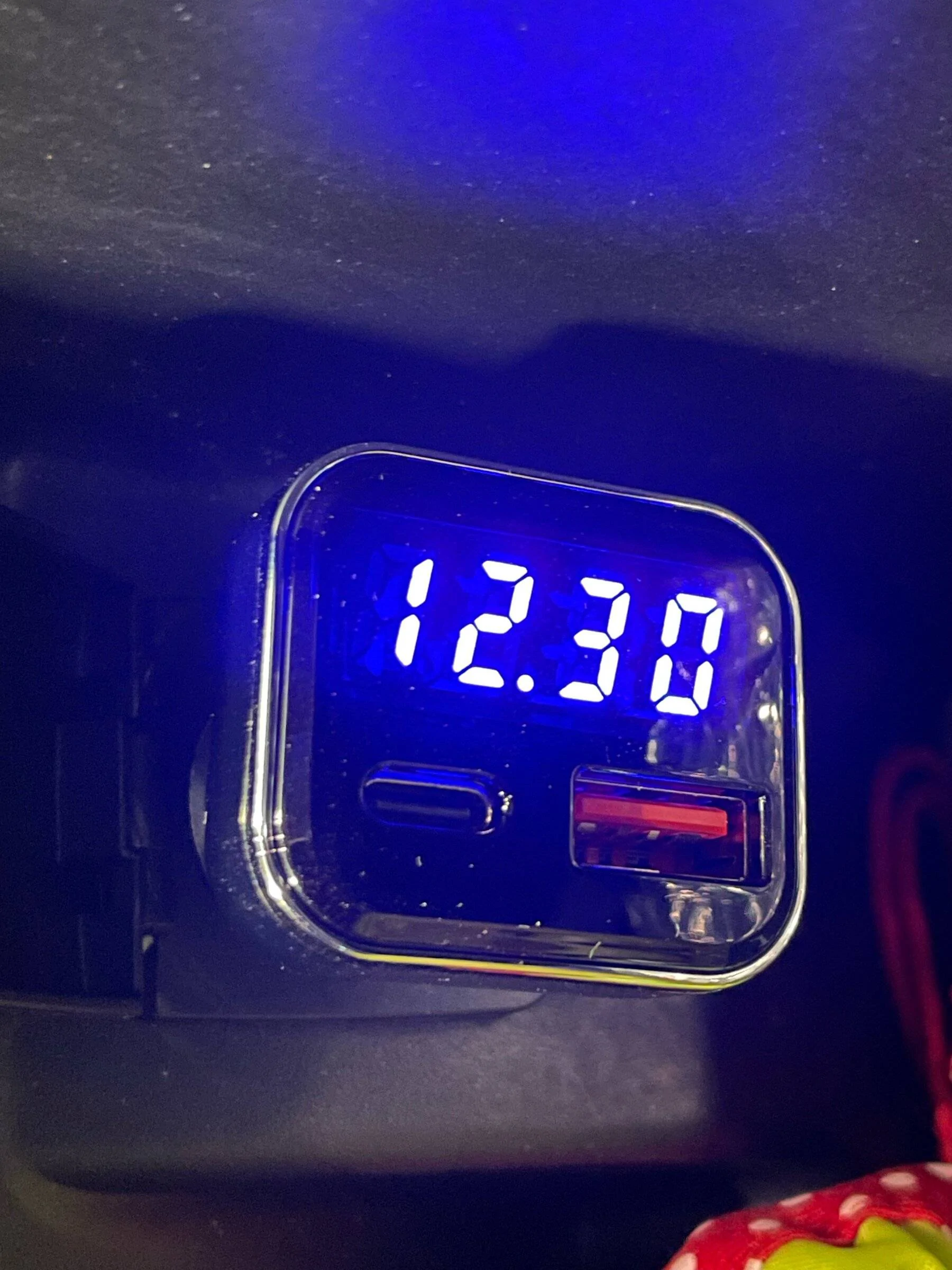

the UGLY: I am getting every day the dreaded Low Battery Voltage - Service Soon warnings !!! ... and now it is starting to flash on the vehicle display !!! I never ever had this warning since I got my car way back in May '21. Checked and double checked the AGM LVB - it is steady at 12.3v w/ vehicle OFF and 14.56v w/ vehicle ON.

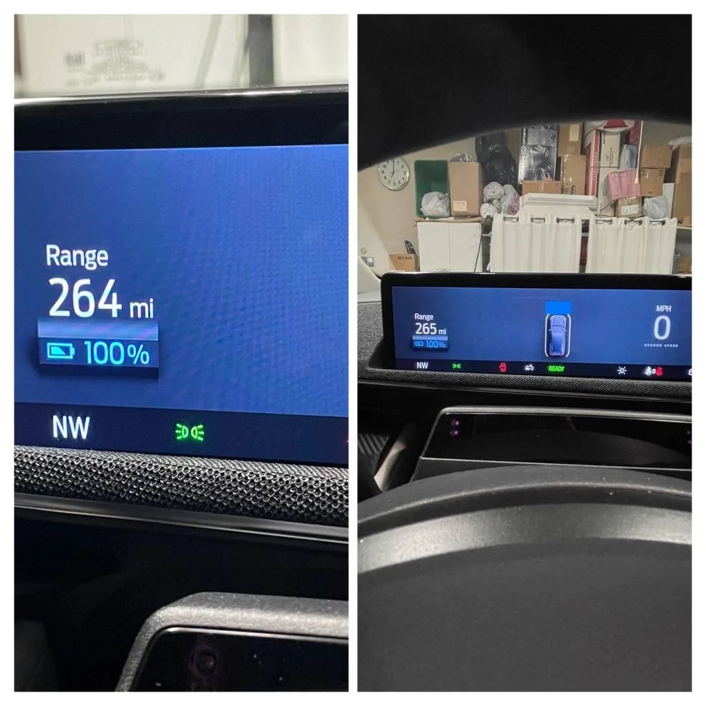

It is quite interesting what people are posting in reply to my experience ... all I am saying that after CSP 21P22 was performed, my range is now at least 260 miles @ 100% SOC and 229 miles @90% ... in other words, from my home in Windermere, FL I can make all the way to dcFast charger at EA in Brunswick GA a 230 miles run in one charge ... that to me is a dramatic range increase for my 68 kWH Job1 RWD mach-E, before hand I had to stop at EA at The Avenues @Jax !!! I also made a round trip from my house to Palm Bay via Melbourne in one charge! ... of course our temp here in FL is about 86ºF and flat roads.
