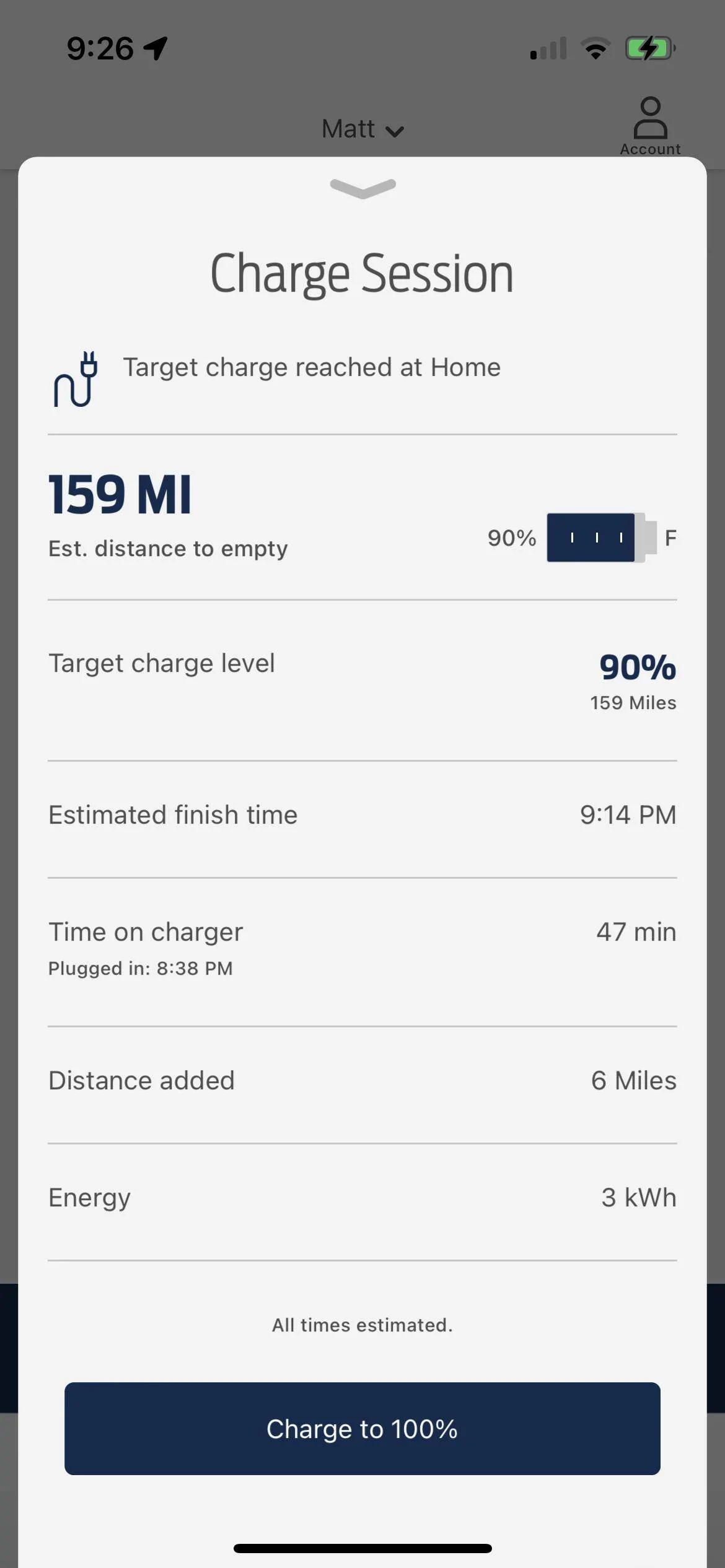

I have a 21 GTPE. I’m also in early access for the “more accurate GOM.” And for the last few months my displayed range is HORRIBLE. And this is summer in Florida.
But honestly? I believe it. My commute is 1 Mile to work and half the time it’s at a stoplight or in a parking lot.
Here is my current range at 90%:
159 miles. Before the early access change, it usually was 230 or so in the winter.
