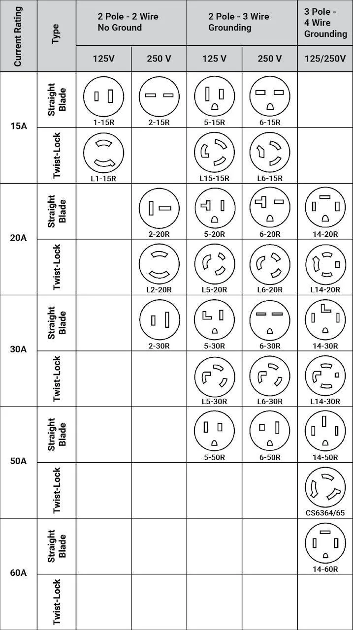

The only exception to the 3 prong thing is the NEMA 6-50R outlet. It's meant for 240V/50A connections. Otherwise, no go. ??
Ford Mustang Mach-E 30 amp nema-01
My co-worker's duck club has 10-30R sockets at 240V, which is why I bought a Tesla Mobile Connector and their 10-30P pigtail. The pigtail tells it to de-rate to 24A, which should be safe for 30A circuits. ??
