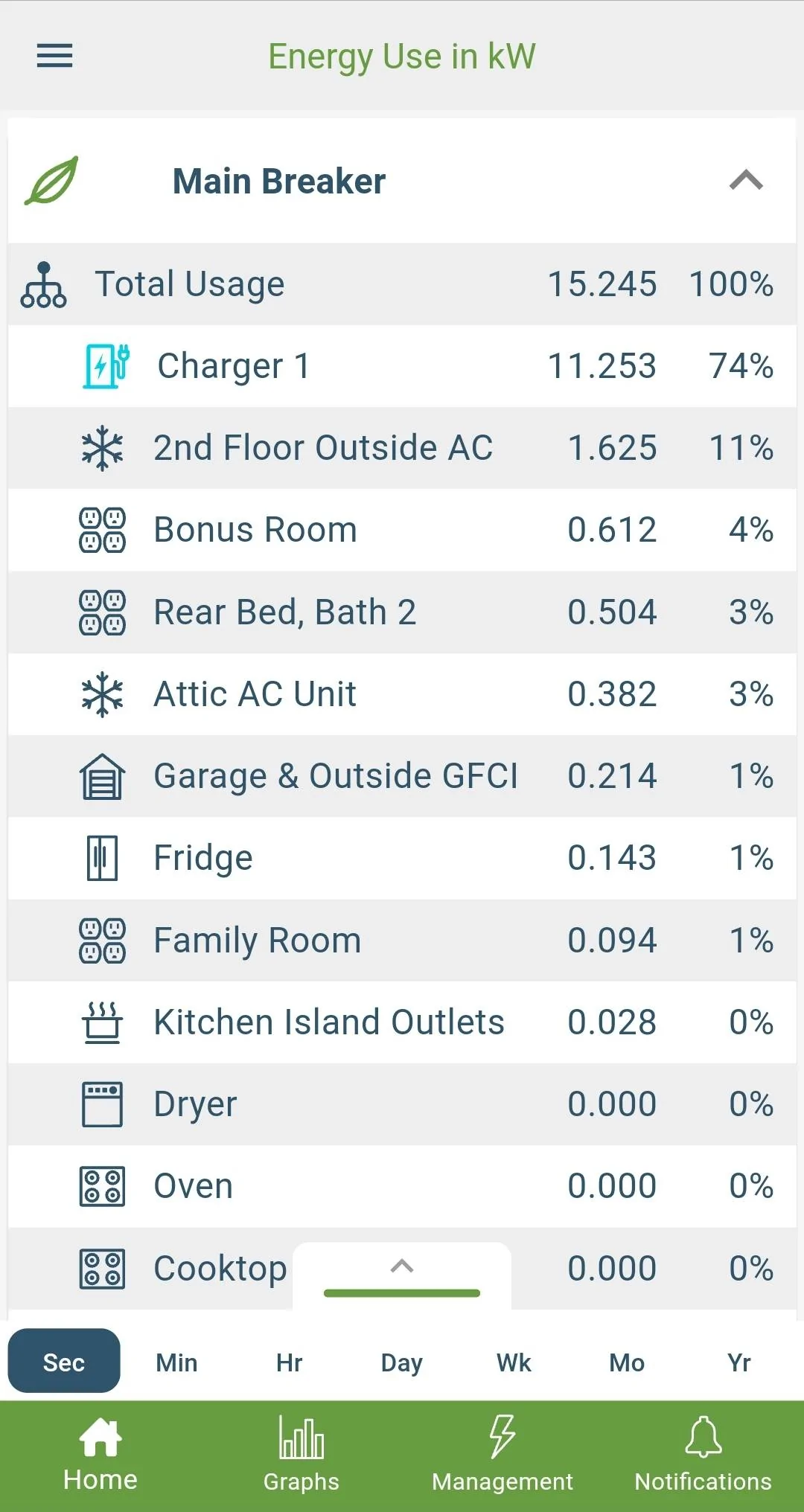

I have the Emporia as well as all the Emporia power monitoring modules inside my circuit breaker box. So I can not only monitor the power going into the EVSE, I can monitor how much electricity various circuits in my house use. I have had no problems since I installed it about 10 months ago.

@mkhuffman appears to have an entire smart panel that reports what every breaker in the house is consuming. That's "other devices" beyond the OP's original desire.

He bought adapters to connect his breaker box. Those adapters and equipment to use them aren't part of the charger. If he's using the same app as the charger, I don't really see that as a huge benefit, since the app for the monitoring would show the charger's power usage. But regardless, that's over and above a charger.

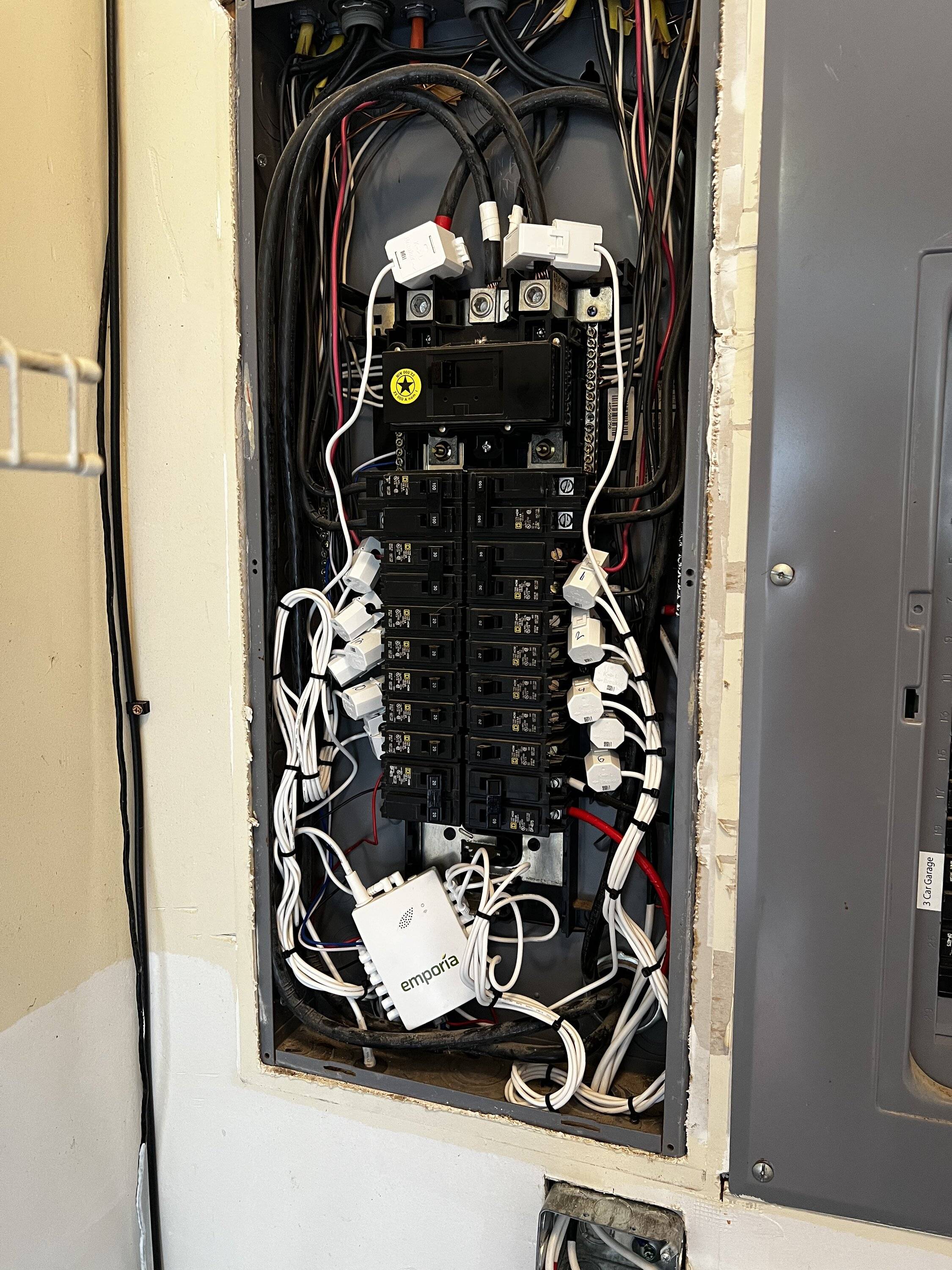

Emporia does have the hardware available to monitor your whole house. I have 2 main panels and 5 sub panels. I like them. Buy using them I have found offending circuits and am saving about $100 a month on electricity. (Don’t ask how much I use, it’s embarrassing) Here it is in one of my main breaker box, the one with the charger.
