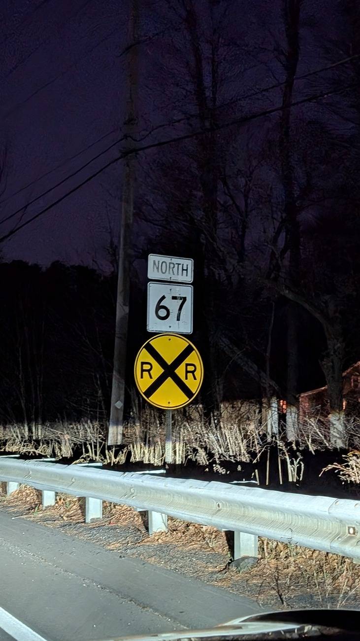

Found the culprit!
Tonight, on my drive home, I paid close attention to when my speed limit icon changed from 45 to 60. It was exactly as I passed this road sign! Well, not this exact sign, but the same sign a few miles back down the road. This one is closer to my house and right before a stop sign.
It's funny that the same road sign doesn't seem to trigger the speed limit change during daylight hours. Wonder if it has something to do with the headlight reflection.?

Found the culprit!
I have a similar situation but mine is a county road 50 sign which inevitably decelerates my car from the posted 65 mph (+ 5 mph, so 70) to 55. After I figured out the cause I remember where the problem stretch of road is so I am ready to override the computer.
