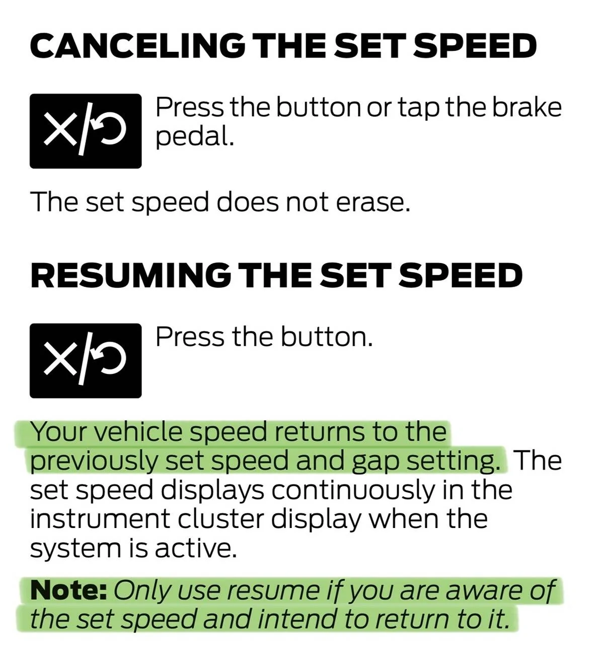

Seems more like you were unaware or forgot what the previously set speed was.
If you want to turn on cruise control again at your current speed you should press one of the SET buttons instead of the resume button. Especially if it’s on a different road with a different speed limit.
In any case 50 vs 65 isn’t outrageously different and shouldn’t be causing any emergency stop situation? Just press cancel or tap the brake pedal if you feel like it’s going or accelerating too fast, like in any vehicle with cruise control. Adaptive or not.
Note also that this he vehicle displays the previously set speed on the IP (upper right corner).
