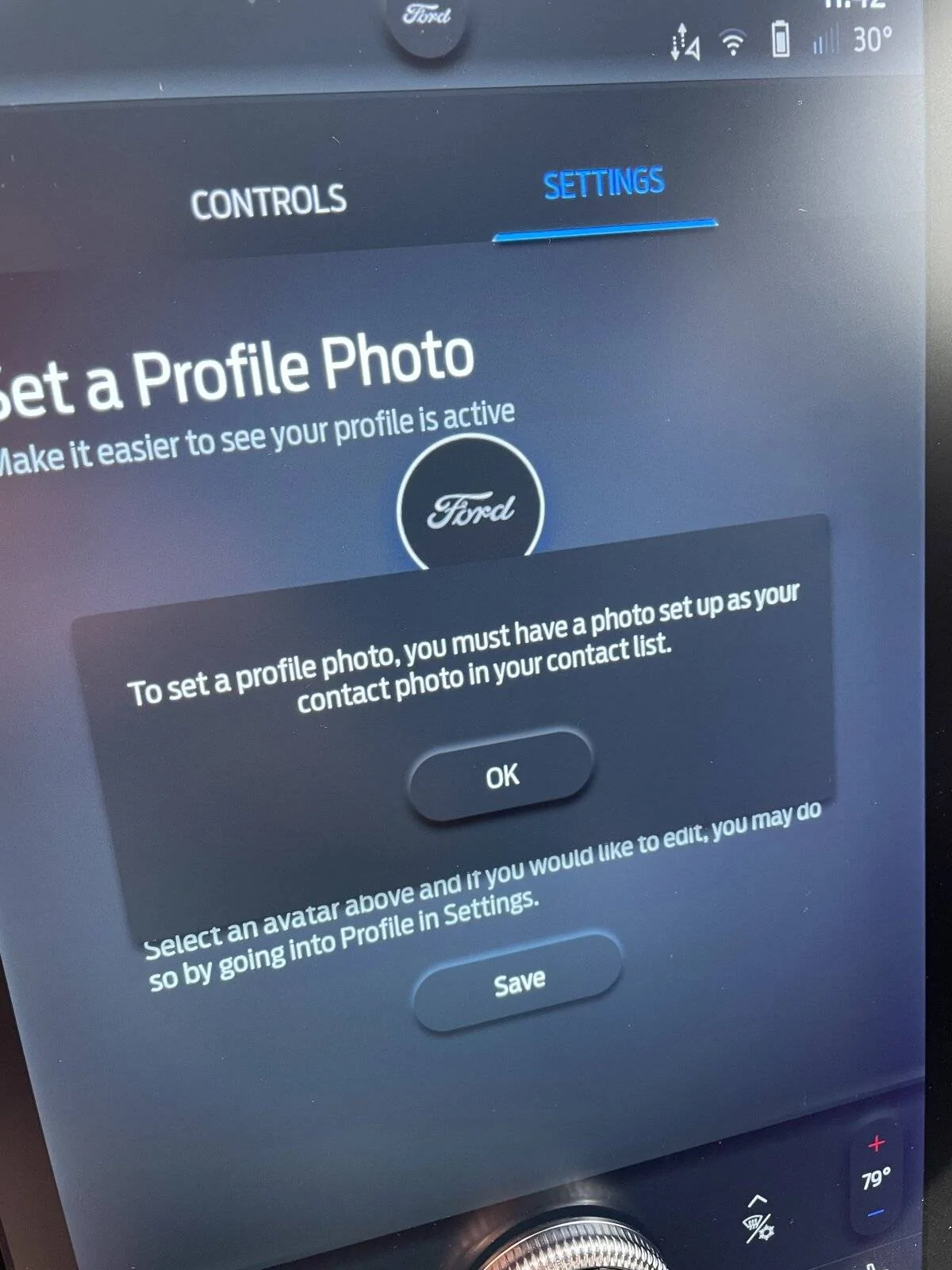

Has anyone else encountered this? I want my Memoji (iOS) to be my profile photo in my MME. I get this error:
My main contact photo is the photo I want, I also have one to match my profile. Anyone been able to successfully change their profile photo?

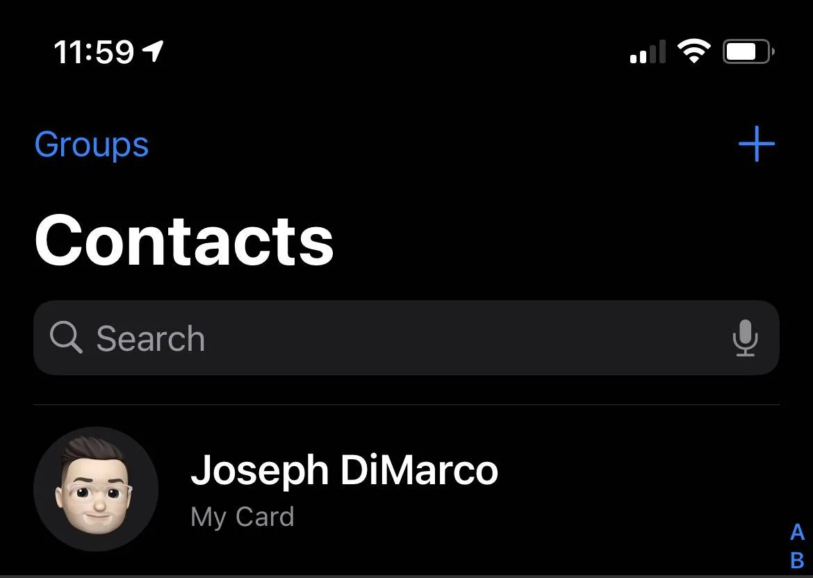

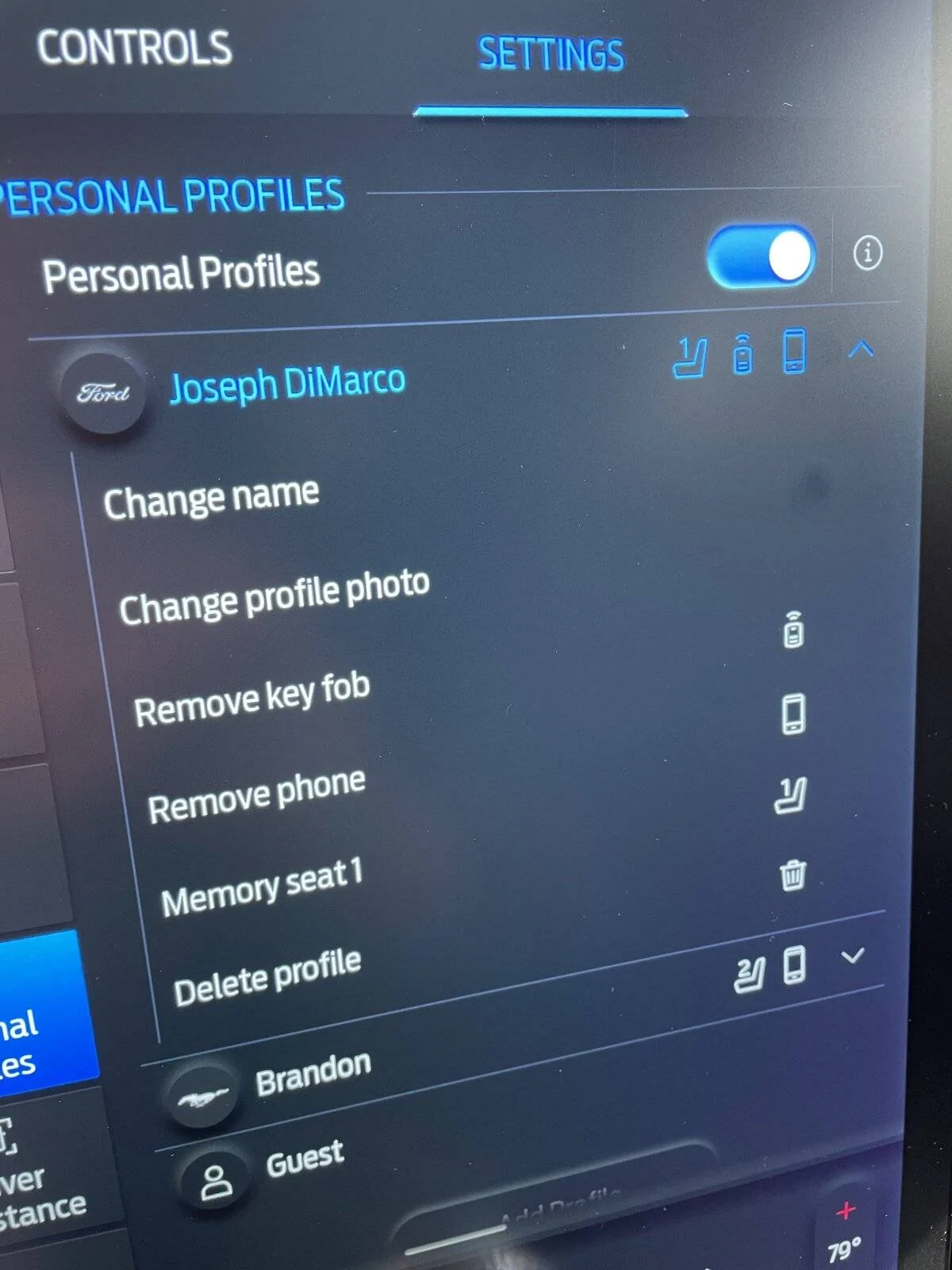

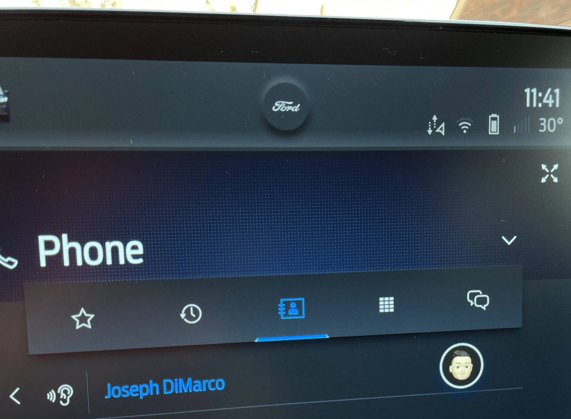

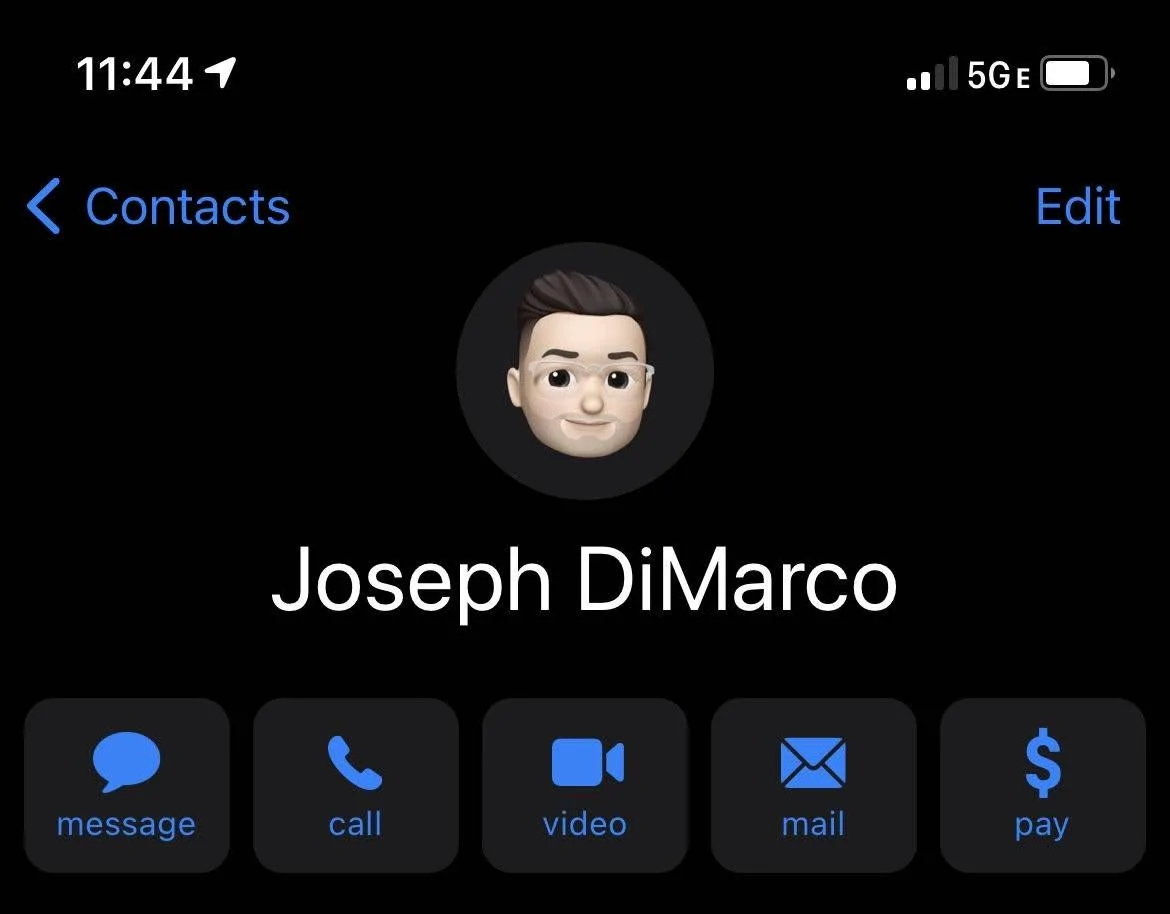

I have tried absolutely EVERYTHING. I even made sure my name matched EVERYWHERE and to delete my middle name if it was present. I deleted the contacts out of the car and deleted the phone, re-sync'd, nothing. I have no clue what to do. It shows my profile photo from my Contact Card in the contacts after re-syncing with the car. Idk.
