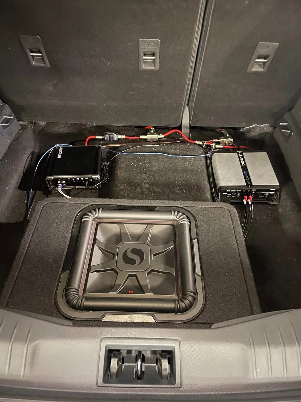

Finished! I started with Kicker 6¾" coaxial door speakers in all 4 doors. Sounded better but not good enough. After researching, and lots of help from this thread, I got the PAC LPHFD31 "T" harness, which fit and worked perfectly. Ran wires from head unit to AudioControl LC5iPRO 5 channel LOC (specifically for remote turn-off and base roll-off). RCAs to a Jensen JA5B 5 channel DSP amp and back to head unit. Added a Kicker 12" non-ported sub with enclosure and fired it up. After a few days of tinkering, the sound is 100 times better and (surprisingly) rattles the windows. I set the LOC to full range, all gains at 12 o'clock and AcuBass threshold to max. Used the Jensen App to dial the DSP settings (which are limited) and was instantly pleased. It doesn't sound quite as good as my old JL Audio system but instead of paying $5,000 dollars, I spent less than a grand.
