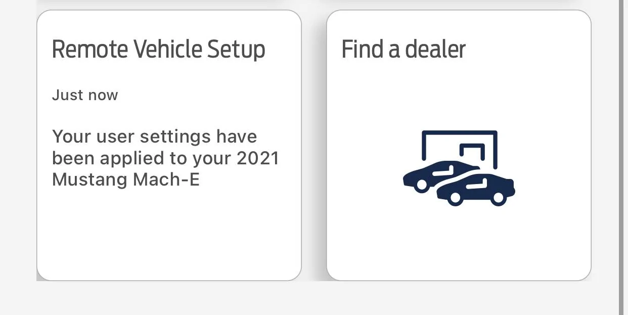

I’ve struggled with this for months. My wife’s profile photo works but mine is always blank.
I was able to get it to work by sending my settings from FordPass to my car. I saw a button to do this in the My News tiles at the bottom of the Home tab. I’m not sure how to get that to appear. In my case, I had removed and re-added the vehicle to fix another problem.
In any case, after I tapped that button, the photo from my contact card on my iPhone finally showed up in the car!
I’m still not sure what the profile photo at the top of the Account tab does. I can’t get that one to show up as an option in the car. But at least I can use my contact card photo.
Here’s the button I tapped (on the left):
