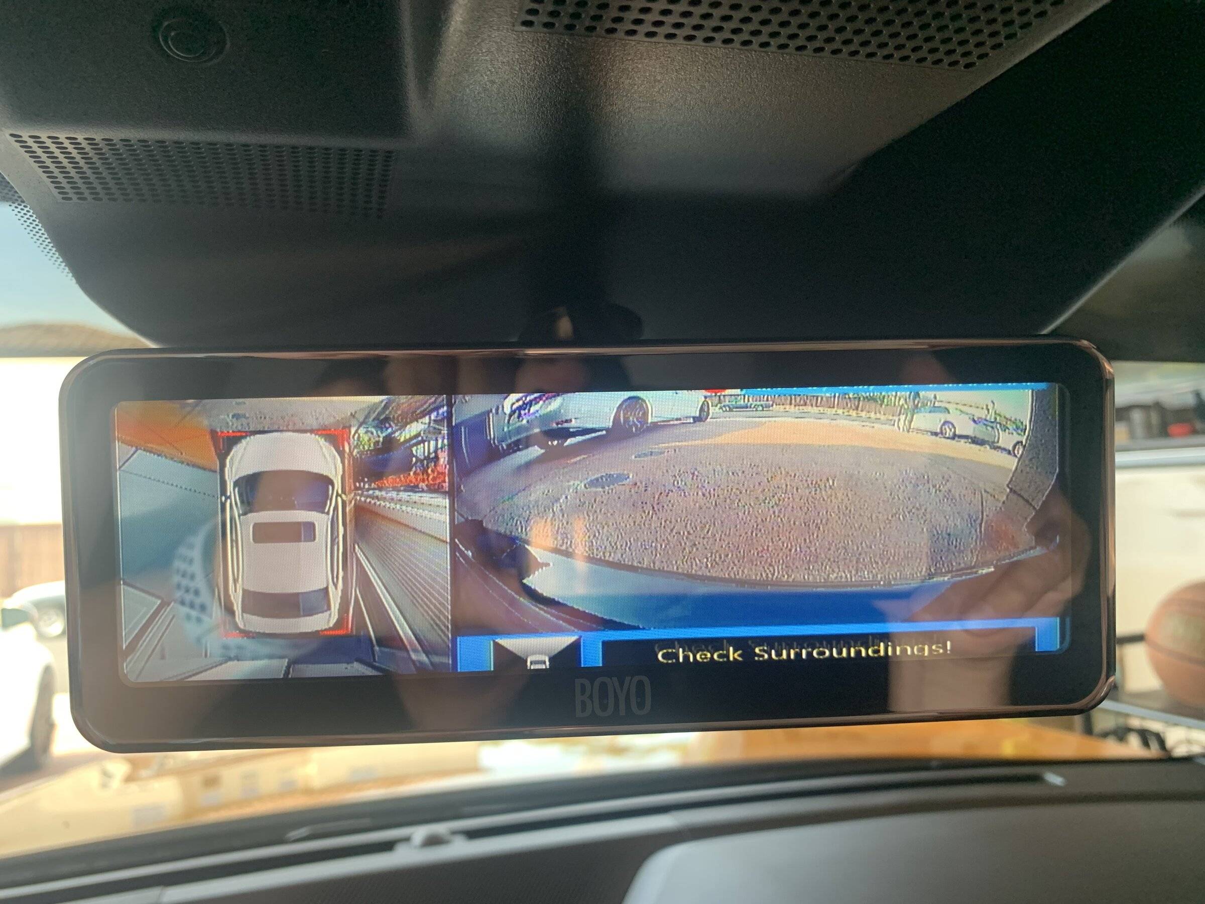

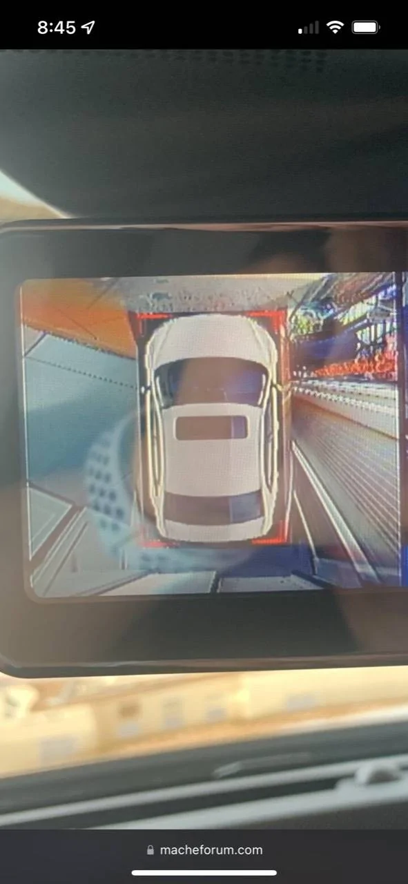

Nah, the pic is showing the front camera on the right & the left side the Birdseye view (up top)....Not wonky if you are not used to it......It shows the 360 view from above per se.....
Not in pic but when I signal left or right, the mirror triggers the left or right camera to display (left or right) side. Pretty cool to me but I still use my mirrors and turn my head for safety....
Ok. Are you in the garage or something? When I zoom in on the picture, this is what I see and can’t figure out anything actually in the picture. Looks like cartoon drawings around you and the pictures aren’t stitched together. Both the left and right sides look like you already ran something over!
I’m sure it’s better in person.
LOL
Yes, car was parked in the garage and how this works- All cameras are connected to the brain of the unit to give the birdeye view. If something is close to that area, it will show on that angle with it besides the camera view on the right.....
Hard to describe but basically how that works....I don't have anything to benchmark against. You are correct, looks better in person just like if I took a Selfie..... :eek:

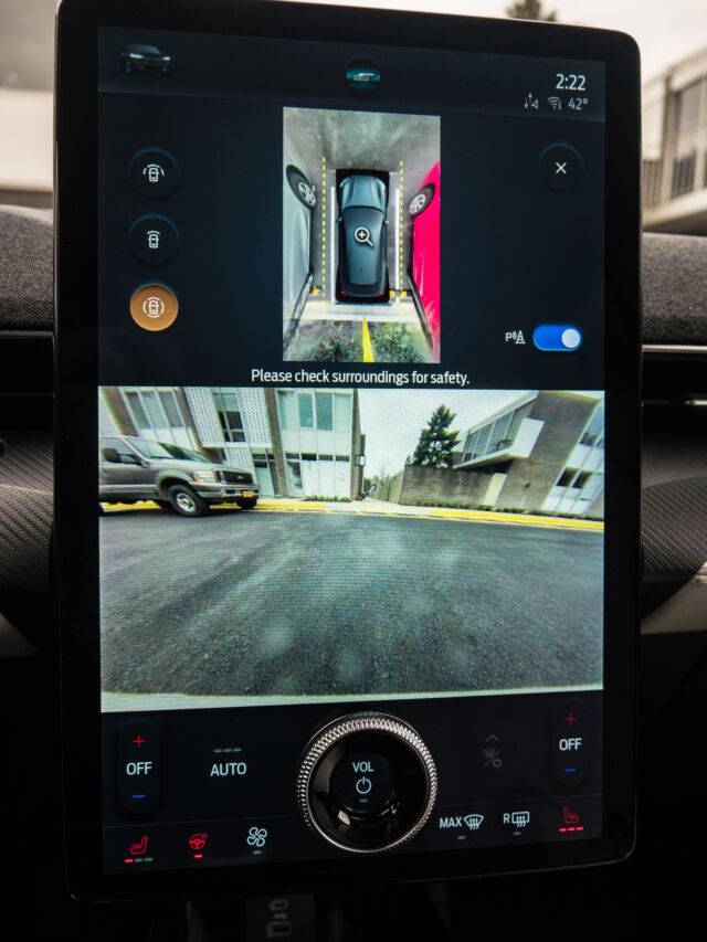

Here is a pic of the 360 on the Mach E for a benchmark. They do a great job stitching the images together. Things close look funny, but it’s still easy to see where you are.

The main difference between the two is that the aftermarket solution has the wrong aspect ratio so the top-to-bottom is squished and things are extra distorted.
The problem with using the correct aspect ratio is that everything would be smaller because the screen is tiny.
So the compromise is either:
Use the correct aspect ratio of the cameras and have much smaller objects, some of which then won't be visible
or
Use the incorrect aspect ratio so objects are distorted but are a bit larger and fill the screen.
This is something I ran into with the aftermarket solution for my Tacoma. I solved it by moving things to the OEM screen. That appears not to be an option on the Mustang until an adapter is developed.
