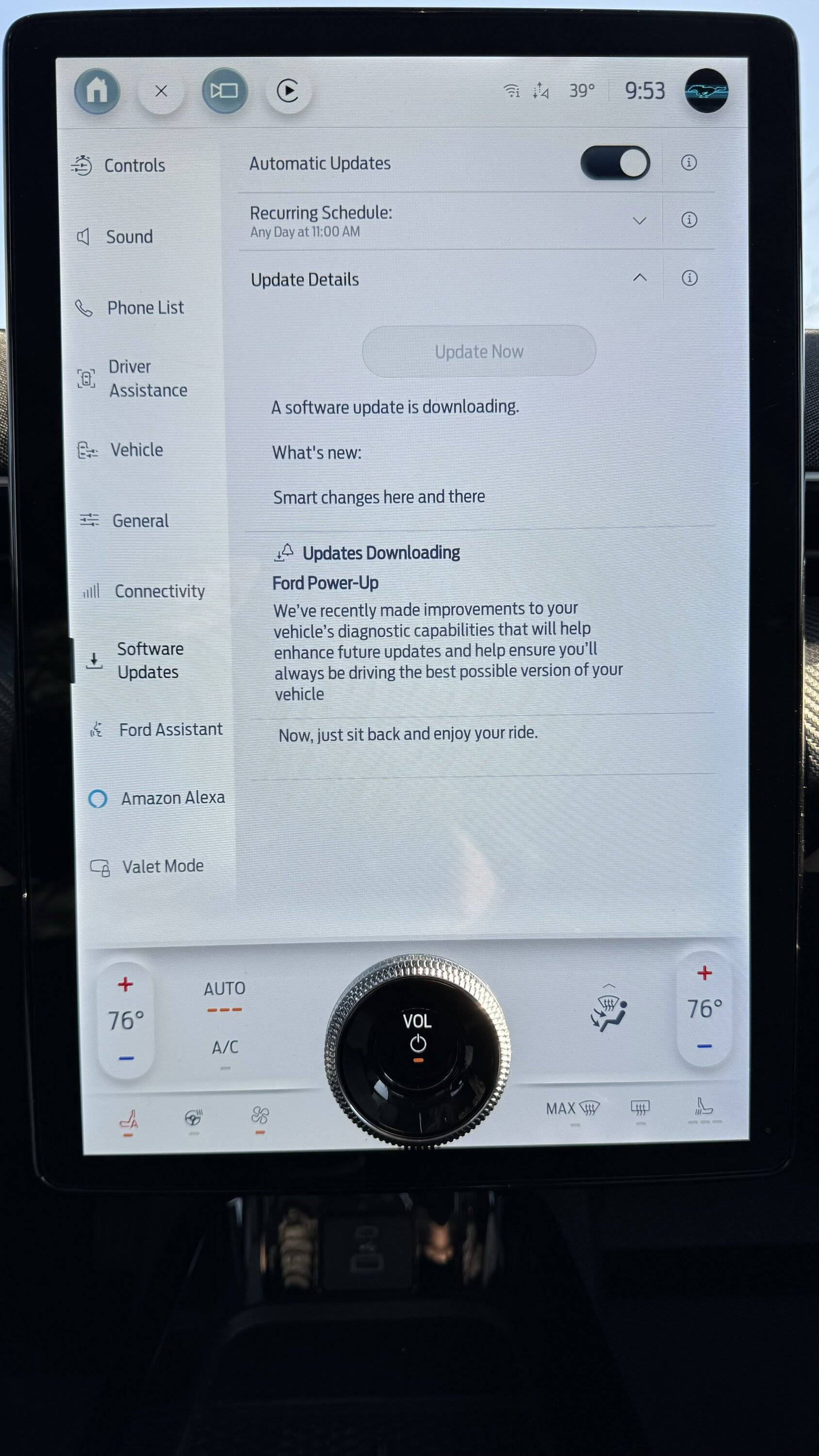

A while back (maybe a month ago), I received an OTA that didn’t have a name or number. Today, my car is receiving another update with no name or number and the descriptive text seems similar to that of the prior unnamed update. Any idea what may be going on here? Screenshot of currently downloading OTA below.

Can't really tell from looking at that. The other no-name update was a GWM. I would need your VIN to check this one and compare it to the other one. You can PM me if you prefer to keep it private.

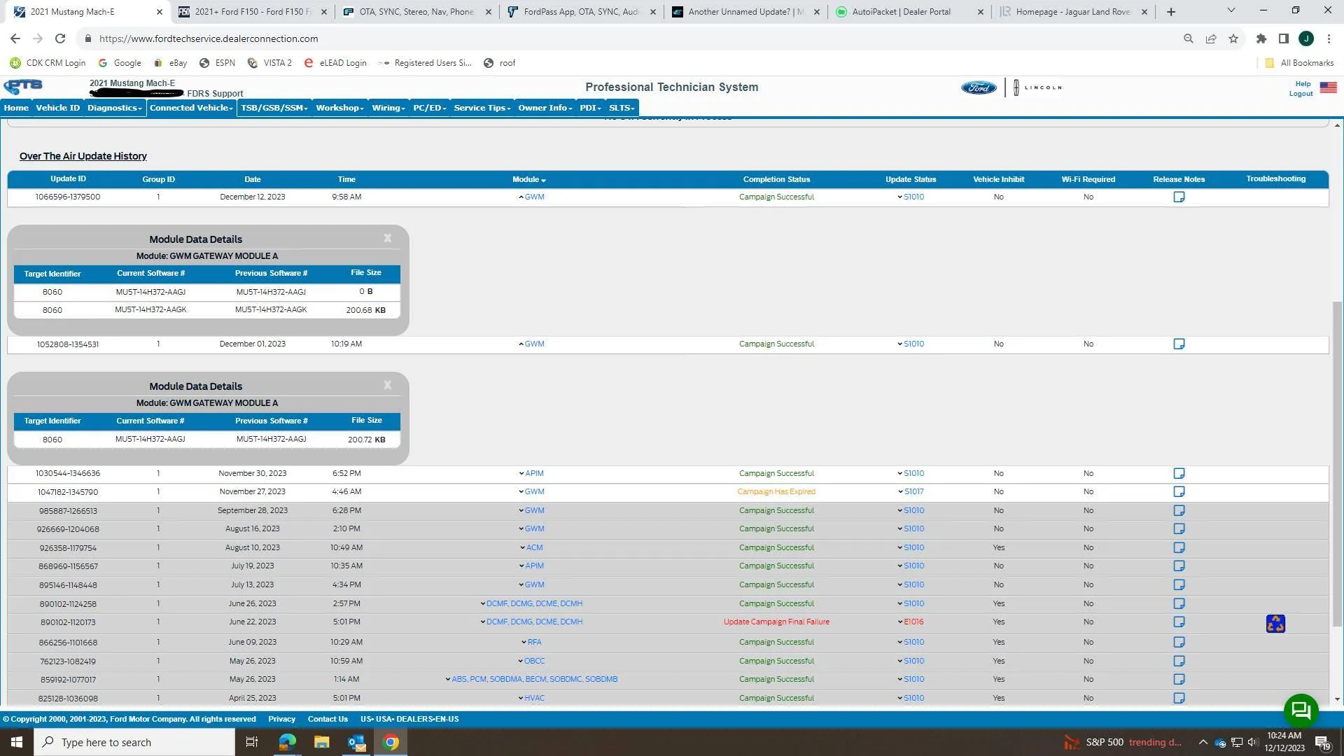

Not sure what to make of this, but I'd say it's more clean-up. It's another GWM update. The first one replaced one file with the same file:
Target IdentifierCurrent Software #Previous Software #File Size
8060MU5T-14H372-AAGJMU5T-14H372-AAGJ200.72 KB
This second one replaces a different file within the same location with the same file, too.
Module: GWM GATEWAY MODULE A
8060MU5T-14H372-AAGJMU5T-14H372-AAGJ0 B
8060MU5T-14H372-AAGKMU5T-14H372-AAGK200.68 KB
I am assuming they fixed something in the file and pushed it out with the same file name. It would explain why there is no power up or priority version since there is no change in the file names themselves.
