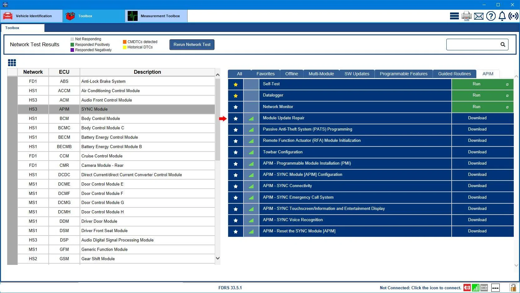

I'm not there so I can't say for sure. I'm just advising they try to do everything they can with software to avoid replacement since APIMs are hard to get, and many are replaced needlessly. There is a module update repair they could try too in FDRS:
Ford Mustang Mach-E APIM Phantom Power Drain module_update_repair-png
