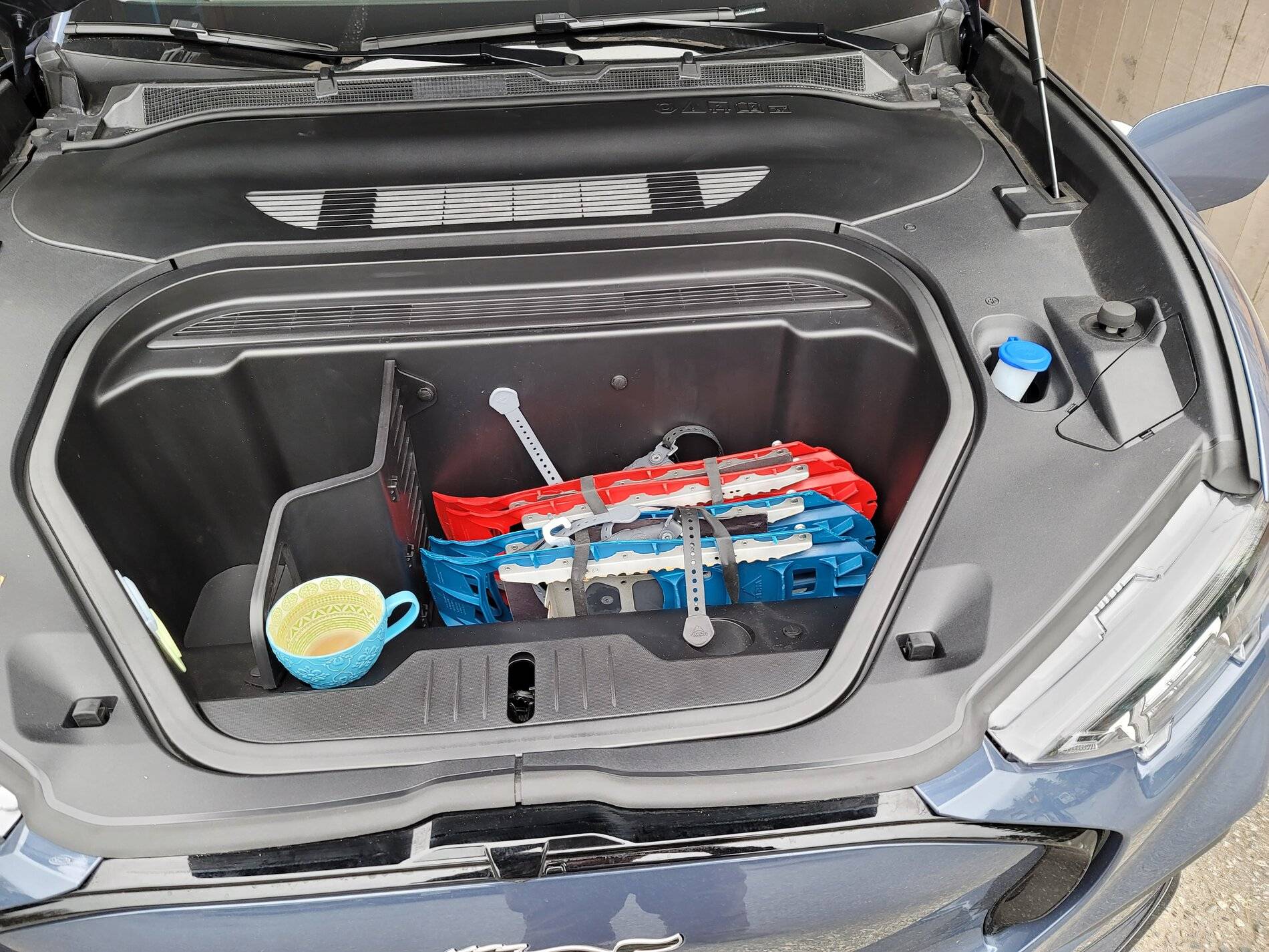

Did one side still in. Works well for the snow shows and hopefully Costco.
The frunk removal was very easy for anyone who has worked with panels with auto fasteners, plastic covers, and trim tools. The most difficult part was on the passenger side forward, when one of those metal over plastic clips just would not pop. It probably got a little bent on assembly. Pushing on the side while lifting finally got it unclipped from the painted metal slot below.
On re-assembly, I was debating for putting only one side back, to put back just the right or left divider. I think @AllenXS found the best solution, not sure why, but the left one just feels right! I will load all the regular junk I carry around from the GB40 jump pack, 10mm wrench, etc. into the small compartment. It will be good to get rid of the plastic bin in the back, where after trade-in, I just unload all of that stuff plus the drivers cubby into a the bin (it has two cars worth now).

My father was a truck body builder and so I had learnt how to take the pins out. Although I have ruined a few over the years these were fairly easy.
Just the right amount of force with a screwdriver not to bend them. One side of the lug carefully supported by the thumb. Then the other side. Repeat process and it popped out easy.
I started with the right side and took two out from the left to pull out the centre piece. And having a coffee helped to make the process better.
