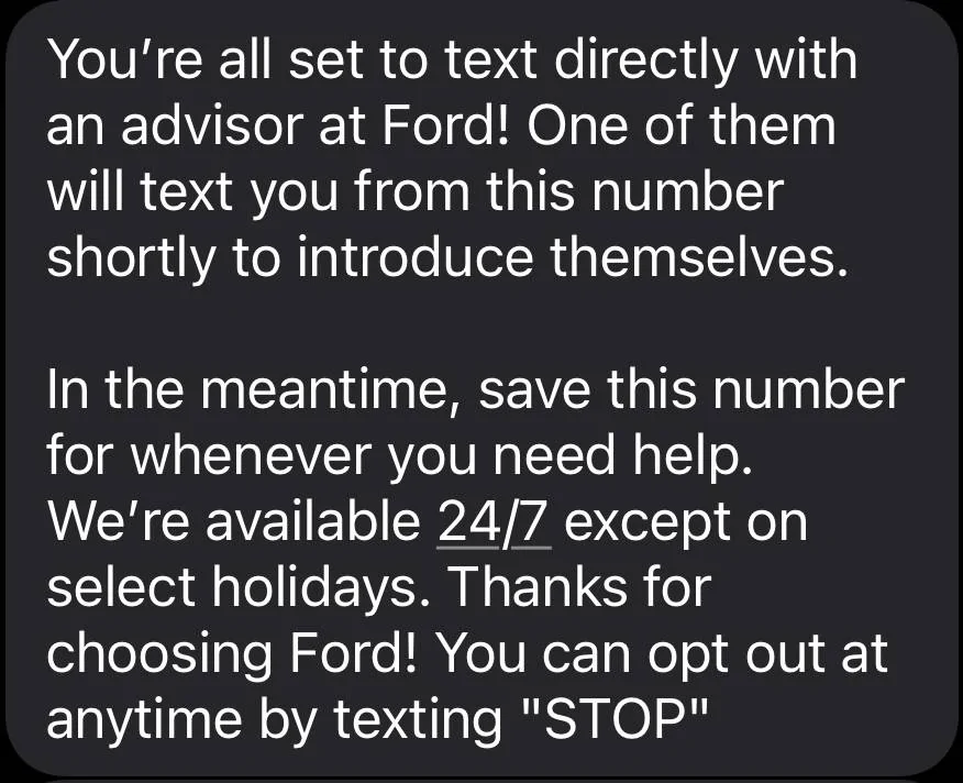

I was going to do that, but got set up with the Ford Advisor number, so I asked them through text, she gave me a couple options nearby. Might come in handy later too.
IIRC, and I may not, I think the sign up may have been through this page, might need to be logged in to see it. This is what they send you:
