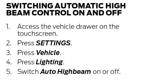

If you went below 19mph, they would stop working until you got back to 32mph.
So turn them off, either temporarily or permanently. Temp - push lever away from you to go to high beams, them push it again to turn them off.
Permanent -
Permanent -
Good to know there's a temporary way to disable it (though I'd have to flash him again to do that). How long does that disable the auto high beams? Until I turn the car off?
Yes.
Permanent -
You can also turn them off temporarily for a drive by turning the headlight switch to ON instead of Auto. Obviously just remember to turn them back to auto when you leave the car.
