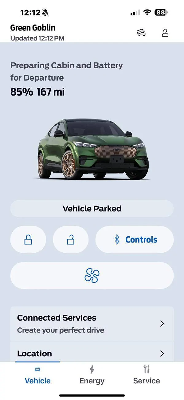

The car is left plugged in after topping up the HVB and it seems to be preconditioning itself occasionally. Even on days I don't plan to go anywhere, I still hear the fan kick on and the charger start up. The app displays "preparing cabin and battery for departure."
I'm wondering if anyone might know how much juice this uses? Maybe it's a better idea to unplug after topping up. I only have the Ford EVSE at the moment.

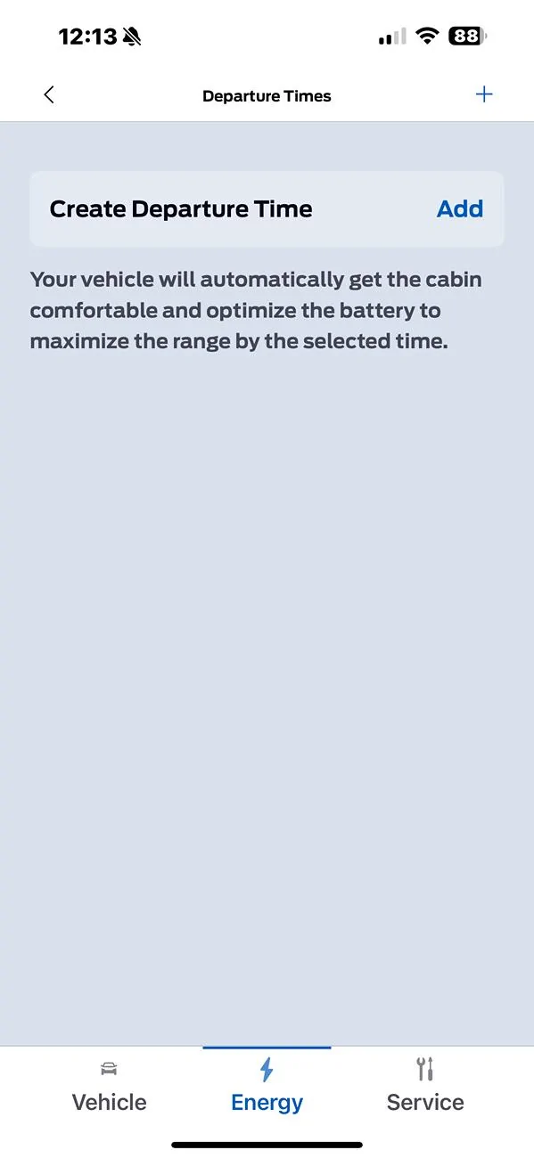

Thanks for the reply! There's definitely no departure time set, but we have been below zero Fahrenheit for a couple of days.

I had a similar experience yesterday morning. The car was still plugged in from the night before. I hit the climate on button in FordPass. I see the blue spinning fan and the Climate On message so I locked my phone and continued getting ready. About 10 minutes later when I got out to the garage the car sounded like it was charging, I could hear the coolant pump running. I open FordPass and the climate fan is not spinning and I see the “preparing cabin and battery for departure" message. The car was stone cold inside. It was about 19F outside but closer to 29 degrees in the garage.
It was within my charging schedule window even though the battery was at my set level already from the night before, so basically wall power was allowed at the time I did the Climate On.

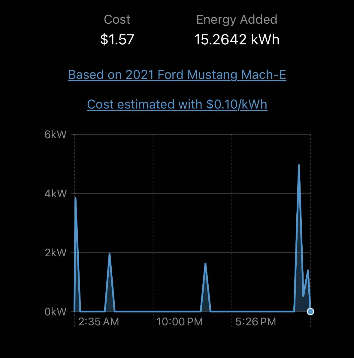

The amount of energy used for a scheduled departure time (battery+cabin) varies depending on how cold the car is. Usually, I see somewhere around 3-7 kWh used. In the summer, it might only be 1-2 kWh.
And yes, the car will periodically heat the battery to keep it above 0ºC while you are parked and plugged in. You will hear the battery coolant pump running and see "Preparing Cabin and Battery for Departure" in FordPass when this occurs, even though the cabin won't be heated. It only heats the battery, so the electricity consumption of the automatic maintenance heating is a lot less than a regular departure time. In the photo below, you can see a couple automatic heating events over a several-day period: the first heating event used 2.2 kWh, and the second one used 1.9 kWh. They occurred roughly 24 hours apart. At the end of the period is a scheduled departure time for comparison. I park in an insulated garage (temp was about 25ºF), so the automatic heating doesn't occur as often as if I were to park outside in below-zero conditions.
Ford Mustang Mach-E Automatic Preconditioning Without Departure Time Set - Electricity Consumption? IMG_0363
So to summarize, the automatic battery heating will run as often as necessary to keep the battery temperature above 0ºC during preferred charging hours, and will use about 2 kWh each time it runs (which costs me about 20¢, minor). This is why Ford wants you to keep the car plugged in during below-freezing weather so the battery can stay warm. If you aren't going to drive the car for several days, then you can unplug it so heating doesn't happen, but usually the added expense is only minor unless you are parked outside in extreme cold conditions. Parking inside a closed garage will minimize the amount of energy used to maintain the battery temperature compared to parking outside.
Keep in mind if you leave the car unplugged, then the battery won't be warm when you need to use it.
Thank you so much for taking the time to gather the data and write this up!
