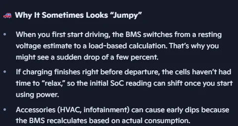

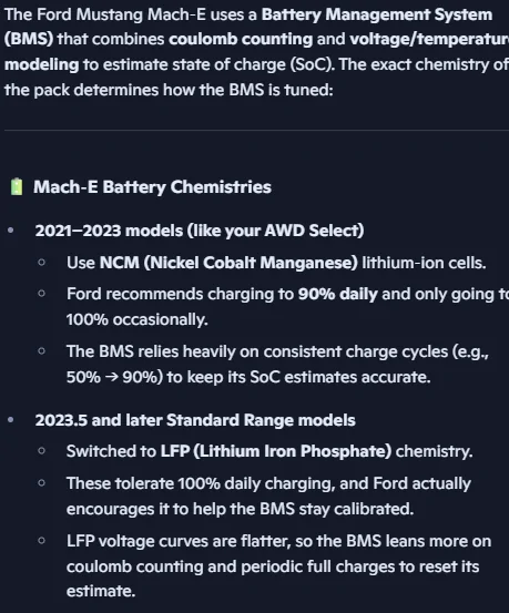

The lose 1% right away is common from what I have seen. It isn't really because you lose 1% it is because it seems the GOM truncates, not rounds. 59.9999% truncated is 59%. I have charged to a given level and then backed my car out 15 feet and have the GOM drop 1%.
All of this is estimated; there isn't an any way to directly measure the SOC. Probably the best way you can tell how fast it really is draining is the "This Trip" number for miles per kWh, because it is at least doing it over time.
There is also this:
There is also this:
Thanks for that info. Rex
