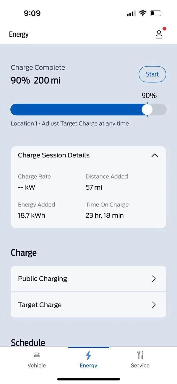

Mine charged to 88% today, set for 90%. I assumed it was the funky spring weather, or maybe some partially ready server change that got pushed?
I plan to just see what it does next time I charge.
mine has started doing that for the past few months. it's almost always exactly 2% below the target. it says it reached target but as soon as i turn on car it's 88%. i'm guessing it's some kind of software bug...

FYI charging to 100% is different than charging to 95% or less in terms of the charge termination. The 100% setting is the only time the battery will charge at constant voltage (absorption mode) until the battery won't take any more juice (which is why going from 99% to 100% can take an hour). 95% or less will charge constant current and stop as soon as a certain voltage target is reached, then the voltage relaxes during the off period and you end up with a couple percent lower SoC when you start driving.
What this means is the battery voltage and SoC won't decay nearly as much during the off cycle when charged to 100% compared to the other SoC targets. 100% is really a "pack in every electron possible" setting that is optimized for taking long trips (and is more stressful on the battery).
