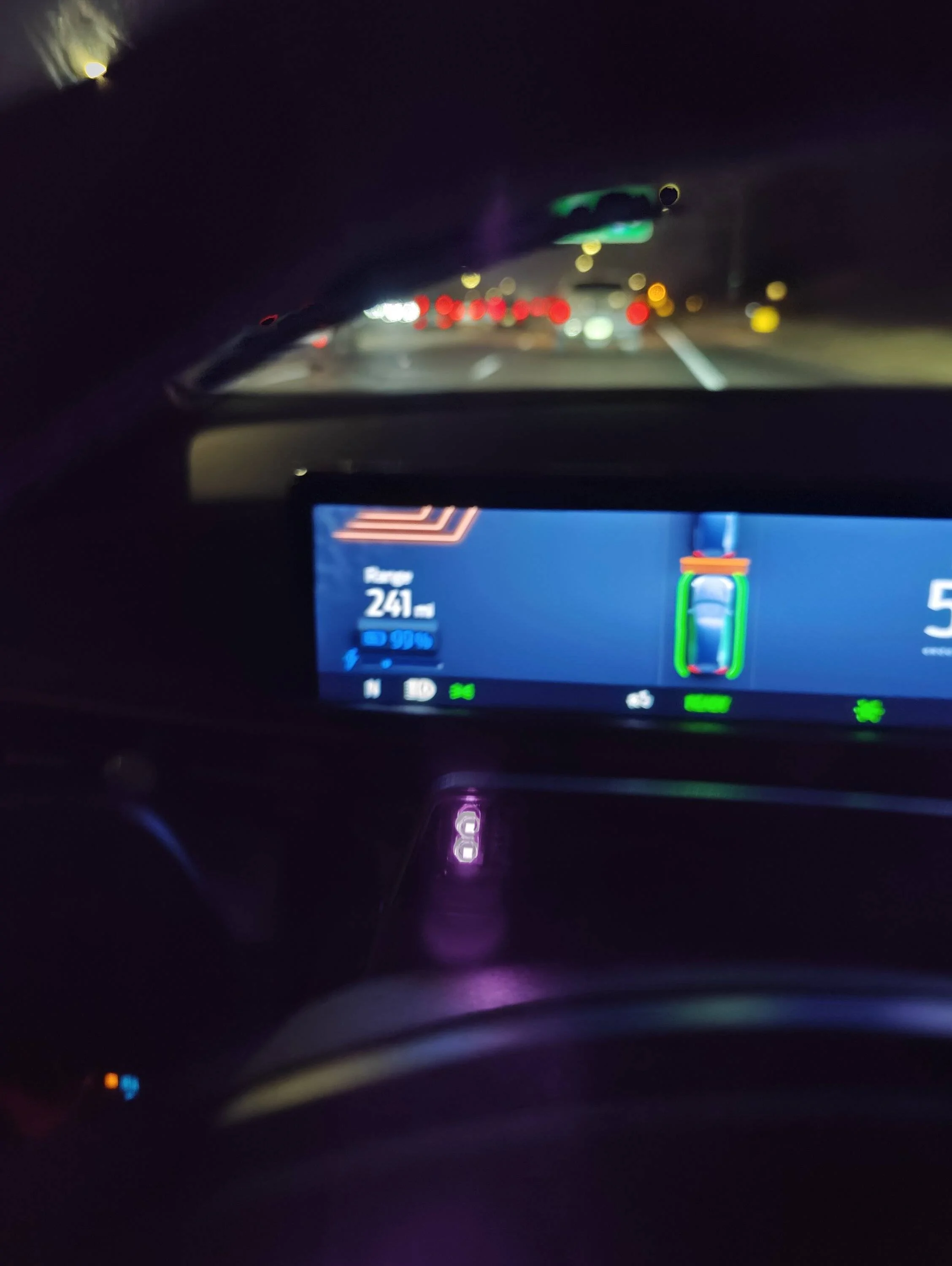

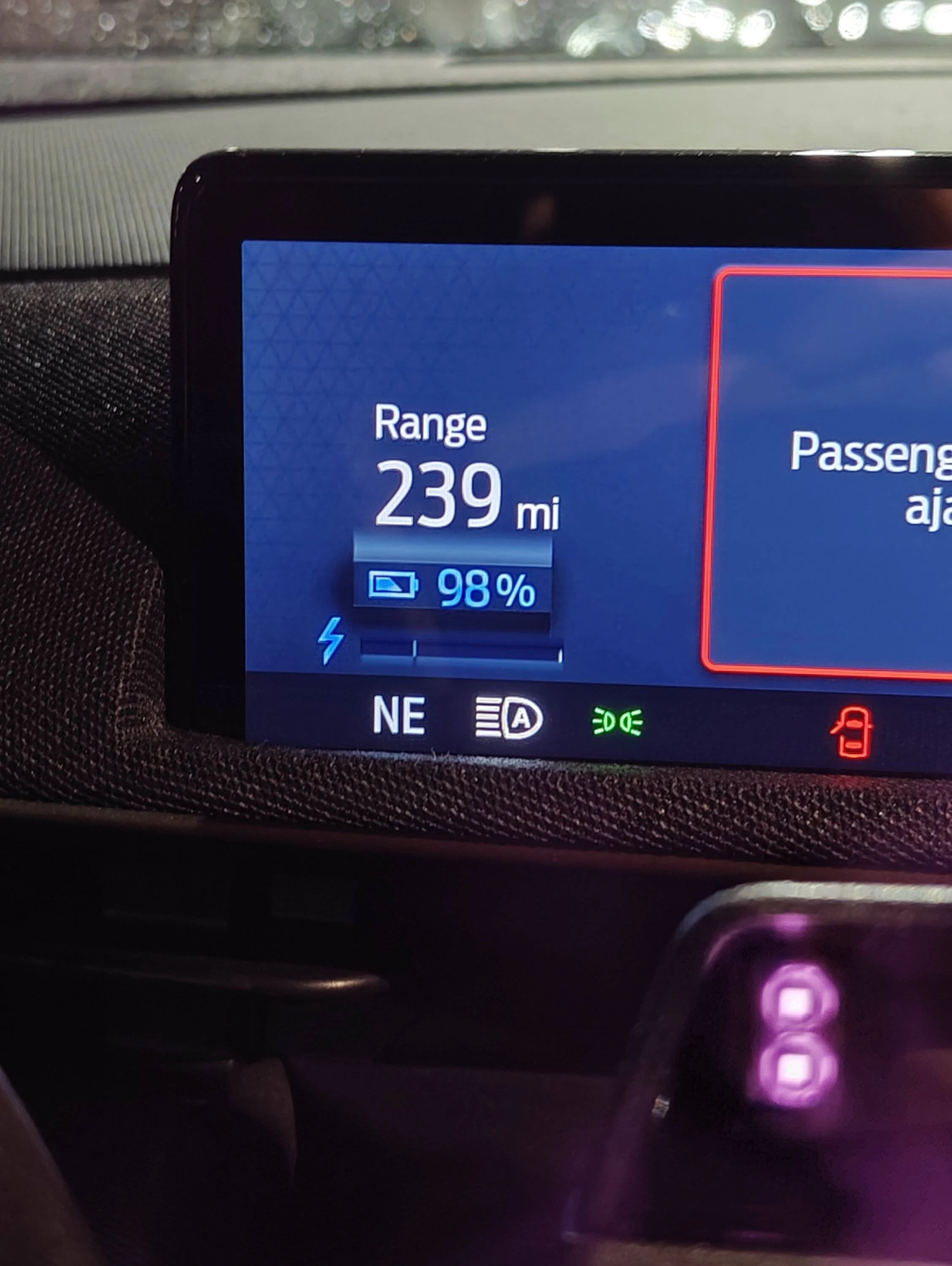

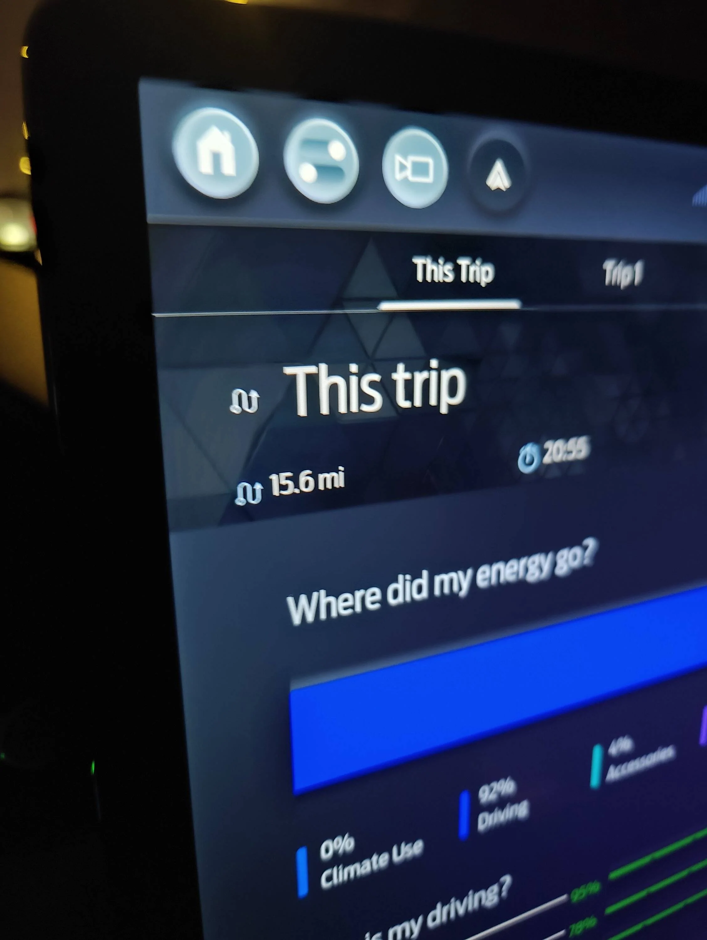

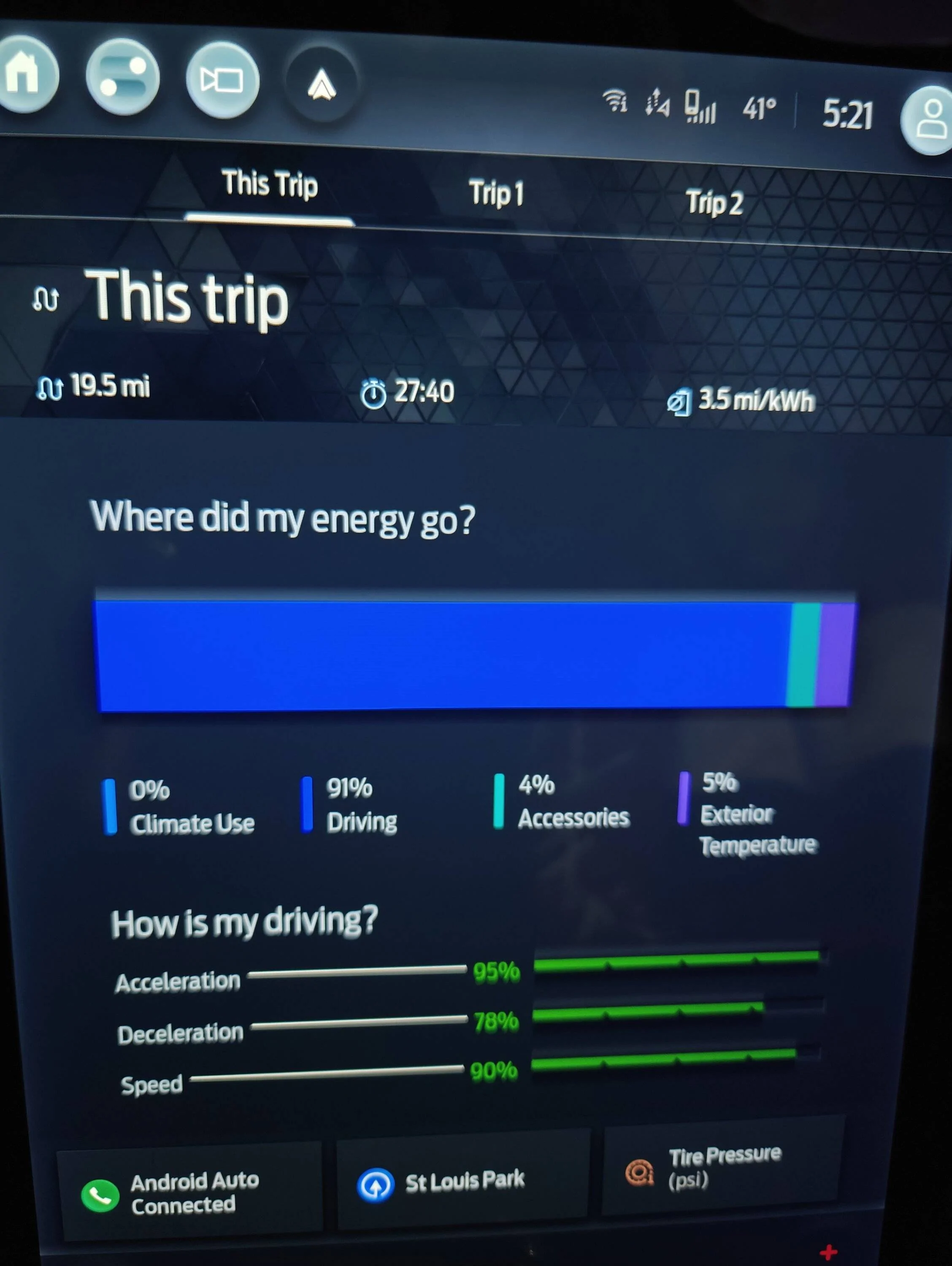

I'm experiencing a weird situation with my 2023 GT and wondering if the battery is over charging or the percentage display is inaccurate, I usually charge to 90% daily however have charged to 100% less than 6 times and on each usage after charging to 100% I can drive an astounding amount of miles before the car drops to 99% then afterwards it does appear to drop in percentage as you would expect but that first percent at 100% seems to be off by about 3% or so, see images of the drive today, 44° in Minneapolis
1% gave me roughly 15.6 miles drive, the 2nd percentage gave me 3.9 miles driven..
Can or does the battery need be recalibrated?

There is some hysteresis in the SoC at 100% so it doesn't drop to 99% as soon as you start the car. How long it sits there can be affected by temperature changes. It also depends how balanced the pack is at 100%.
But as everyone else is saying, it's normal. No problems here.
