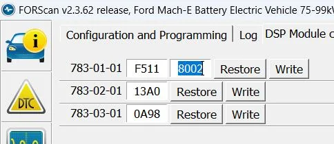

I flipped F501 to F511 in my 2023 and no luck. Still shows the standard bass/mid/trebel EQ

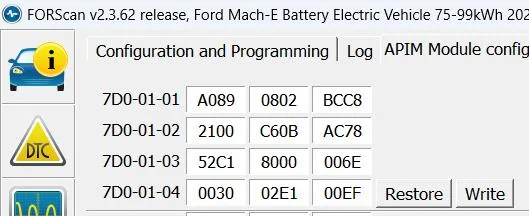

What about the change to the APIM to get the Beosonic menu to pop up?

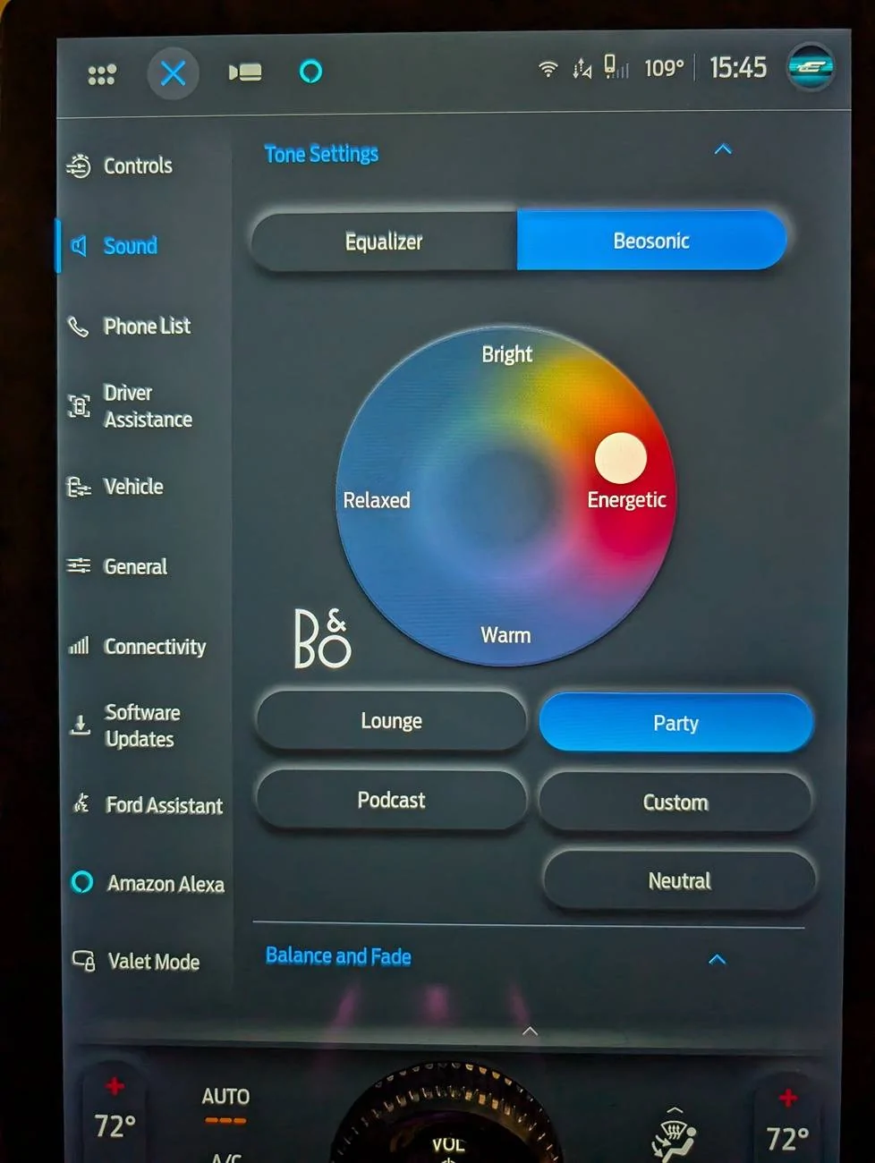

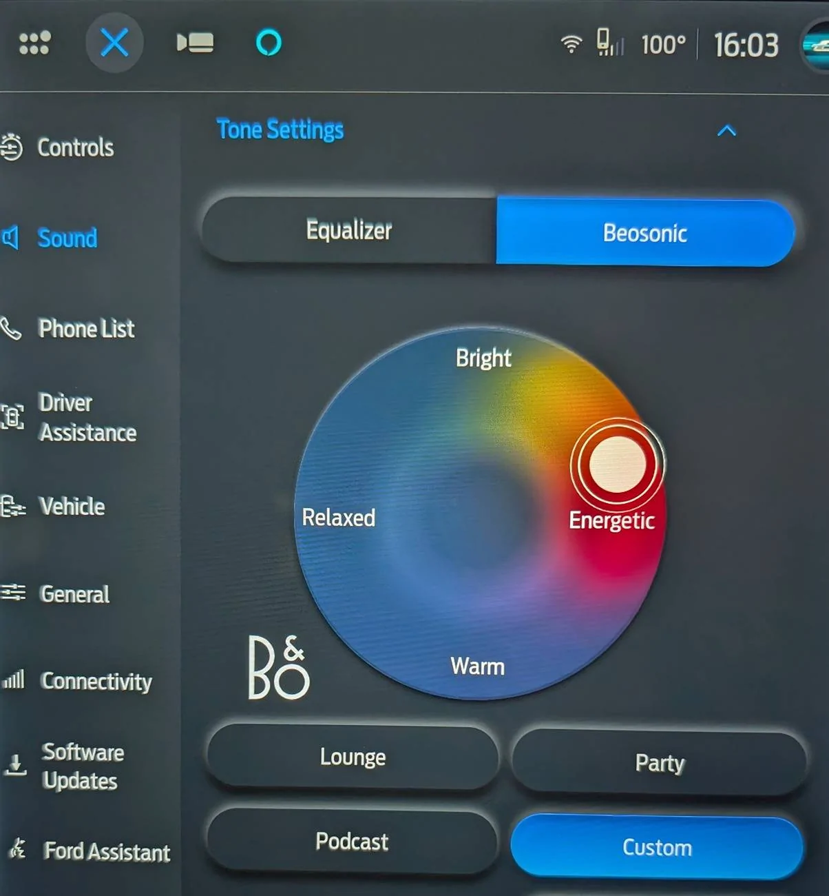

Oh yeah, skipped that part lol. It's working now, and I can hear a difference.
Only downside is I can't switch to "Surround" for Sound Mode now (lower down in sound settings). It keeps flipping back to "Stereo"
EDIT: I can pick "Surround" if I flip to "Equalizer" instead of "Beosonic" so nothing lost with this change.

Not quite there then, yet. In my 2024 there is no issue with having Surrount enabled while utlizing Beosonic.
