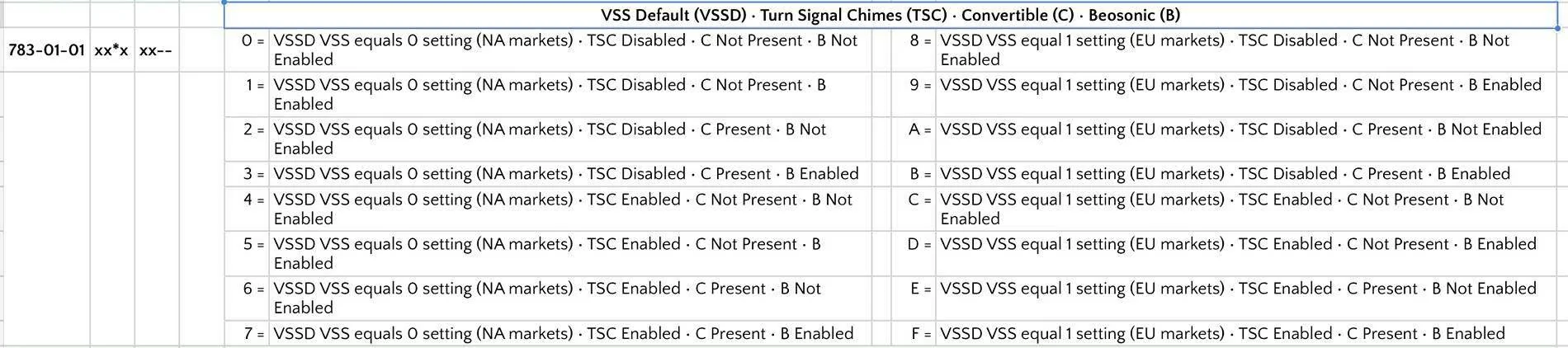

Just FYI, you're supposed to increment whatever value is in that position to enable it. The F-150 forums have a great spreadsheet for their vehicles.
Just increment the value in the indicated position by the number. The numbers after those are just CRC and don't matter (FORscan sorts it out).
For DSP, increment by 1.
For APIM, increment by 8.
I'd say all our vehicles SHOULD end up with the same numbers since we have the same configurations
Changes applied to:
DSP 783-01-01 xx1x xx
APIM 7D0-01-01 xxx8 xxxx xx

Yea, I getcha, but an 8 in the APIM didn't work for me or several others that tried with both B&O systems. I though at first it may only work on the 6 channel DSP and not the 10 channel we have with the 18 speaker system, but same results in both cases.
This is what I show here:
Ford Mustang Mach-E Beosonic 1727374525200-jy
Another member tried changing -02-01 Xxxx to a few different values to see if changing vehicle types helped any, but that didn't help, either. Turning noise canceling on/off also didn't help. We're still tinkering with it. I plan on messing with it on Sunday when I have some time to try and figure it out.
