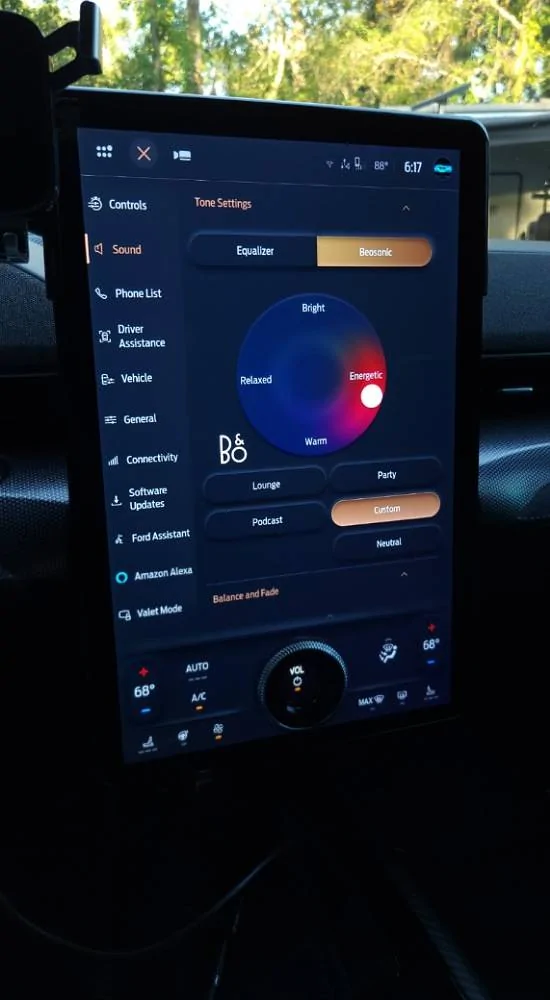

2023.5 Mach-E
This is the kind of missed opportunity that Ford drives me nuts with.
Here's a chance to deliver a teeny tiny OTA (or FDRS) that simply edits hex values in EXISTING customer's Mach-E's, and they get a new feature in a vehicle that yesterday didn't have it. Obviously the necessary software was already installed on my car, but the feature wasn't yet enabled.
Took 2 minutes after carrying the laptop out to the car.
Played around with it on a few songs. Pretty cool! Double tap for the win.
Ford Mustang Mach-E Beosonic IMG_20240929_182304_(550_x_1000_pixel)
Thanks to all you fellas that fuss and figure out these things, and then share.

So you enabled the UI, but does moving it around actually change the sound? The DSP would also need to have the software for it in order for the sound to change.
Yes, it absolutely functions. The trick is to move the dot to the area you choose, then double tap the dot itself. The double tap immediately makes the adjustments aurally.
And yes, it requires the Forscan edit in the DSP module, as well.

Double tapping is just turning surround mode on and off (which will definitely change the sound, but that's existing functionality). Are you sure the sound is changing from ONLY moving the dot, not double tapping it?

It does not change the sound just sliding the dot around.
When I tap the dot and the sound changes, it changes very differently if the dot was on "relaxed" vs if the dot was on "energetic".
And if you hit the Neutral button, it definitely undoes the aural changes.
I'll go out to the car and spend more time confirming the details

@Mach-Lee You are right about the double tap. That cycles Surround/Stereo.
But I was right that depending on where the dot is, you get very different tonal output. Regardless of the double tap. But that's because the Beosnic pad IS working as you move the dot around, but not until you lift your finger. Lol
I definitely confused myself.
So in summary, Beosnic is working if you reposition the dot and let your finger off.
The quickest way to test if it's working is to slide the dot all the way down to 6-o'clock and let go. It'll immediately sound like the vocals put their hand over their mouth. All the brightness will be gone.
And yes, the double tap is a quick convenient way to cycle back and forth with stereo/surround.
Smartphone recording, so not hifi. But definitely captures tonal changes on Beosnic pad
Beosnic video
