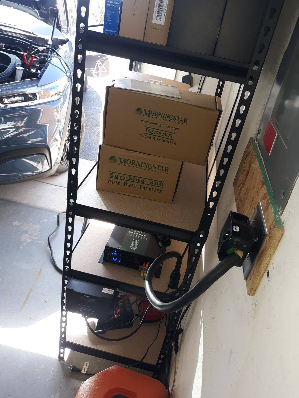

bi-directional charger will have to negotiate with the car to allow export via dc port....
existing 12v connection points can be used for export today, with no negotiation, by using a $300 pure-sine inverter.... limiting loads to 2000watts or less will enable the on board dc-dc to keep up for as long as the HV charge holds up.
Ford Mustang Mach-E Bi directional evse ? 220405 test powering house

As far as I know, the Lightening does not have a bi-directional charger.... Ford plans to pre-install an on-board 7kw Inverter, which is passed energy from the HV thru on board dc-dc converter. The 'available' inverter will have a NEMA 240v outlet, and a couple 120v outlets, which you could use for whatever you want.
As a work truck with towing capacity... this opens up the possibility of providing 'shore power' to a trailer/camper, running tools at a job site, running a house (after isolating from the grid), and powering a L2 mobile charger to export some energy to another EV.
We can do this same thing with our MME today, as long as we limit loads to less than 2000 watts since we have a smaller dc-dc converter than what is planned for the Lightning. Basically we could export to a L1 charger via an inverter and 120vAC plug.

My point is that is it POSSIBLE to backfeed to your home basically from any 12v connection points on any vehicle if you manually isolate the house first, and understand the max power your vehicle can export.
An typical ICE vehicle with a 'regular' alternator might be ok putting out 40amps x 12v = 500watts
MME dc-dc from HV to LVB maxes out at about 160amps x 12v = 1900 watts
and the Lightning appears to be specced for 7000 watts.
