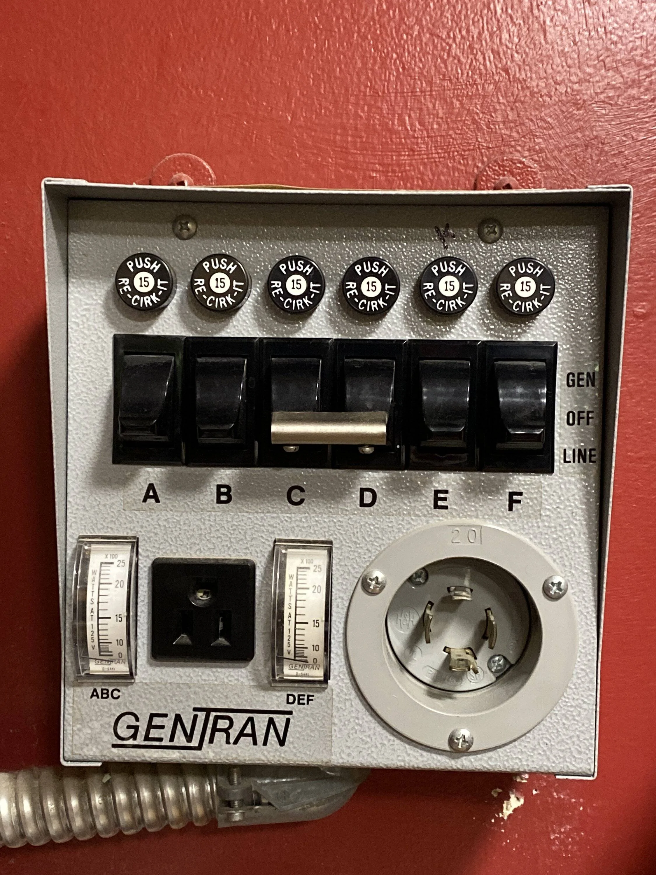

Grid-tied PV won't help you in Grid outage unless you have a hybrid inverter and built in transfer switch and batteries. But, with your EV you have all the battery you need!
As long as you are willing and able to follow simple procedures to isolate your house from the grid before using your EV as an Emergency Generator; you do not NEED an automatic transfer switch. All you really need is a little (1500watt) pure-sine Inverter for $300 or less, which you can energize via Jumper cables to your 12v connection points.
Then you can run extension cords to direct loads, OR you can fabricate male-male plug adaptors and 'backfeed' the nearest regular 15 amp outlet AFTER isolating from the grid and turning OFF your Solar circuit. If you backfeed one outlet on each 'leg' of your service panel, you effectively have 'whole house' backup.... but you MUST turn off main breaker, all 240 load breakers, Solar backfeed breaker, and all non-critical 120v loads to keep the maximum load well below 1500 watts if you are extracting energy from your MME.
*** Manual isolation, and use of male-male adapters with any Emergency Generator is NOT fool proof, and presents shock hazard if procedure is not followed. ***

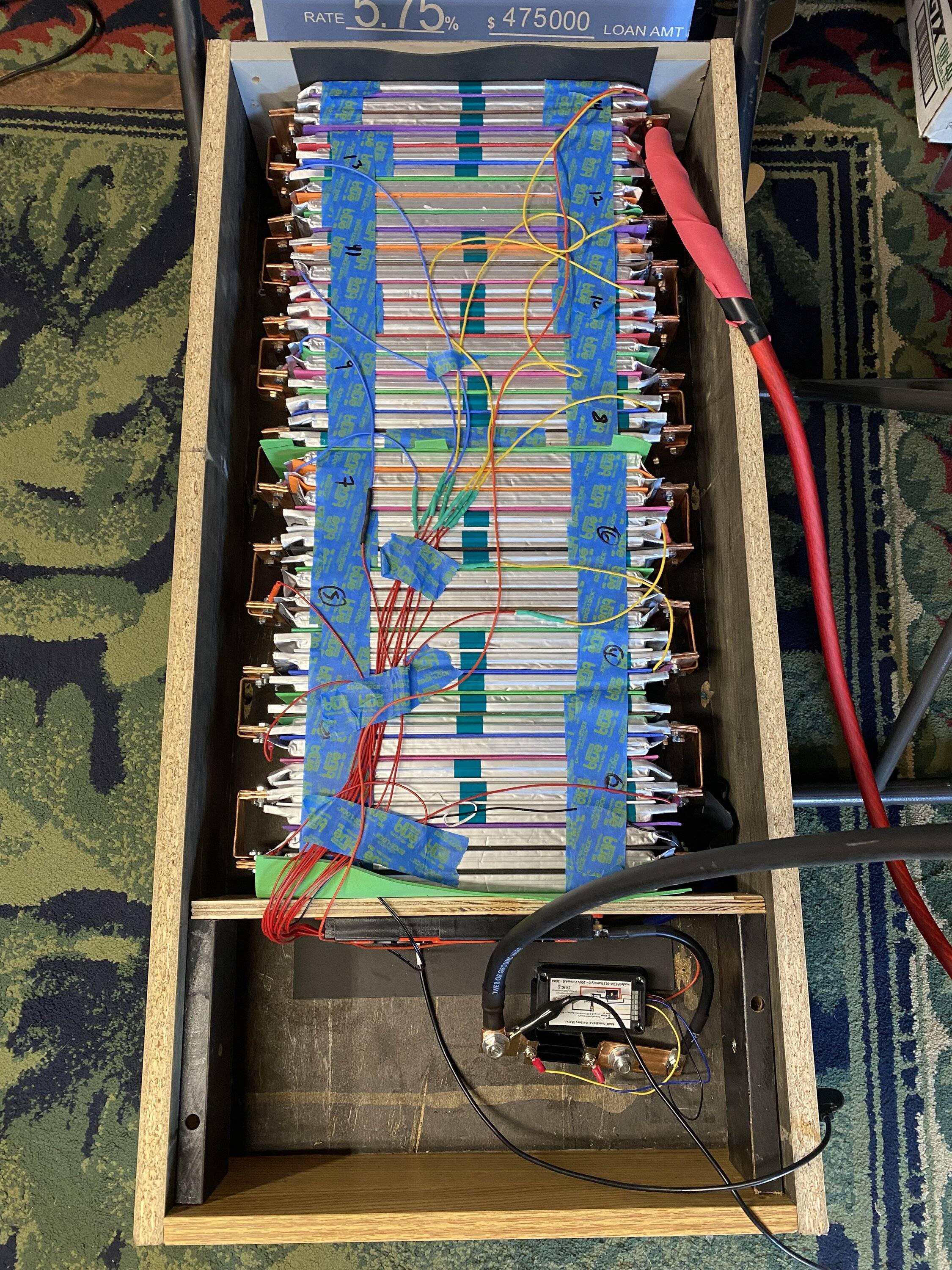

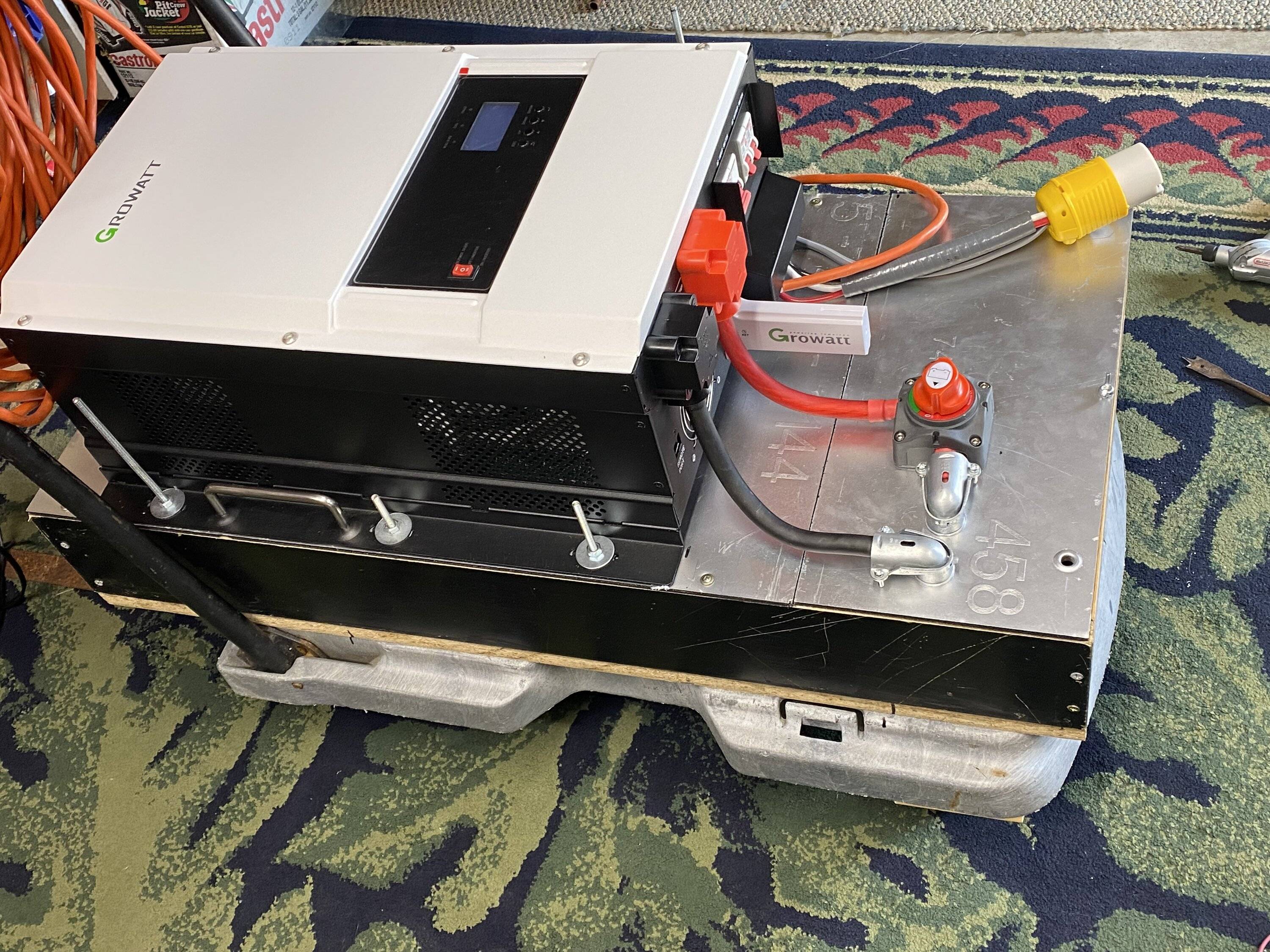

Cells from a MachE have powered my house during a power outage.
Ford Mustang Mach-E Bi-directional charging IMG_5670
Ford Mustang Mach-E Bi-directional charging IMG_5680
Ford Mustang Mach-E Bi-directional charging imag

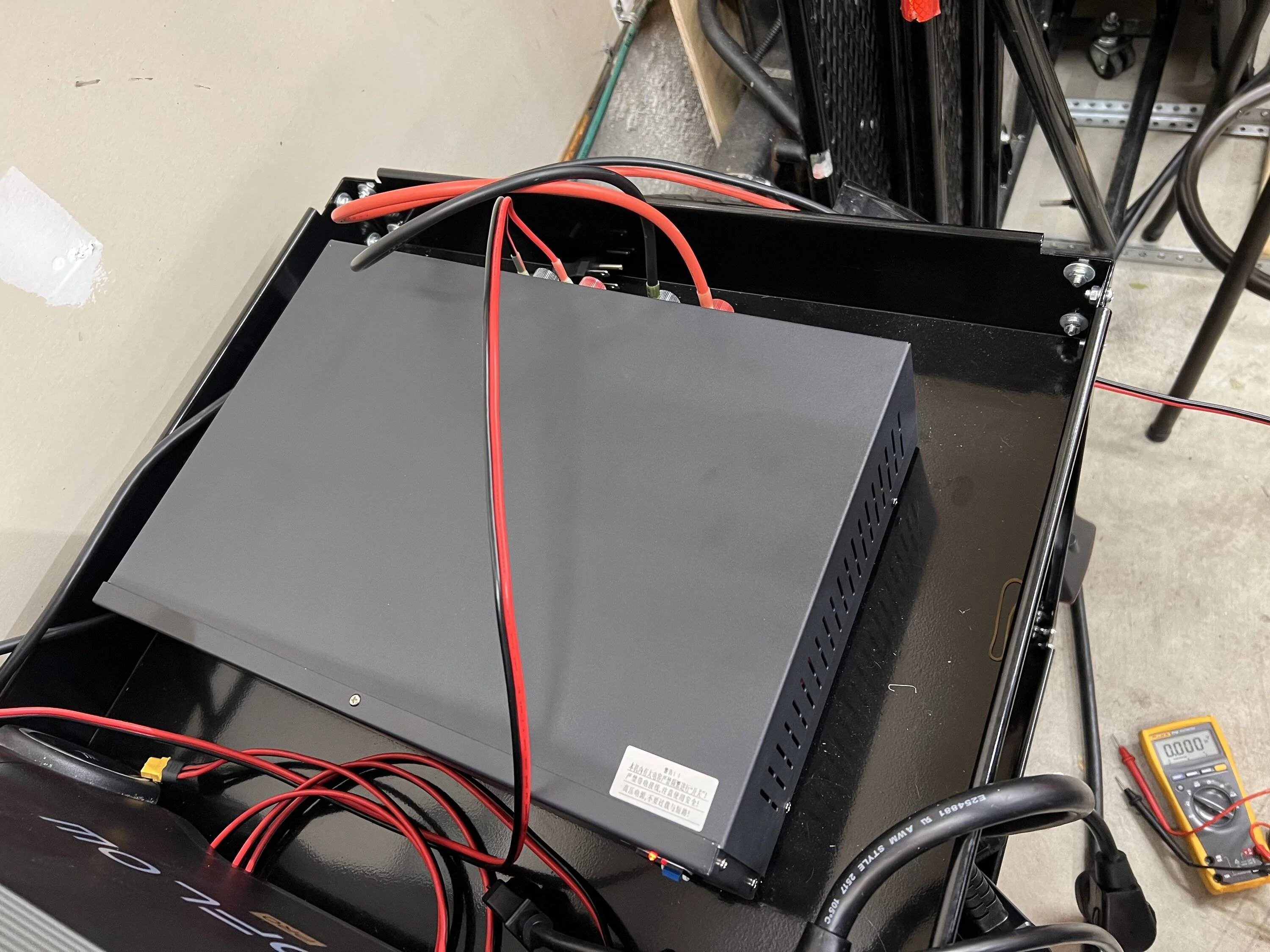

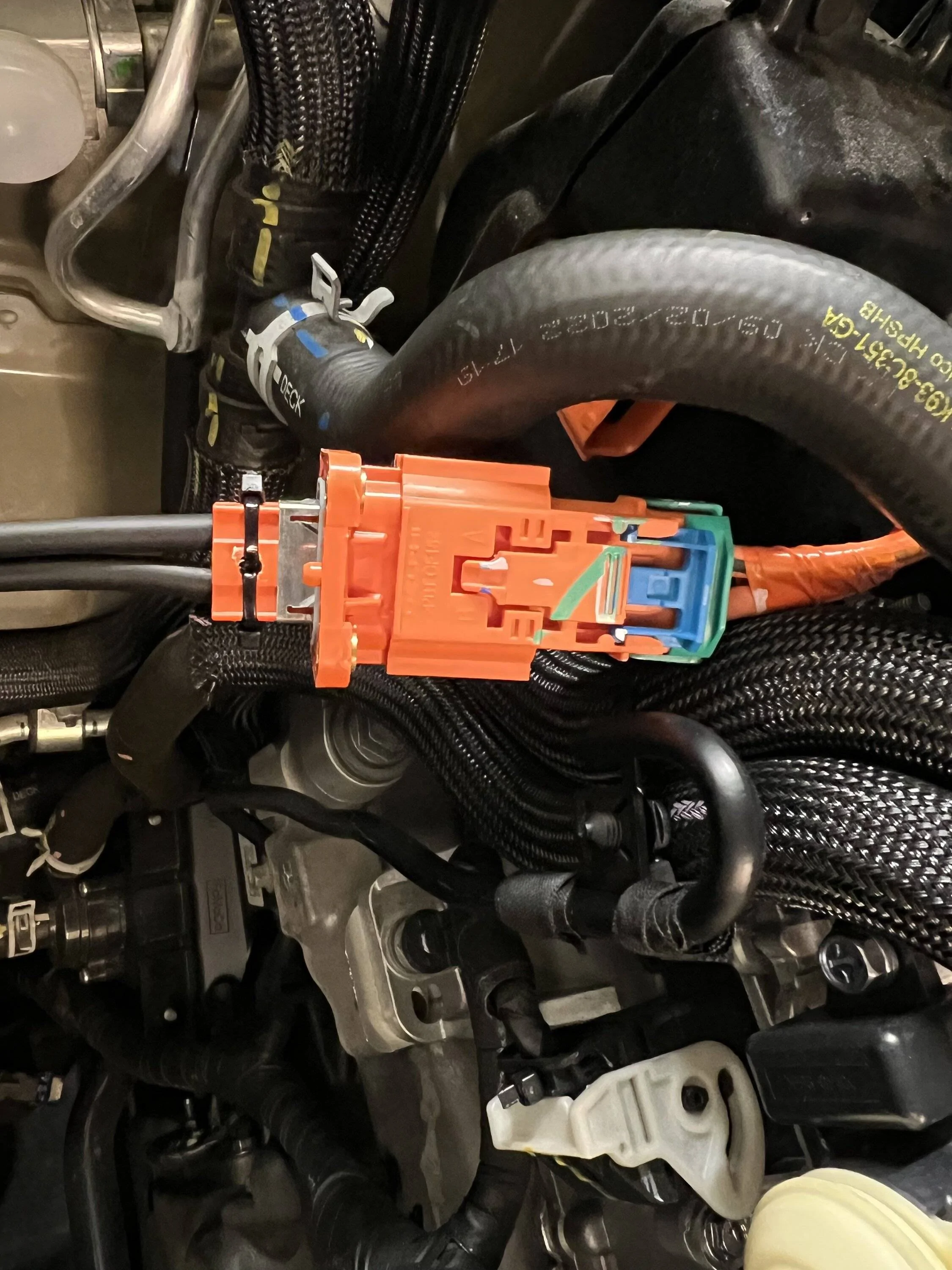

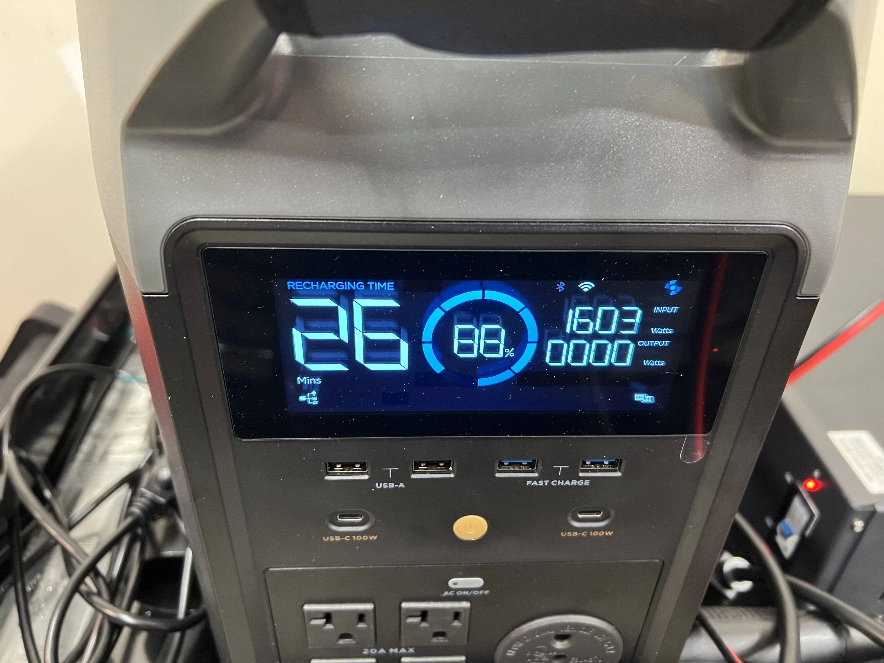

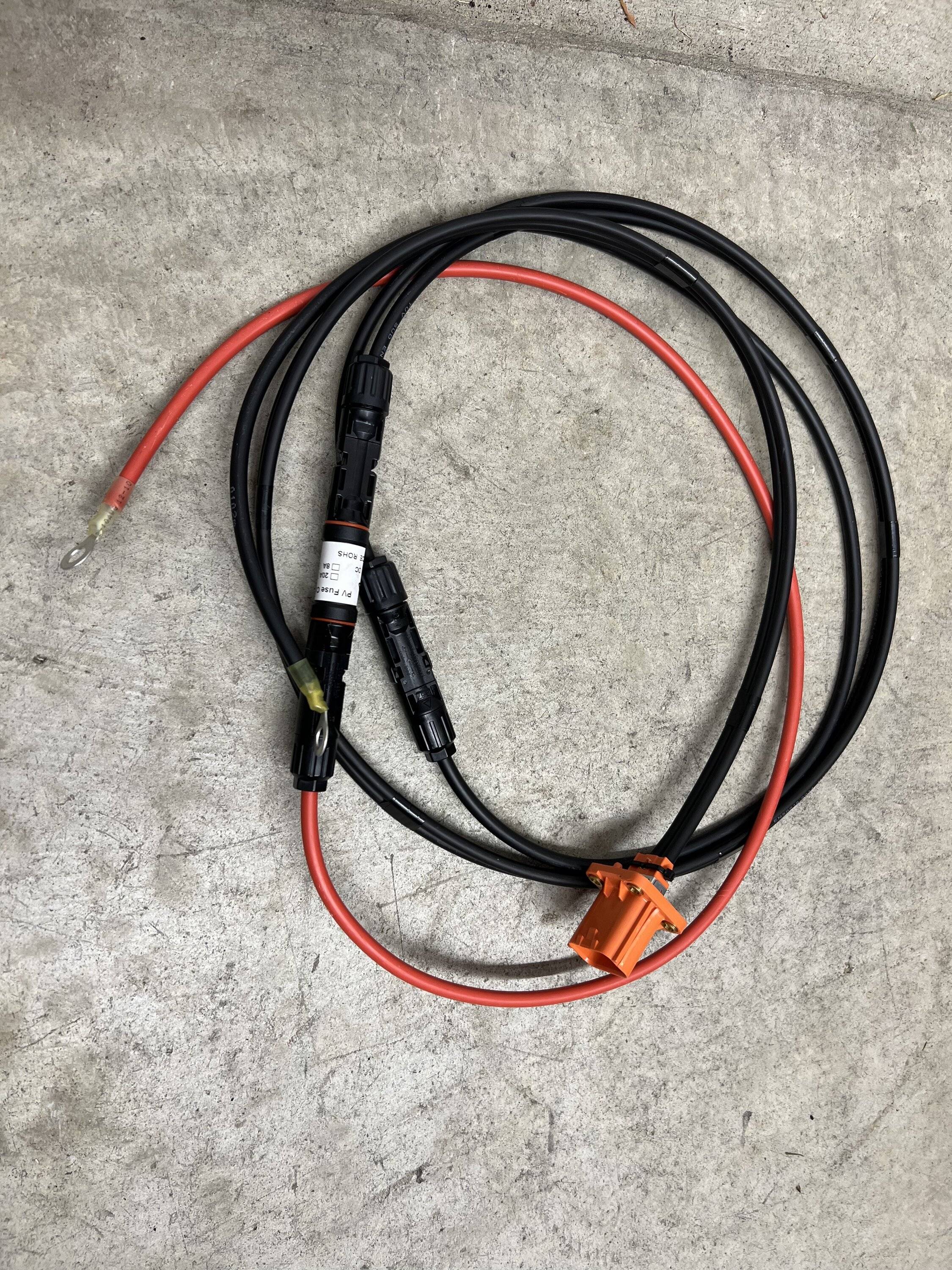

OR...a medium quality Chinese power supply and a custom made cable to connected to the AC Compressor circuit. Keeps the EcoFlow Delta Pro topped off while running the house. Is it dangerous, yes. not any more dangerous than a large PV system. 377vDC in, 110v DC out. Fused and cabled appropriately, it's fine. I'll be moving to a solar inverter that can take 500vDC of PV input instead of the Chinese power supply in the very near future.
where did you get the connector to make your cable?
there are TONS of 'all-in-one' inverter/chargers with charge controllers that accept <500vDC as PV input.
how much current can the AC compressor circuit carry? i.e. how much power can be exported ?
This is the exact connector and pins I ordered:
https://www.mouser.com/ProductDetail/Aptiv-formerly-Delphi/13830171 - Connector
https://www.mouser.com/ProductDetail/Aptiv-formerly-Delphi/13753471-L - Male Pins
It's not even the right connector, because one of the keys is slightly off, so i had to shave it down with a blade. I'm still hunting for the exact one. Still does the job though.
The AC Compressor circuit is protected with a 50A fuse inside the HVBJB. We'll say at 375vDC 50 Amps would be about 18.7kW, which is WAY more than I'd try to export from there anyway. I have my cable protected with a 10A fuse. Ideally, that would blow before the fuse inside the HVBJB. Otherwise, it would turn into an expensive failure.
With the EcoFlow drawing 1600 watts (~15A@110vDC), it's drawing a measured 5.3A on the HV side with power supply conversion losses.
Yes, I actually have a GroWatt on order right now. That'll let me input the HV DC as pretend solar and export straight to AC.
