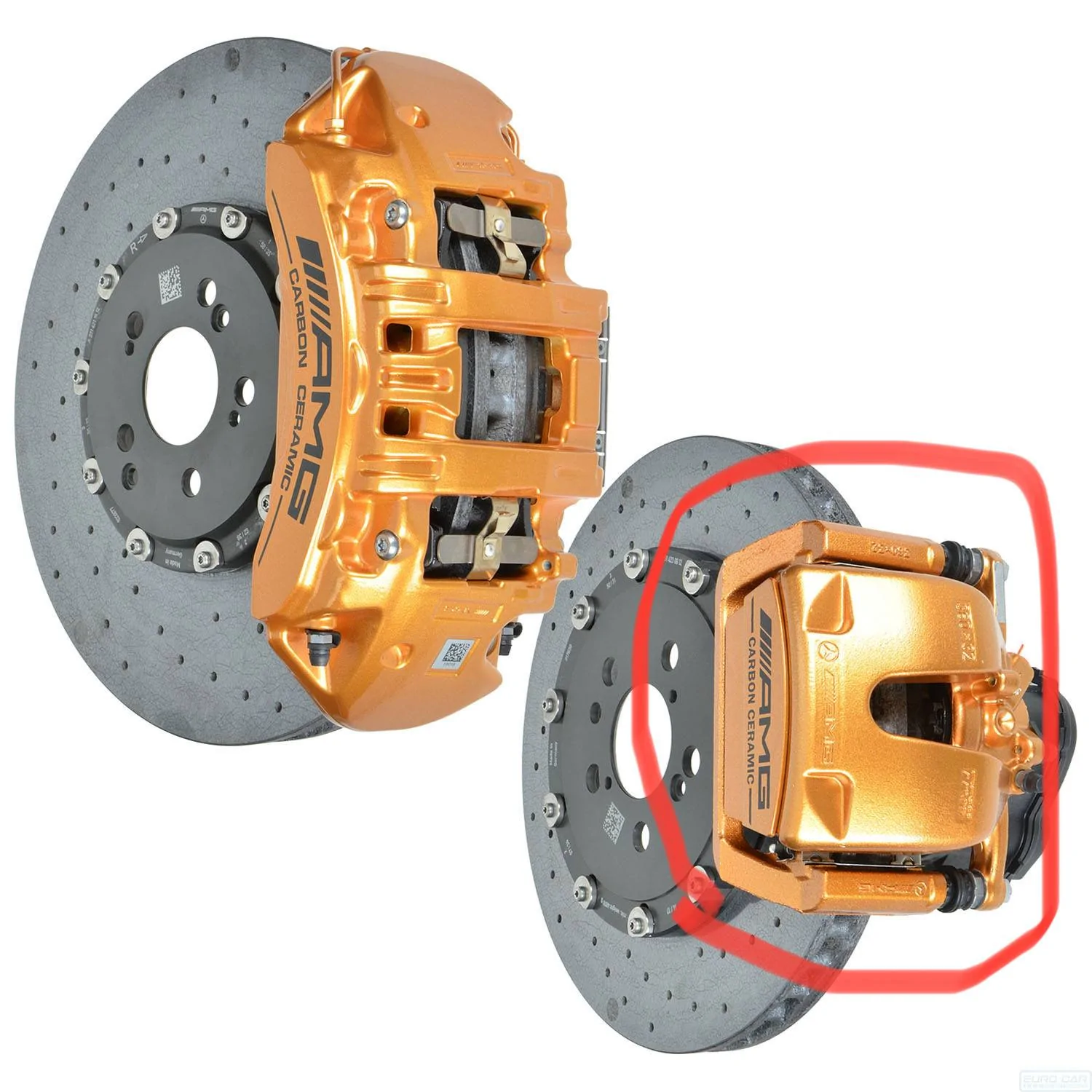

Btw, there are $200K + cars that’ll do near 200mph that have sliding rear calipers. Case in point, AMG GT coupe:
Ford Mustang Mach-E Bigger Rear Brake Calipers 5920FD94-B925-45E4-945C-77683DC60C6C
