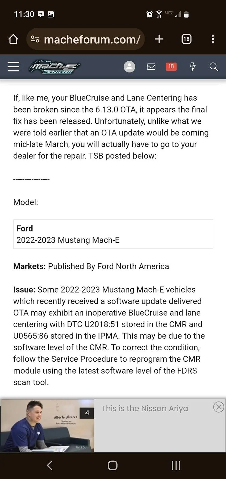

There is a CMR update (6.13.0) that broke BC for quite a few people. Another CMR update was released to fix it.

Mine broke after 6.13.0, but started working again two days later. I didn't see any notifications about software updates in those two days, so I can't fully explain how it was fixed.

Not sure when mine stopped working, but it was fixed yesterday. Other users posted TSB info last week along with the fix.
Ford Mustang Mach-E BlueCruise stopped working?!? Screenshot_20240331-233033_Chrom

My BC stopped working in January. Someone reported here that BC had stopped working since December. My BC is working again after the software update last week.

Wait, you're in Miami? Send me your VIN. If you have the update pending, I can fix it for you.

Oh how would you do it?
I have FDRS and a Mongoose cable to apply the update you need to fix the issue.
