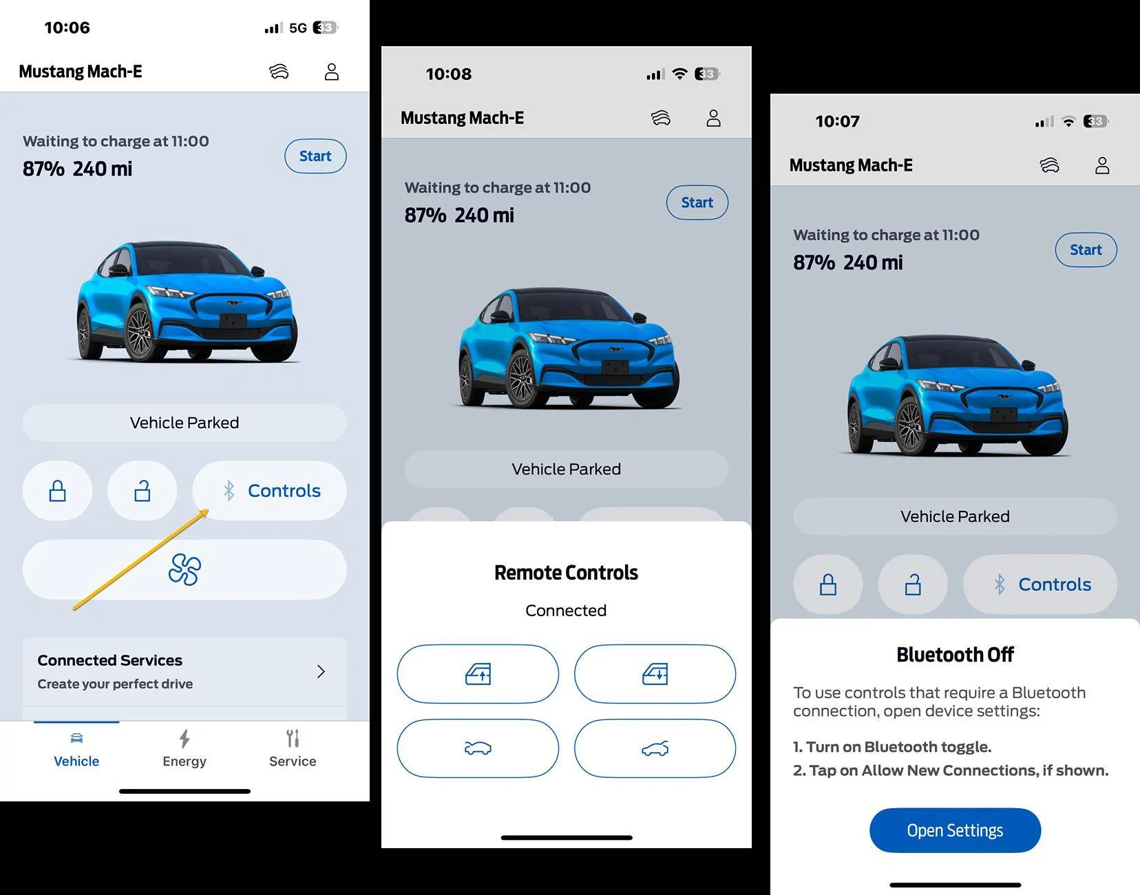

Did an experiment and here are the results. Note I was able to open the trunk from far more than the 30 feet but I did have line of sight of the car, so no obstructions.
In the picture below clearly the FordPass developers have indicated that Bluetooth is required for windows and f/t-runk. Everything else works without bluetooth.
Ford Mustang Mach-E Bluetooth expert needed. 1733069562679-z

This is getting silly. I never said you need BT to start or unlock your car. Those features don't use BT. Turn off BT. Open the REMOTE CONTROLS menu item in the FordPass. Try and open your windows or the frunk or tailgate. Starting your car, locking the doors does not use BT. Please let me know if you can open the Frunk from Fordpass with BT turned off.
I agree. My BT controls are frunk, hatch and windows also. Maybe something like this long range transmitter

I suspect that the reason the windows and f/t-runk are Bluetooth only is that the engineers thought you should be within visible range watching the results of the actions. Opening something isn't a problem but closing something could present a danger to pet or human. Though only minor.

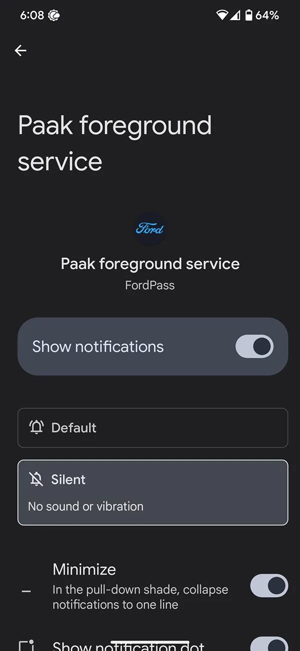

So a somewhat related question, I would love to be able to open the frunk without having to actually get in the car to do it. Is there a way I can connect the phone so the BT remote works but it's not set up as PAAK? I was getting notifications every 20 seconds that the phone was connected so I stopped using it as a key. Thanks.
If using Android, set the Paak notification to be silent and minimized. Don't turn OFF the notification, as this may reduce reliability of phone as a key due to your phone's energy saving heuristics.
Ford Mustang Mach-E Bluetooth expert needed. Screenshot_20241201-180839
I think that's how I had it set but was still getting connection notifications every 2 seconds. Maybe I'll try that again though. Thanks.
