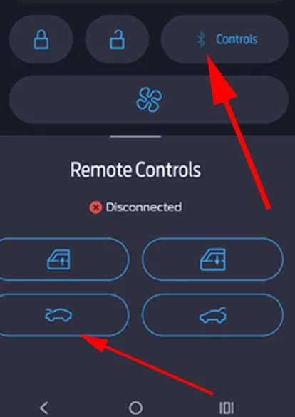

What??? Of course when it is connected to BT it uses BT. The point is when you are out of BT range the FP controls cant be operated. Disconnect your BT and try and operate your controls with WIFI or cellular.
Not sure if you figured this out yet, but that happened to me too. The “Remote controls” were disconnected. Couldn’t pop the trunk as I was walking up to the car. Even if I was up close. Seemed to be a glitch. I had to delete my phone as key, and re-sync the app. Super annoying, but works perfectly now!
You don’t need to extend the Bluetooth. Will work over cellular.
Actually the Remote Controls do not work over cellular. They only work under Bluetooth. There is even a BT symbol on the Controls button. Turn off BT and try and open the frunk, tailgate or windows using the Controls menu in the FordPass app. Please let me know if you can.

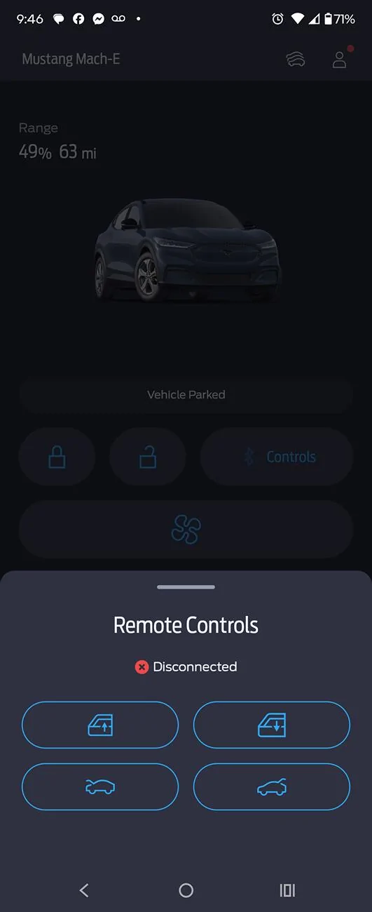

Open your Fordpass app. Touch Controls. If you are not connected to Bluetooth you won't be able to open or close your windows or the Frunk or tailgate with or without WIFI.
Frunk????via Bluetooth???
I must have misunderstood your question. I was simply suggesting a workaround that solved a problem I was having. My app appeared exactly like yours, saying the Bluetooth was disconnected. My BT was connected, but for some reason the app wasn’t recognizing it.
