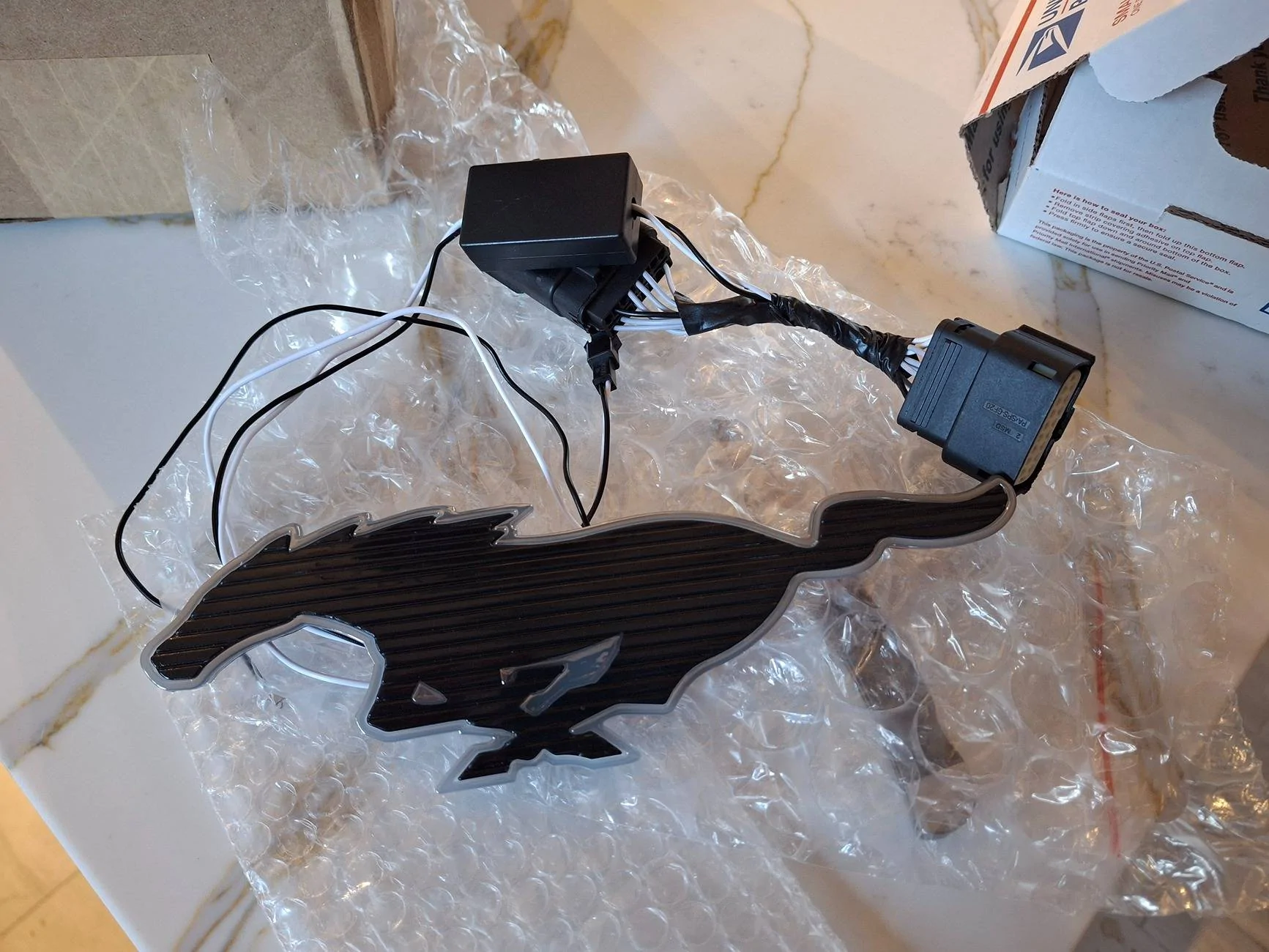

Hi Jeff, I just started installing the front pony and ran into the same issue. Fortunately, I haven’t applied the adhesive or installed the caps yet—I wanted to test it first. On my 2022 Mach-E Select (low type lights), the emblem doesn’t light up. I connected the wires white to white and black to black, pushed them in until I heard a click, so I assumed the connection was solid. Let me know if you’ve had any luck getting yours to work or if you found a solution
I tried for literally hours. Double checked everything all connections. It’s a pretty straightforward install not hard. But I couldn’t get it to work. I’m sorry you had the same problem! Very frustrating,I was looking forward to it for months. I tried everything I could think of and couldn’t get it to light up.

Jeff, sorry about this issue. I have no idea what is going on since I am only shipping these out. I will have to ask Bruce but what I can do is when I return in a couple of days, is connect one up in my car to see what I get and try to figure out what the issues is if it does not work. I am sure we will get to the bottom of it.

Ford Mustang Mach-E BSKT Design LED Ponies 1000013992

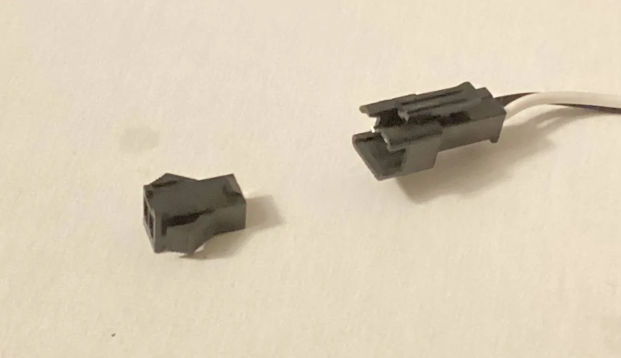

Hi Jim, in my case, the connector was already secured to the wiring harness, and the pony emblem just had the crimped wire ends. I’m guessing the connectors are kept with the harness since they’re easy to lose. You might want to check your wiring harness to see if the connector clip is already attached there.
Thanks and it is exactly as you describe. I surmise the didn’t attach the connector to make it easier to feed the wires through the hole. I haven’t started (or even determined when I’ll start) the surgery yet because, honestly, it scares me.

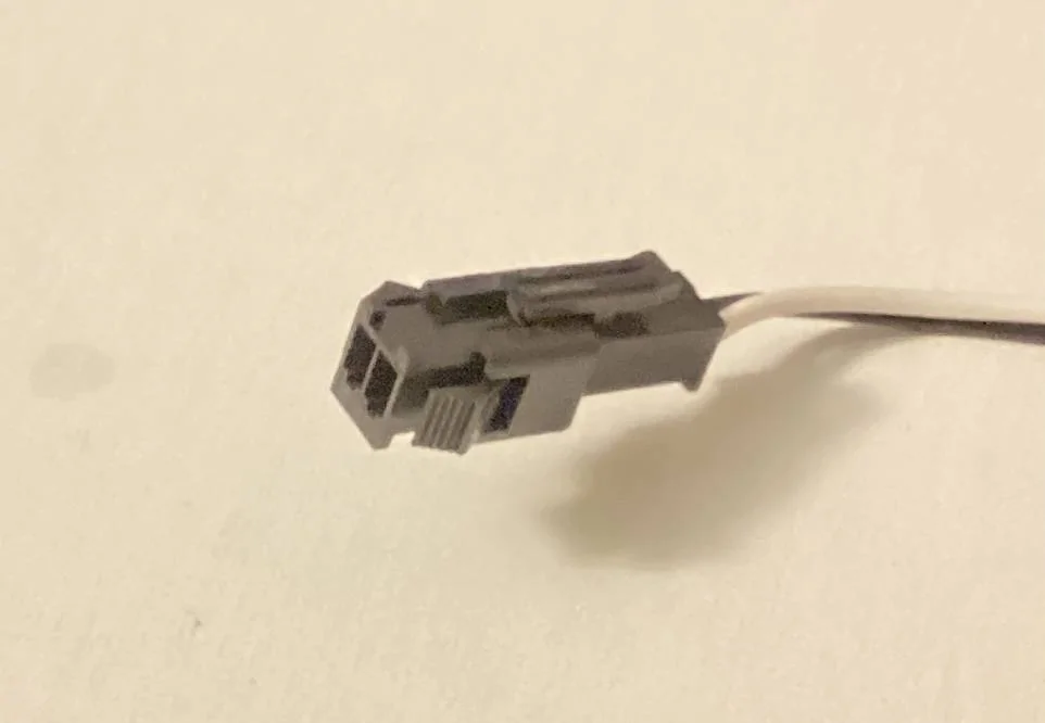

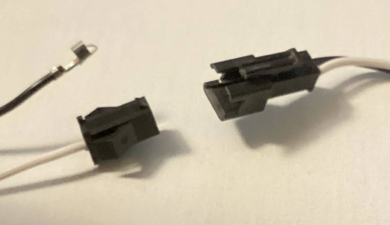

There is not an issue. Please stop cutting the wire.
BSKT ships the pony with the blank male Molex connector inserted into the female Molex connector After you thread the wires through the front bumper, then take the mail housing and insert the wires. They should go in with minimal effort.
Then you can snap it into the main harness. Trying to insert the crimp with the 2 parts of the Molex connect will be difficult and could cause damage.
Excellent! This is what I surmised!
