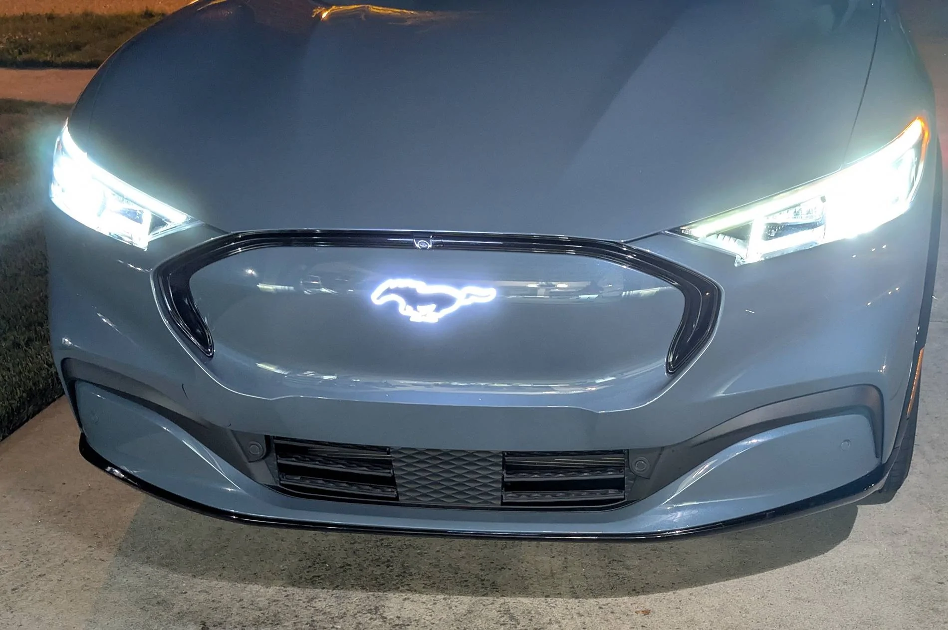

I was able to successfully install the front pony this evening... But I did have an issue with the wire being too short making connecting it to the splitter harder than it needed to be. And when trying to move it out the way so I can reinstall the frunk... the tab on one of the connector broke off causing the wire to fall out...I just taped it to the other wire and hope it stay put (it won't but that's future me problem)
It was too hot out to do the rear but the hope is to do it tomorrow evening and hope I have an easier time with wiring.

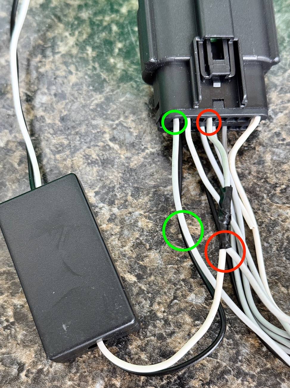

Ok, everyone, Bruce found the issue with some of the front ponies not lighting with the "high" headlamp connectors. He has not looked into the "low" headlamp connectors yet but will do so soon.
Some of the "high" connectors had a wire that was mis-wired.
For those that want to fix it themselves, look at the photo below. If you would rather have a correctly wired connector, let me know and will send one out to you.
Below is a photo of the "high" headlamp connector. The little black box has a black and white wire coming out of it on one end going into the connector. On incorrectly wired connectors, the white wire coming from the black box is connected to the wire circled in red. It should be connected to the wire circled in green. You just need to move if from the wire circled in Red to the wire circled in green.
Ford Mustang Mach-E BSKT Design LED Ponies IMG_5521
One note, that little black box is a voltage reducer for the lighted pony. DO NOT connect the pony directly to 12V as it will burn out the LED's.

I’ve confirmed mine is incorrectly wired as per the above diagram. Before I go screwing with relocating it I just want to confirm that this is the fix for it not working correctly. Please advise asap.

Thank you! I told you this before the forum is lucky to have you and so is Bruce. In my hours of screwing around with the pony I broke off the connectors on the pony like Gungrave223 did. That’s on me should have just messaged for help and waited. But patience sometimes isn’t a virtue I have.
Yes Mark, that is the fix as per the photo I posted.
Thanks for the follow up (Mark and Bruce). Interesting about the black box. If the front pony needs a voltage less than 12v, what about the rear pony?
This is 2 mis-wires in a row. BSKT really needs to invest in a simple go/no-go test fixture for the harnesses.
The rear pony does not need a voltage reduction as it uses 12V LED's. No black box.
Yes, I think Bruce is overloaded with all he has to do. Feel bad for him but at the same time these things should not happen. Not to mention, the European and Chinese connectors are also different from each other and from the US. ?
