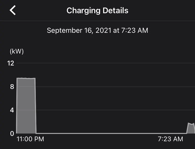

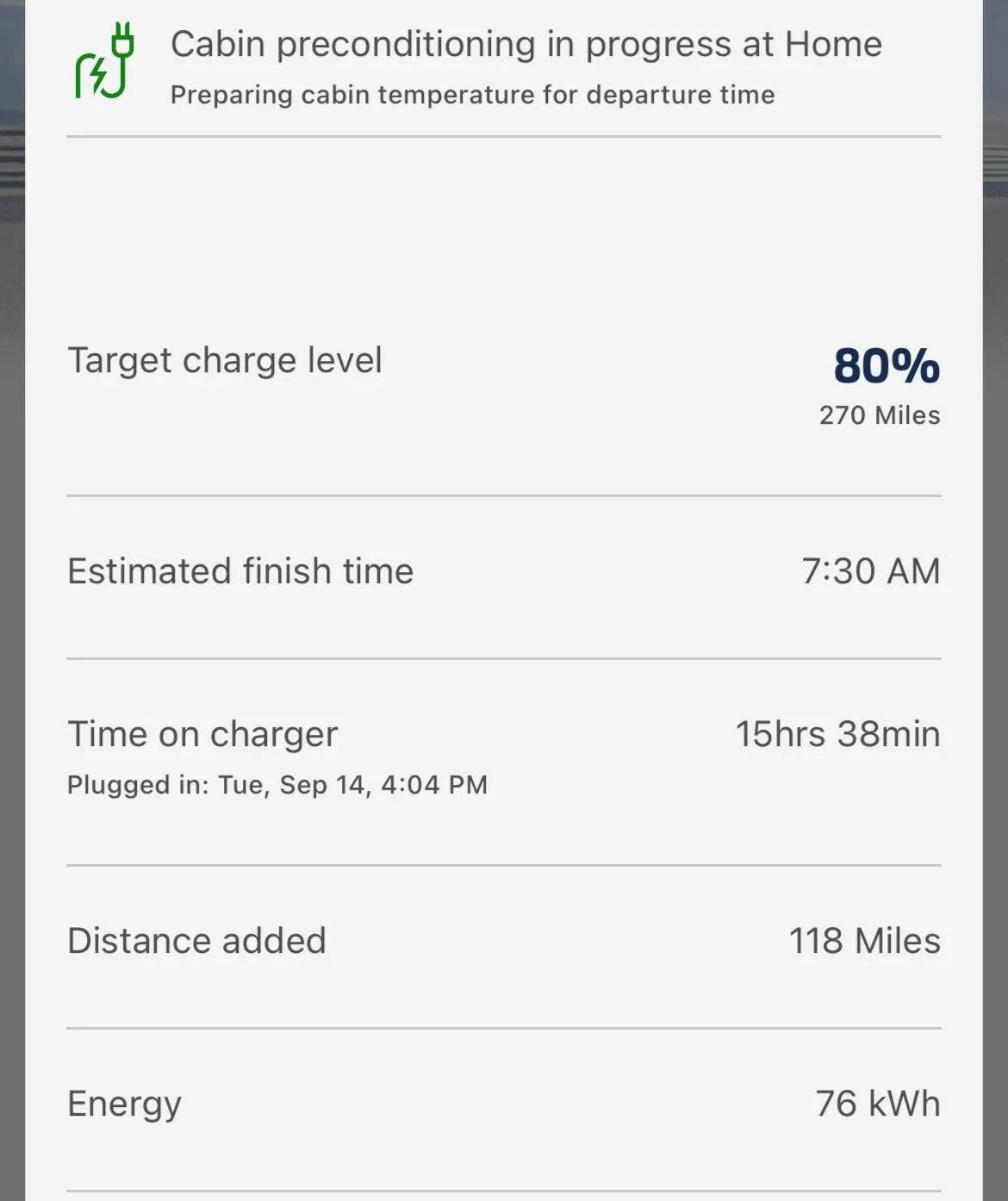

Here’s my precondition session from this morning (set to warm) on the right compared to the normal charging at night (9.4 kW) on the left.
ChargePoint Home Flex 14-50 plug in on 50 amp circuit.
I just noticed that Chargepoint is not showing active charging when I walk into my garage and the car is preconditioning. Car charger is scheduled to charge between midnight and 9am for local public service plan and my preconditioning often occurs outside of these times but assumed car was drawing from my home instead of car battery. Not so.
I just checked with Chargepoint and their response was to do the "double pump" override. Very impractical for detached garage in winter weather.
Any peeps with Chargepoint want to chime in here?
