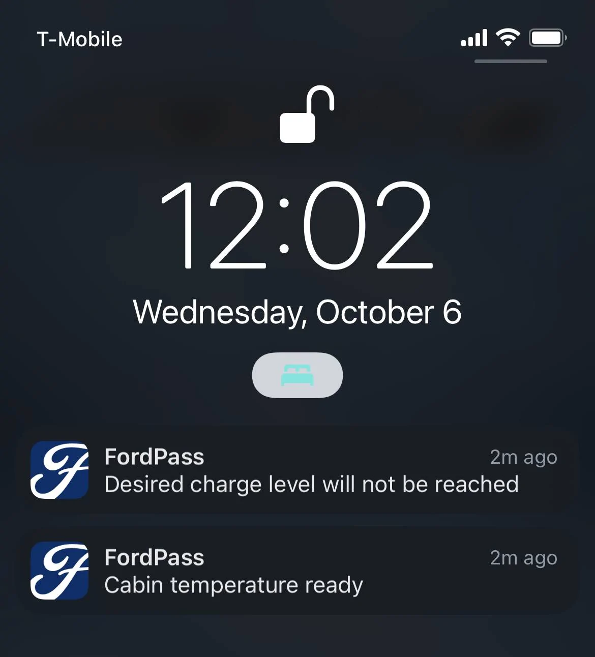

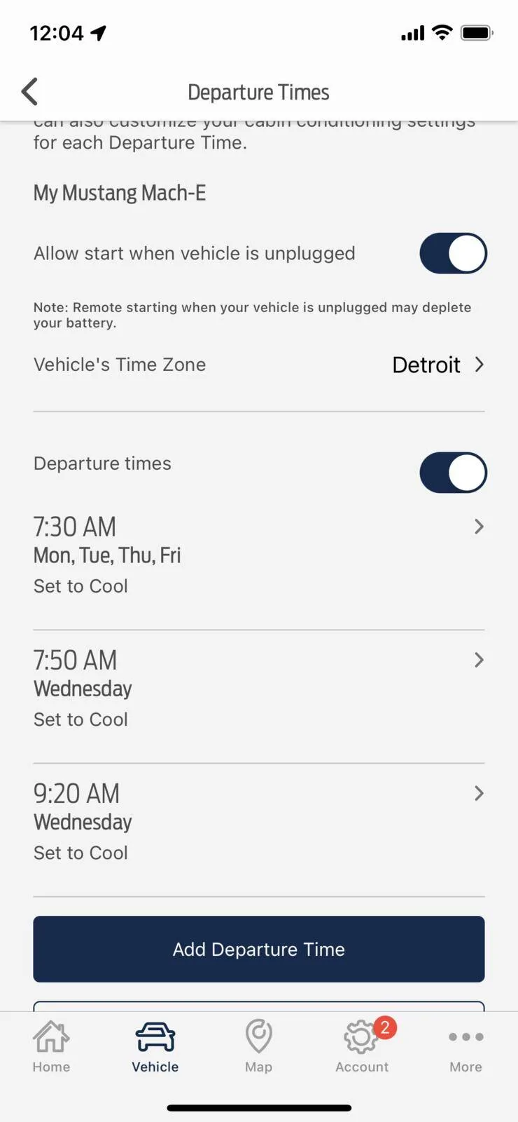

As you can see from the screen shots below, my car for whatever reason, wants to condition the cabin at MIDNIGHT! Never mind the Detroit time zone, that is just another wonderful added bug for this software. Even if it was actually using Detroit time, it would not be conditioning now as my time is 07:50 PST.
Just for giggles I actually went out to my car to see if it was actually conditioning or if the software was just reporting incorrectly like it does typically. Nope, sure enough, its out there making all its racket and the cabin is pumping in cold AC.
I'm getting so incredibly annoyed with this car's software. Its at the point now that I don't even know what its actually doing half the time and you can't rely on FordPass to show correct data. I'm almost to the point where I'm not going to even bother plugging it in because I don't want it to go rogue and pull during $0.70 peak hours which is incredibly inconvenient. My only other option is to get a smart charger, at $600 bucks, all because Ford can't get their act together. It's no different than being being forced to buy a second fob because PAAK is jacked. Its absurd...
Why..... Am I missing something??

I connected my FordPass account to the Shortcuts app on my iPhone, then created a shortcut to remote start at specific times only if my phone is connected to my home wifi or work wifi. I got tired of my car turning on when I didn't want it to... ie in the airport parking lot, wrong time zone, etc. Also, my car wouldn't precondition if it's plugged in for some reason.

This is an example of the charging conflict errors. Recorded this after dropping my kid off at school this morning. Dunno why it thinks I’m going to lose percentage lol. This is one of the two errors I get every shut down. The other one is the pretty long error message.

Random ideas that may or may not be helpful:
Is AM/PM set correctly in the car? Try changing it to 24 hour time. Toggle automatic time zone update on and off.
Are charging locations turned on? Does it actually say "At Home" on the screen when you're at home?
Try setting the charge window so it doesn't cross midnight. Like 1 AM to 7 AM. Set a second window 9 PM to 11 PM (adjust for your demand times).
Set the charge settings and departure times in the car rather than the app.
If all else fails, disconnect the 12V battery for 15 minutes to reset everything. Personally I'd be bringing it into the dealer for manual software updates.
