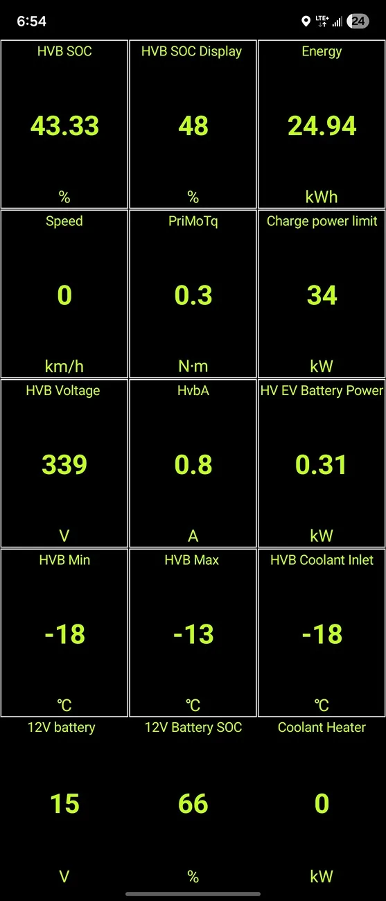

Ford Mustang Mach-E Cabin heating problem on my 2021 model. 61792
The coolant heater is 0KW which explains ice cold air from the vents. The surprising part to me is it actually reaches to 4.8KW while temps are above -15C or so. However when it extreme cold and car sits umplugged for a couple hours, it starts blowing cold air with 0KW heater reading.

Yikes, that's one cold battery! Only about 24 kWh available at 50%. Surprised it's not going into turtle mode or displaying errors.
Yes, I would take it in again for heater replacement.
