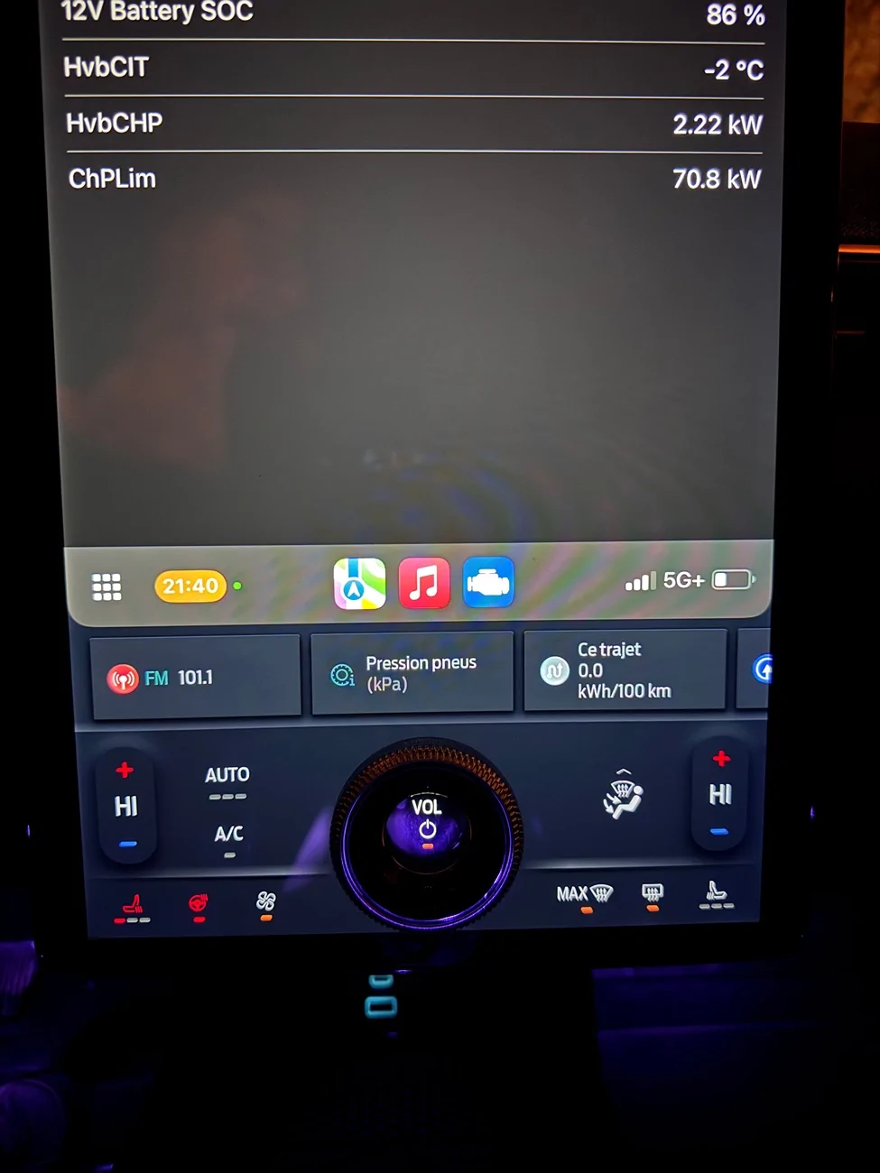

I'm at the beginning of my fifth winter with my 2021 Mach E. A new problem has appeared with the arrival of the cold weather (Canada winter ;:)
I have a feeling it's a problem that appear after a software update.
Here's the problem:
If the car is started with remote start via Fordpass, when I get in and drive, it produces almost no heat.
CarScanner shows a maximum heating output of 2.22 kW.
If I start the car normally without remote start, or if the remote start cycle has finished and the car has been off for a few minutes before I start it normally while in the car , the heat seems to be the same as in previous winters.
In this case, CarScanner shows a heating output that varies between 3.80 and 4.88 kW.
Are others experiencing a similar problem?

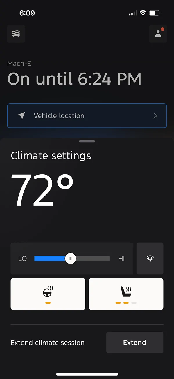

What temperature do you have the HVAC set to in FordPass? And how cold is it outside?
The heater will not run full blast unless you turn it all the way up or it’s extremely cold outside. An output of 2.2 kW is probably normal after it’s been running a while.

@Mach-Lee outside temperature between -3C and 1C degrees. Inside temperature set to 22C. Real temperature inside from Car Scanner around 11C. The cabin no longer heats up and the air that comes out is cold.
Whether the heating is on auto or MAX, never more than 2.2 kW if remote start, whether it's right after starting or 20 minutes later.
If I stop the car for a few minutes and restart it without using the remote start, the heat immediately starts coming out again; the power is around 4kW until the cabin temperature is close to 22C.
If the car is completely cold and I don't use remote start, the heating power is normal around 4kW and the temperature inside the cabin easily rises to 22°C.
This is my fifth winter with the car and the heating has never behaved like it is now.

I would say suspected heater failure, MAX defrost should produce an output of around 5 kW. You can also look at engine coolant temperature B, that is the output coolant temp from the heater. Should be above 45°C, 60°C would be typical in a defrost mode.
Thanks, I'll look into it.
What I find really strange is that, following other tests today, the problem only occurs when I start the car with FordPass and it's not plugged in.
If it's plugged in when I start it with FordPass, everything seems normal, just like in previous winters.
