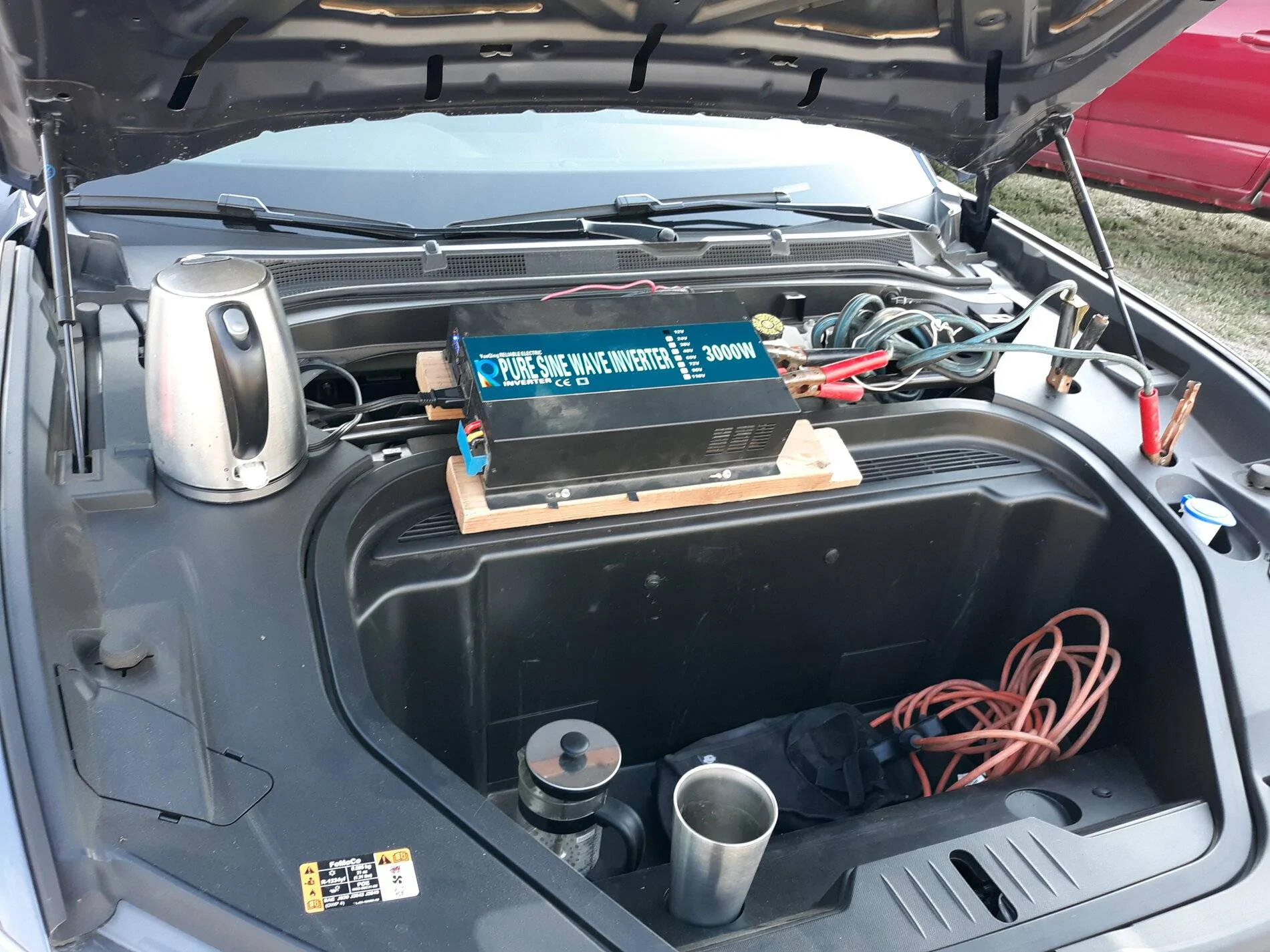

I also brought along an inverter and teapot to see if I could make coffee and consider 'flameless' cooking in the future. Jury is still out on that as I had to turn the MME 'on' and disable the 10-minute auto-off to get the HV dc-dc to send full power to the 12 connection ports. I need to do a little more testing as I got it working one morning, but not the next.
