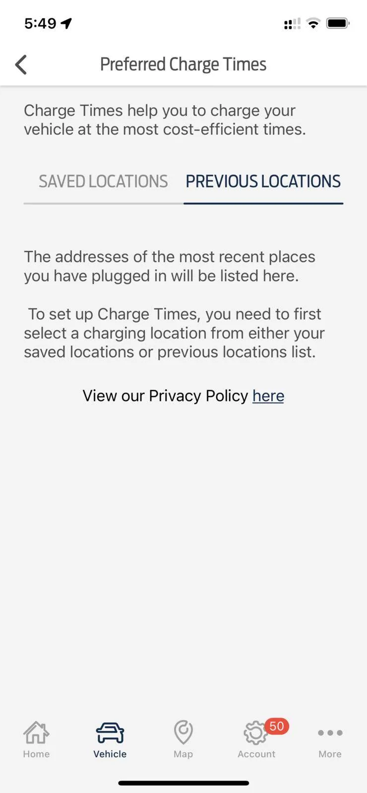

What I haven’t seen mention of elsewhere is this: car arrived with full charge, so my first charge at home was Wednesday. My phone (without PaaK) didn’t recognize the location (I assume because I had never charged there before) and so I wasn’t able to make any adjustments to the charge level or the time of charging from my phone. Would I have to get back in the car to do that?
From the car I cannot set any charging preferences either, because that line in settings is greyed out. From my phone the charge session shows up in the logs but doesn’t show up as a previous charging session, so again, I can’t seem to adjust the level or time of charge session, or even set my home as a charging location. The screen with “Preferred charge times” doesn’t have any locations listed and says I need a location saved. Where do I go to set my home as a preferred location?

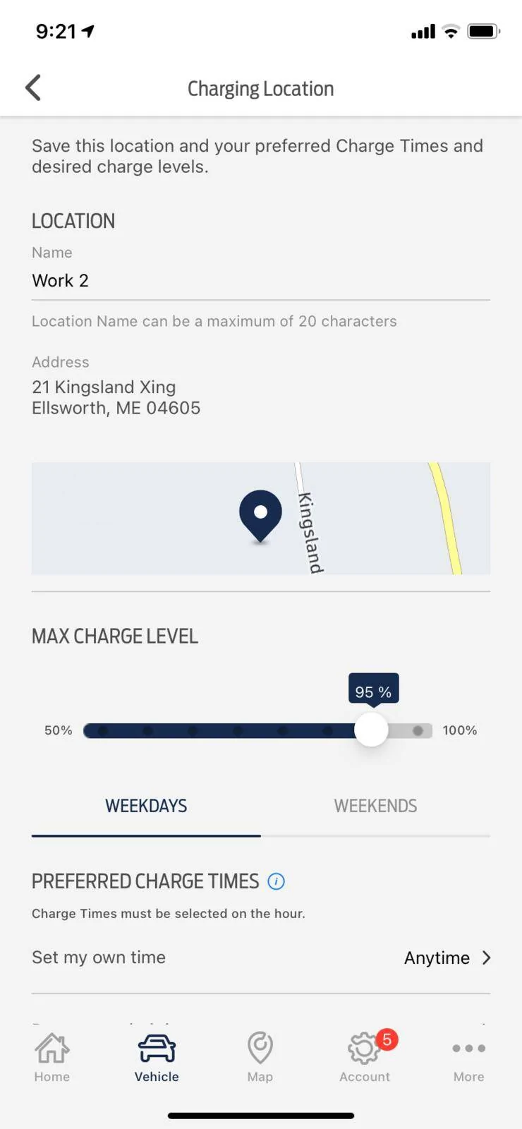

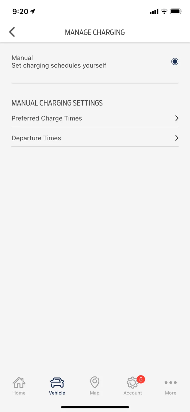

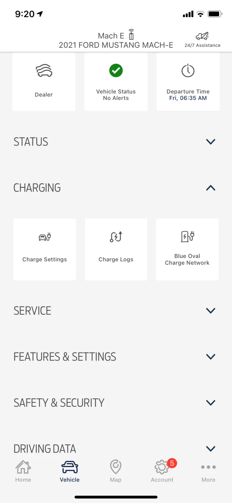

Use Fordpass on your phone to configure charging. It's quick and easy. Be sure to use preferred settings and SAVE the charging locations with names.

Thank you for your detailed reply! My problem is that I don’t have any locations to save. I charged last night, too, and I still get this:
Ford Mustang Mach-E Can’t program to stop charging at 80%? 124F9C2B-99FF-42B8-9A8C-EE35A33433D0
Again, the charging session shows in the log, but there isn’t, best I can tell, a way to make my home a charging location because it never shows up.

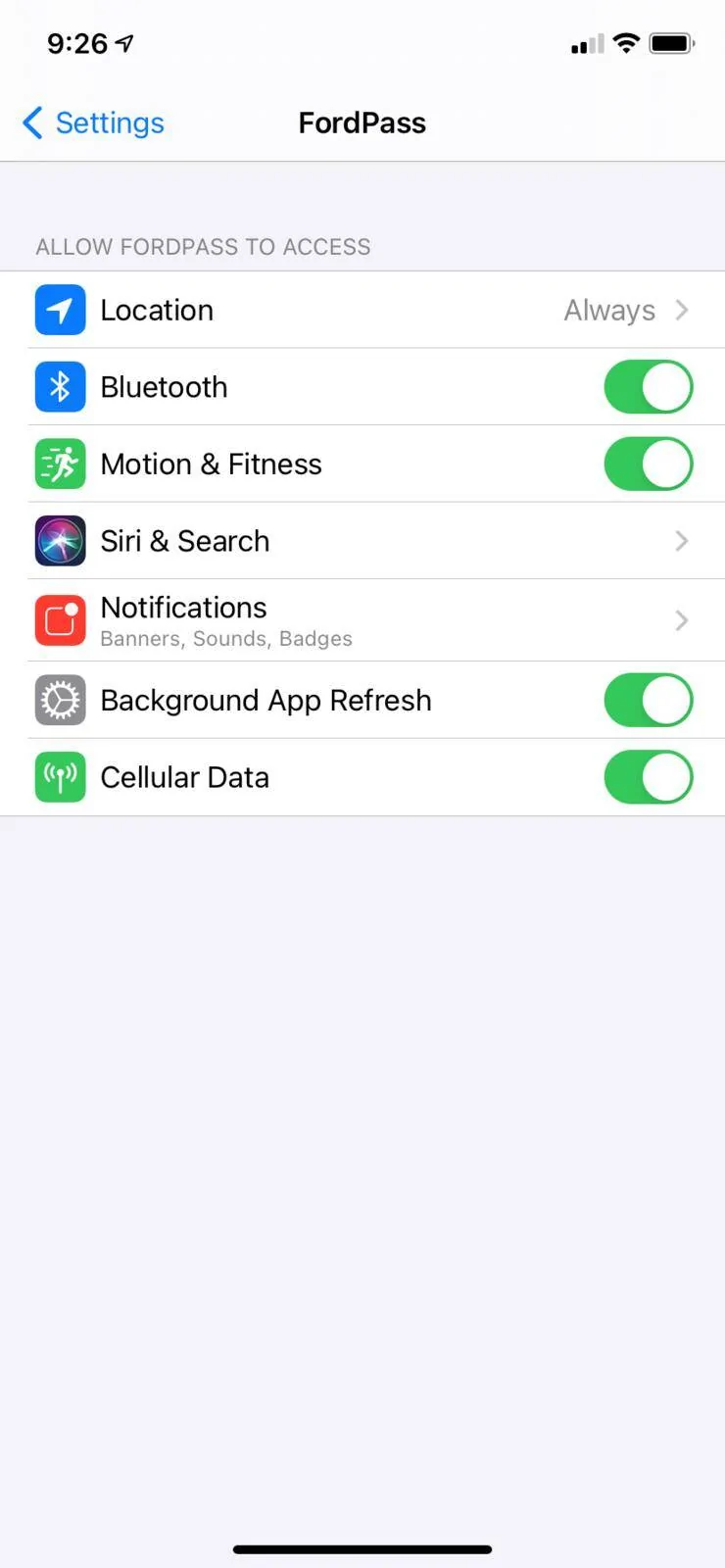

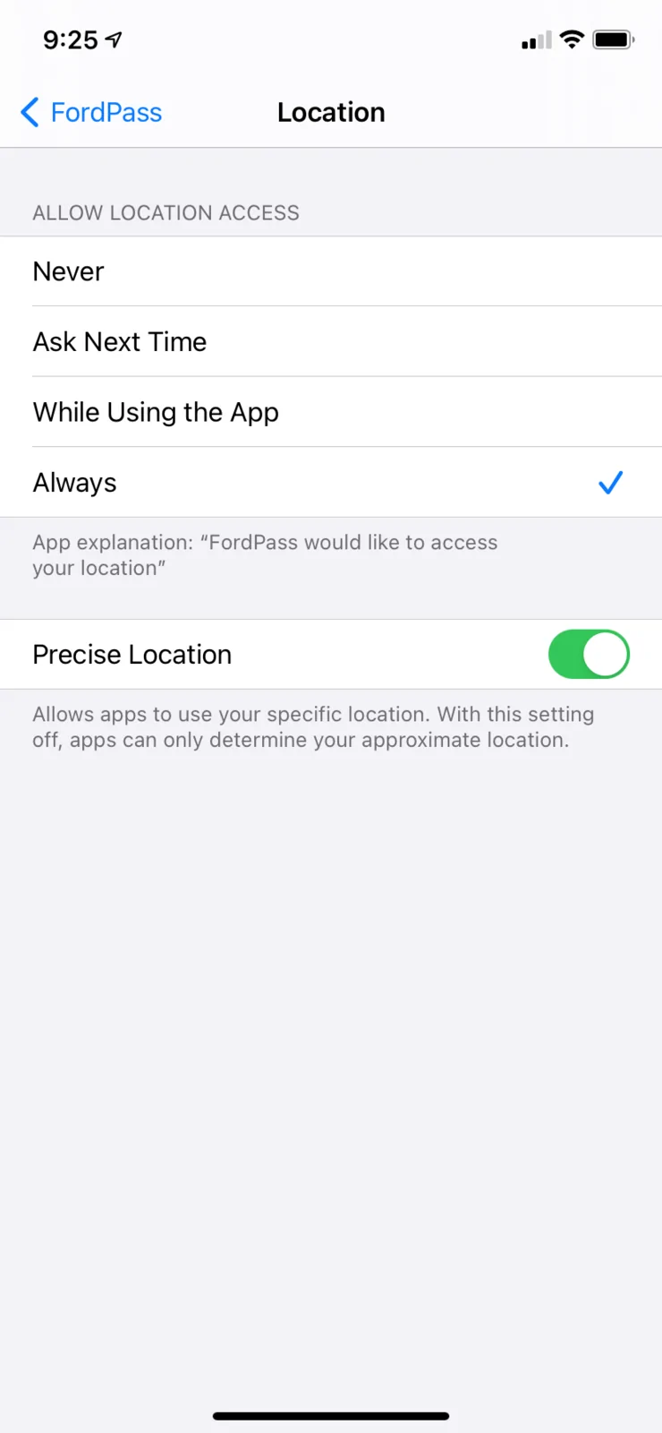

Is your "share locations" or “location services” turned on, on your phone for the Ford Pass ap? Everywhere I charge, I get the exact location listed.

Everything is turned on. I have notifications that tell me we are all charged and ready to go, but no way to save the charging location. I’m stumped.

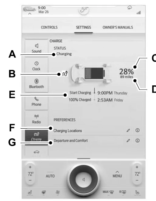

I wa able to set all this up in the car, using this page to create a home charging location (F).
Ford Mustang Mach-E Can’t program to stop charging at 80%? 1636553680485
Not sure why that would be grayed out for you. Also I found I had to create a Home location for the Navigation first, in order to reuse that name for home charging.
