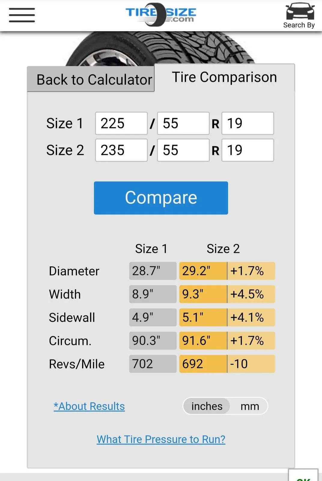

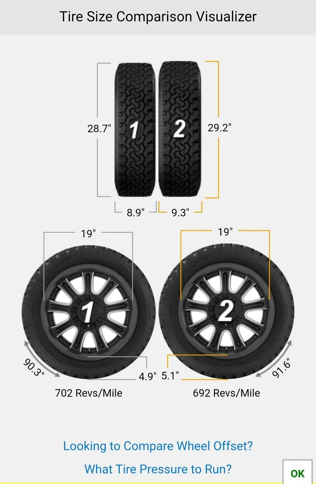

I recently just swapped out the stock tires on my MME4X for some 235/55/R19 Michelin CrossClimate2 tires, and I'm wondering if anyone knows if it's possible to reprogram the car so that it knows the new tire size?
The new tires are slightly larger diameter so this will have am impact on the speed, odometer and efficiency stats, and I would really love it if I can keep that info as accurate as possible after the change. Does anyone know if this can be done from with the vehicle UI via a hidden menu?

Circumference is the only factor to consider re the speedo. A 1.7% change at 60 mph is 1.02 mph. The tire is getting larger, you're going to be off 1.02mph (reading 60 instead of 61.02mph).
A cool excersize, but given that tires change circumference with temperature, wear, air pressure, etc. anyway with nobody noting, I'm not sure I'd bother.
