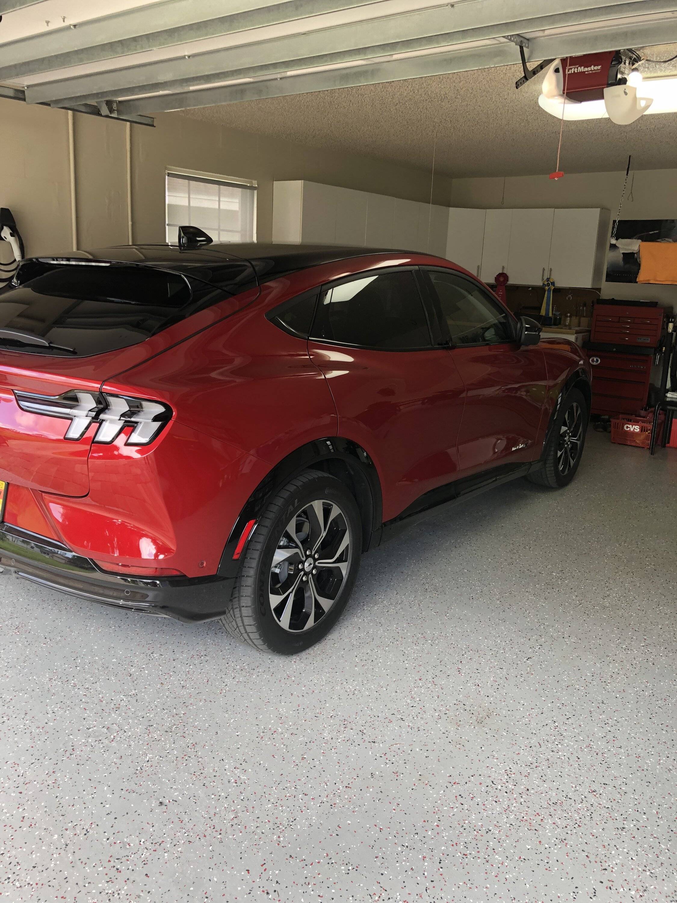

On my Premium eAWD ER I put the 245/50RZ19. The revs per mile are 724 & 723 (one is OEM tire and other is the 245. I used the Continental ExtremeContact DWS06 Plus which is rated as a 105Y in XL load. Very pleased with them.
Ford Mustang Mach-E Odd tire size B2517D1D-893C-47C4-9C49-598D0BCC511F
This is the exact tire I was looking at and according to the tire site would fit. Any impact on your range?

Probably but I can't really quantify. It is likely very small. There is a post from some science nerd that stated this change is minimal and that we were likely to take a bigger hit if we swapped rims. This car handles excellent with these. And they flat out look better than the OEM tire. Read the ratings on them at Tire Rack. The best all season UHP (Ultra High Performance) tire. I did not want to change rims thus, these are the best option. Very quiet.
