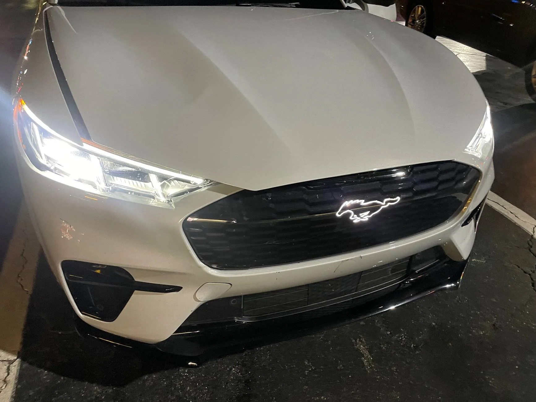

Adding a picture of vehicle that was stopped in front of me after accident. Wasn’t at any speed.

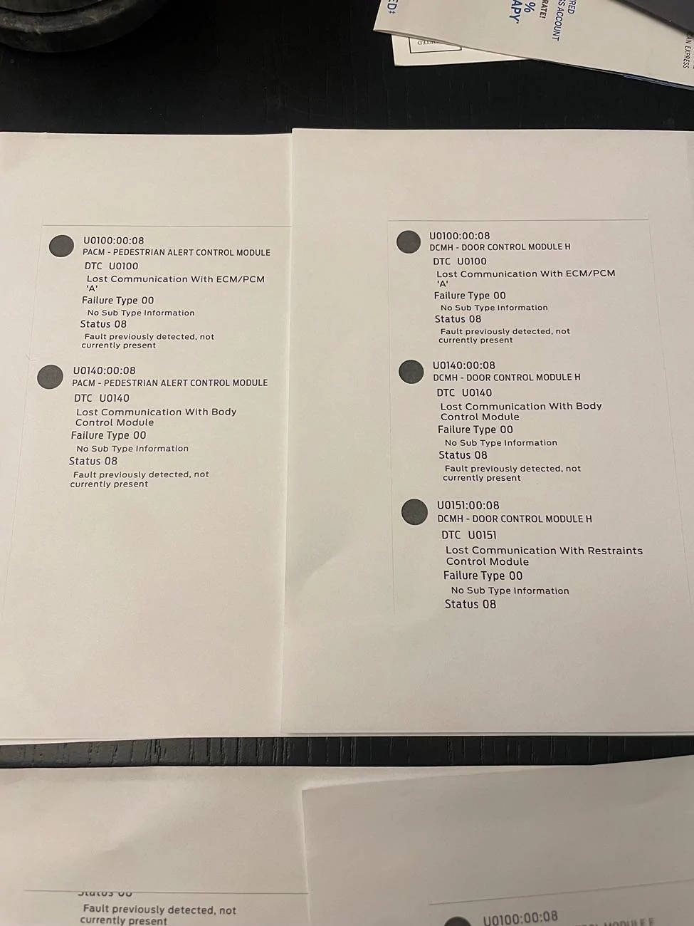

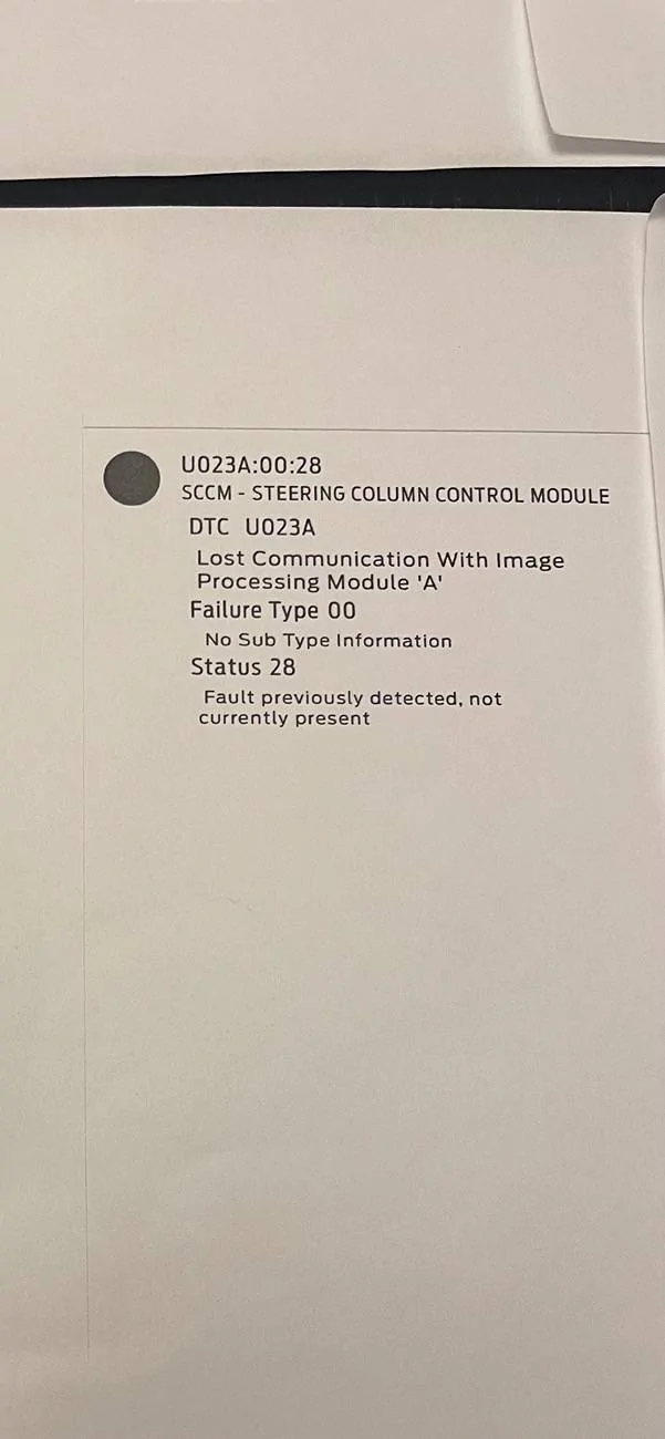

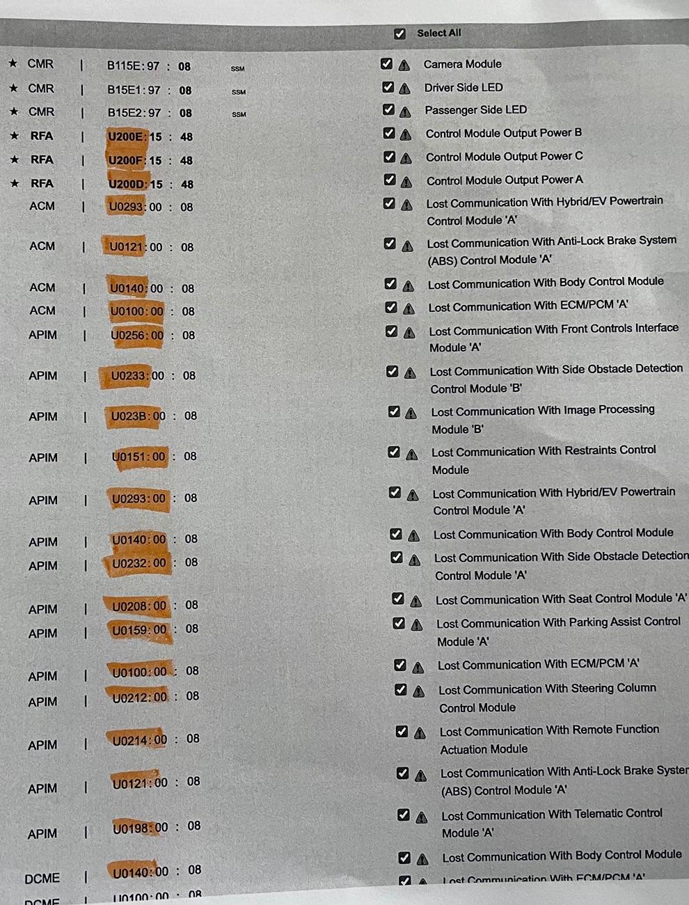

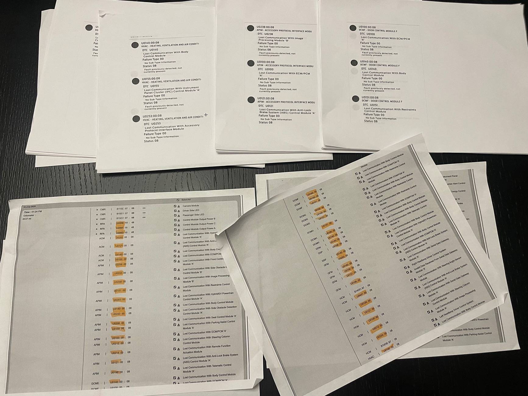

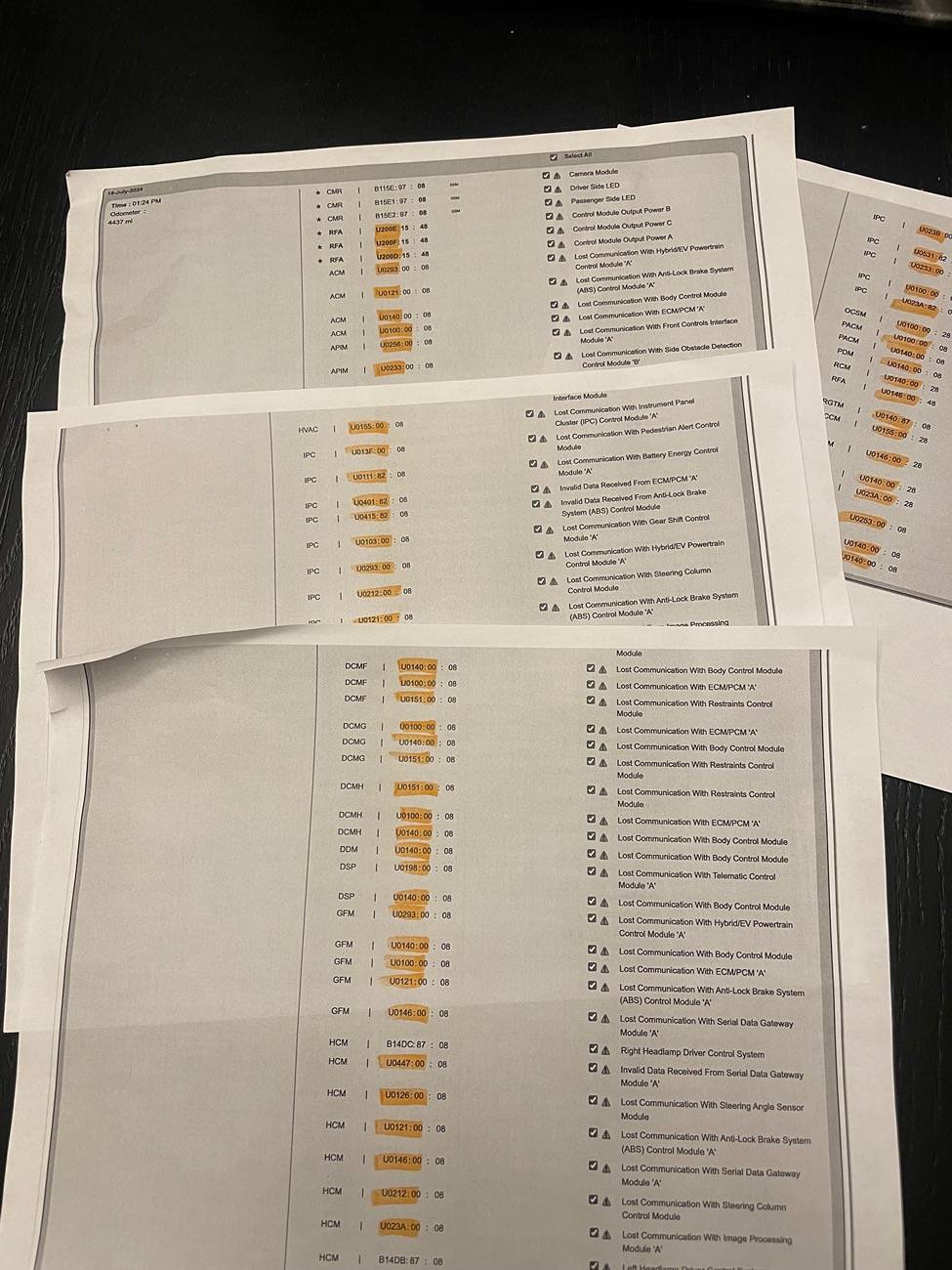

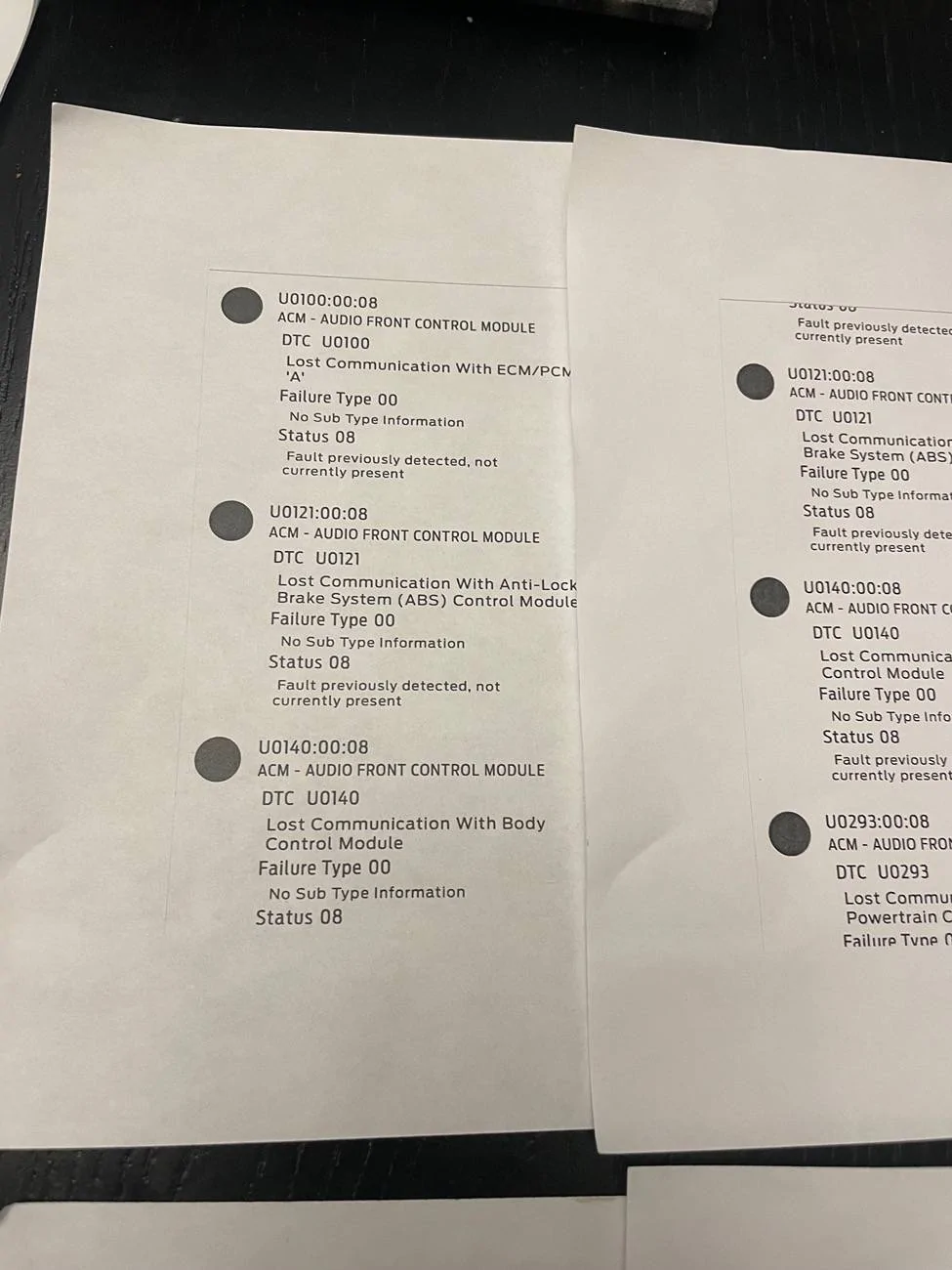

Update* took vehicle into dealership on Thursday-
I asked the technician if they would pull codes from car.
The info comes up on cell and the tech screen shot and printed out 28 pages of ODB codes and gave me 4 pages of DTC codes.
These are a few that are listed several times
U0121
U0212
U023A
This is a new car-
Vehicle is a 2023 purchased last week in March 2024
