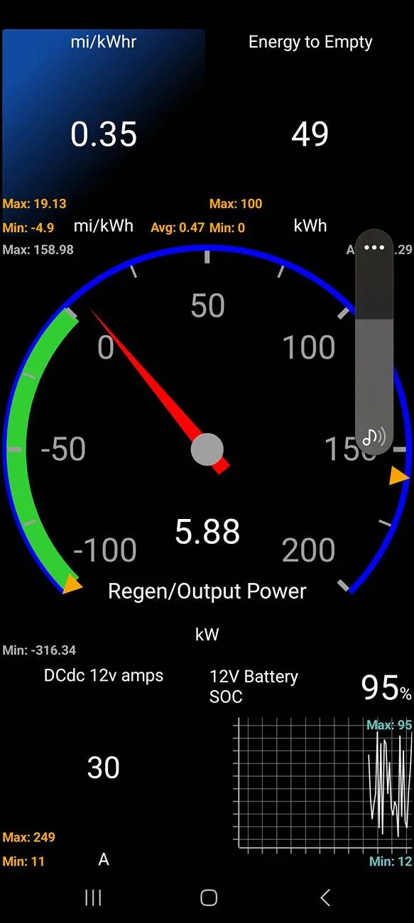

my complaint is that you cannot display a graphical custom dashboard as set up in the phone app. Also, you do not have access to "all" real-time sensor data.
I do NOT want to try and read streaming text values, I want nice big digital "gauges" I can glance at out of the corner of my eye and read without putting on my reading glasses. ;)
what I want to see on the big screen is what I can see on my phone:
Ford Mustang Mach-E Car scanner on android auto? dashboard-240516
